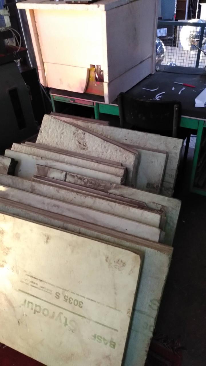

Step 5 - Make a heated chamber
Use your creativity to make a cover over the printspace. Plastic foil can already be enough to trap the warm air inside, depending on the room temperature. We also had good results with cardboard and left-over BASF Styropur, which is sturdy enough to not need a frame.
