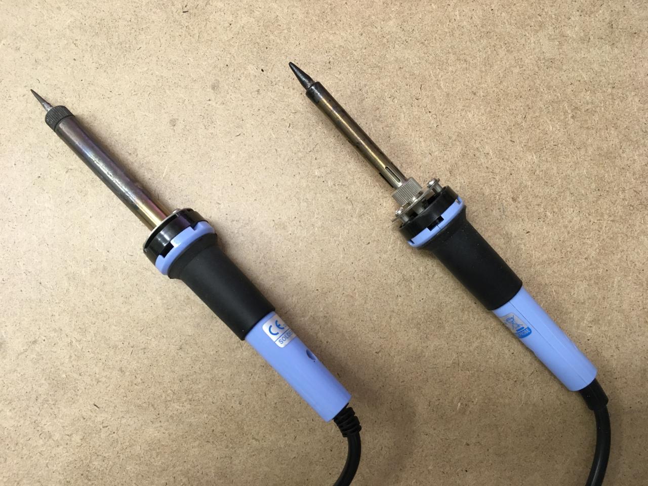

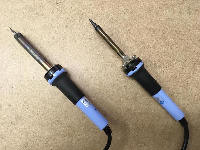

Step 1 - Choose your soldering tip

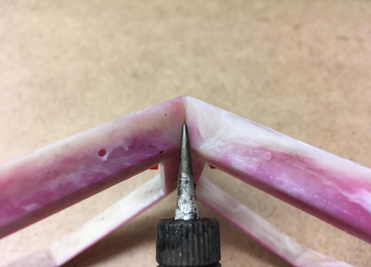

A very stable connection is created when the connection surfaces are first welded deeper and then at the edge.
For the deeper welding, a thin soldering tip is suitable and for the edge seam a larger one.

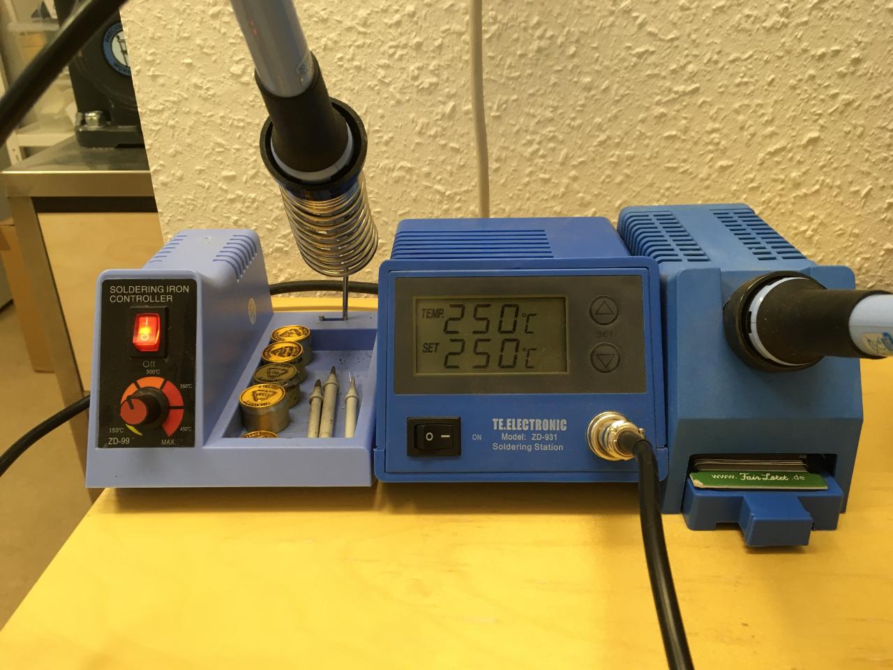

Step 2 - Choose the welding temperature
Do some temperature tests.
I use around 250 ° C for HDPE and 270 ° C for PP.

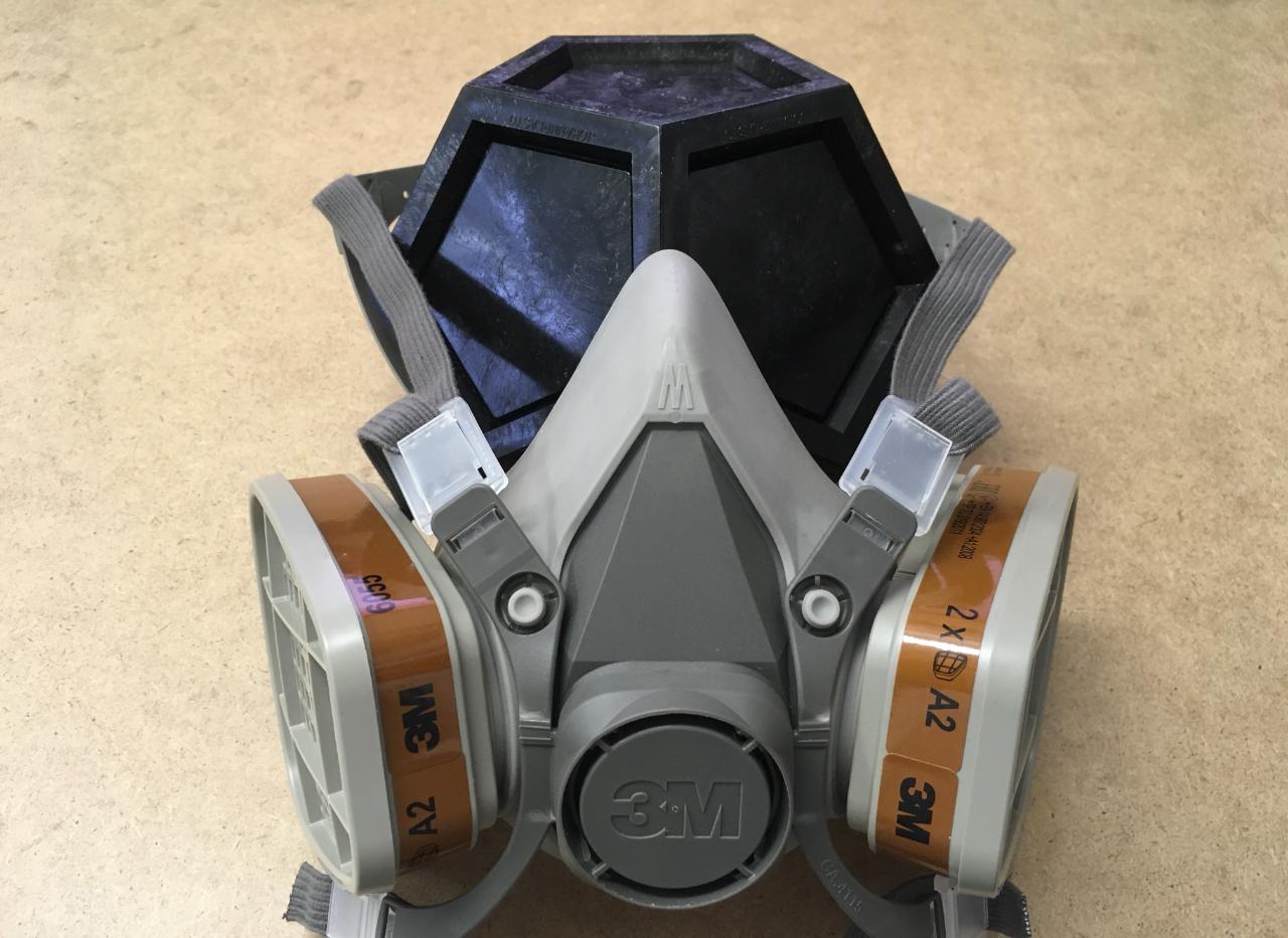

Please use a gas mask for this work!
See also: https://community.preciousplastic.com/academy/plastic/safety

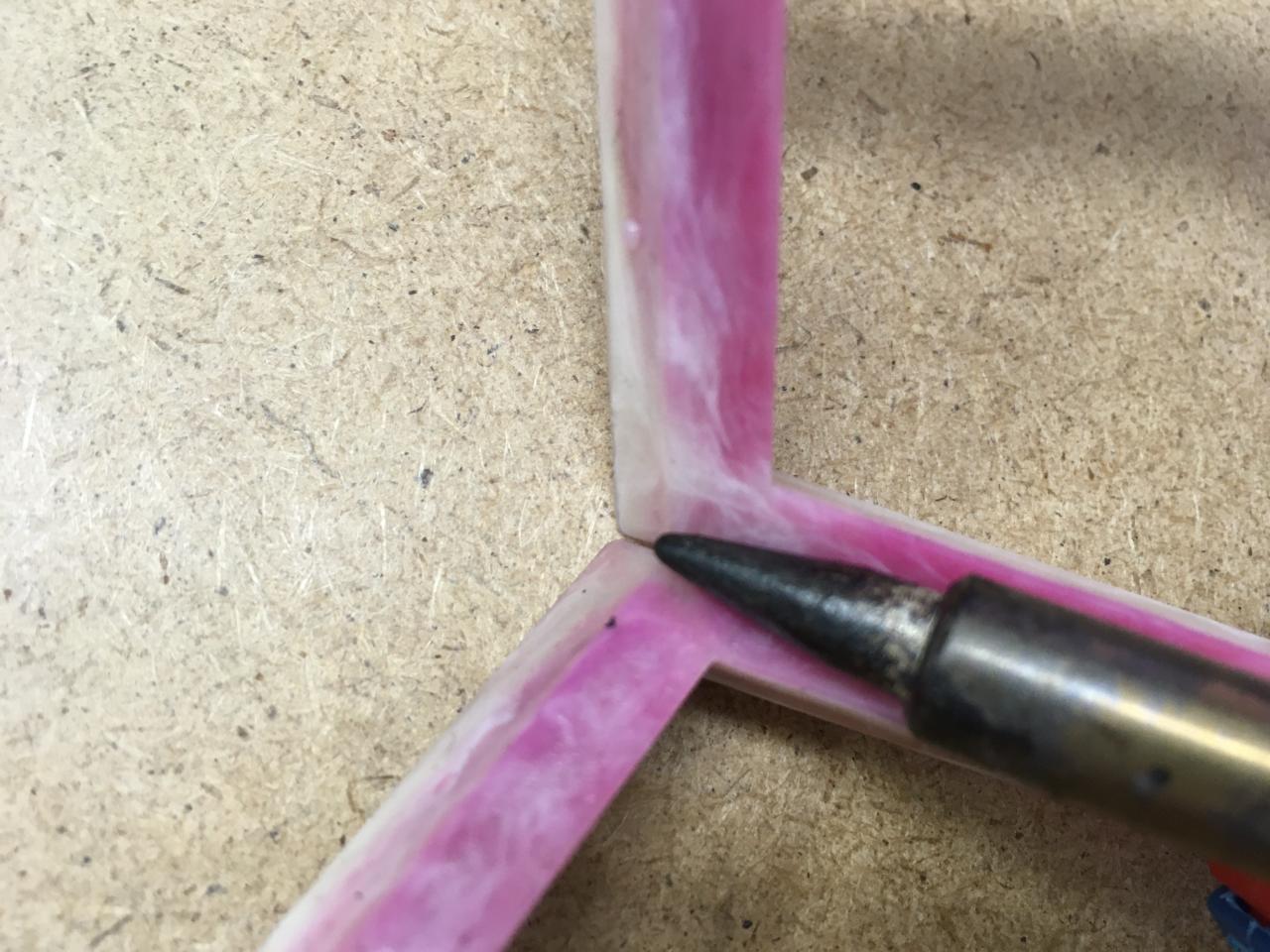

Step 3 - Weld it
Position the parts and fix / clamp them.
Weld the parts first with the thin soldering tip and then with the thick soldering tip. Not too fast!
Check the connection and change the parameters: temperature, welding depth and speed if necessary.
