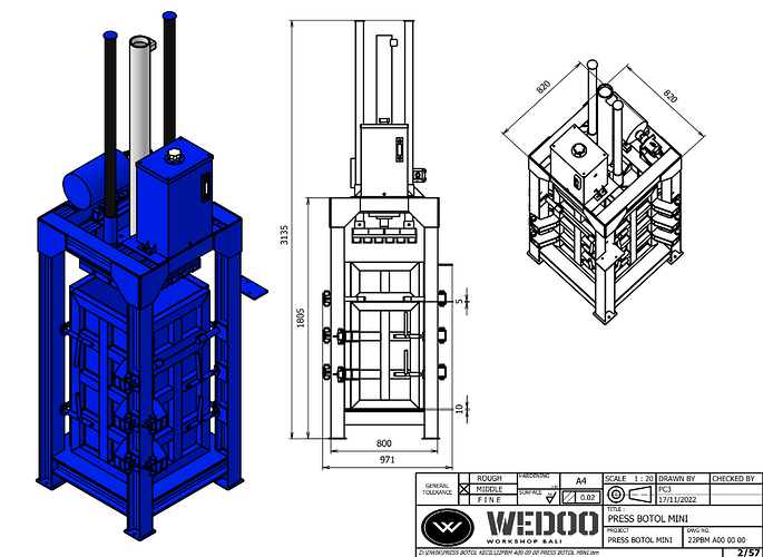

- 3D Step File: /files/cad/22PBM A00 00 00 PRESS BOTOL MINI.stp - Preview
Step 1 - Download
First off, here is your download package for this machine!
In this folder you will find:
3D CAD (.step and .igs)
Lasercut files (.dxf)
Blueprints (.pdf)
Schematics
BOM
For Autodesk inventor users, we provided:
.iam = (assembly)
.Idw (construction drawings)
.Ipt (parts)
We also provide some in-depth pictures and videos in this link

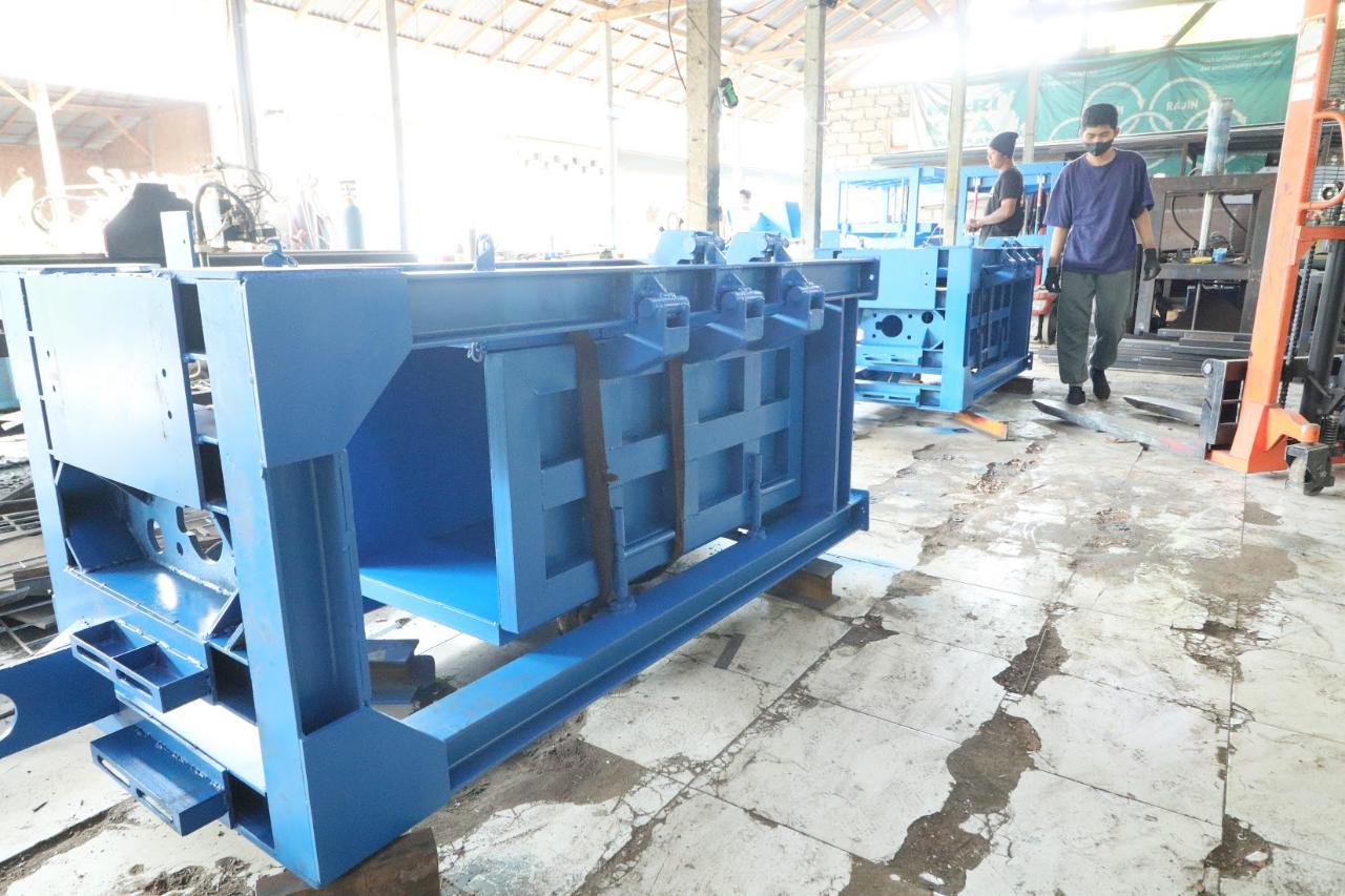

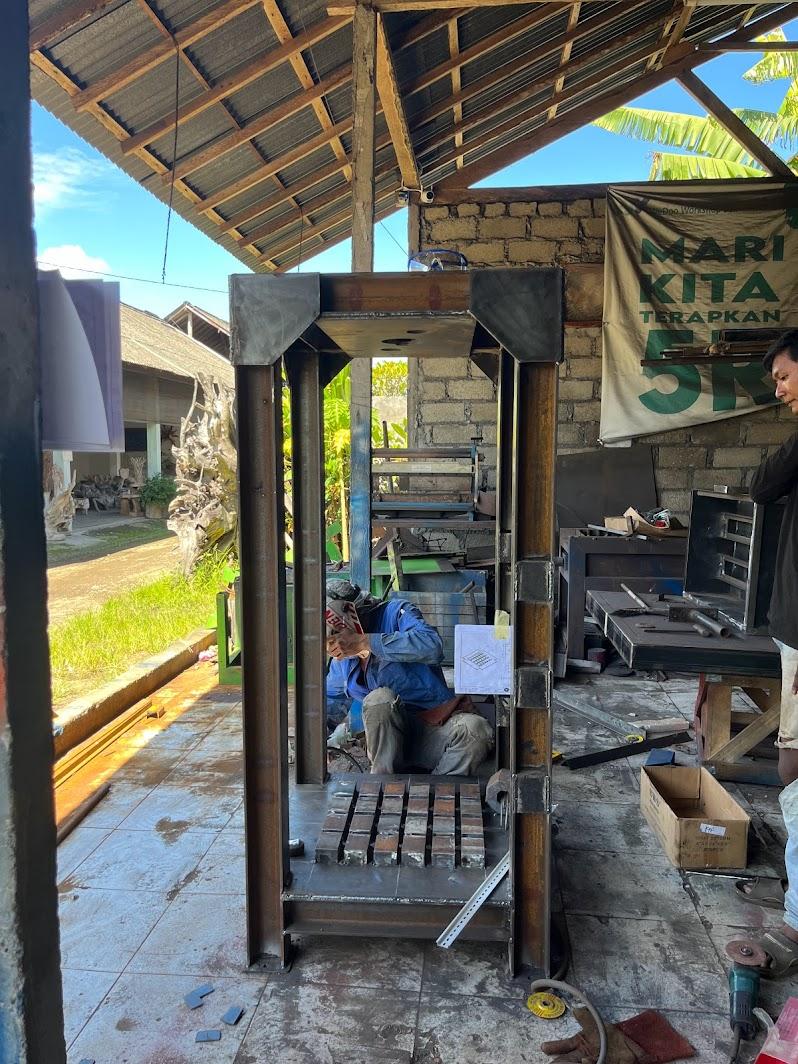

Step 4 - Build the main frame
Cut and build the main frame according to the design
for the base of the baler, you will need to build a 'platform' grid for the twine/string to go through
this requires precision in welding to create both the individual 'grid' and to place it precisely on the bottom of the frame.

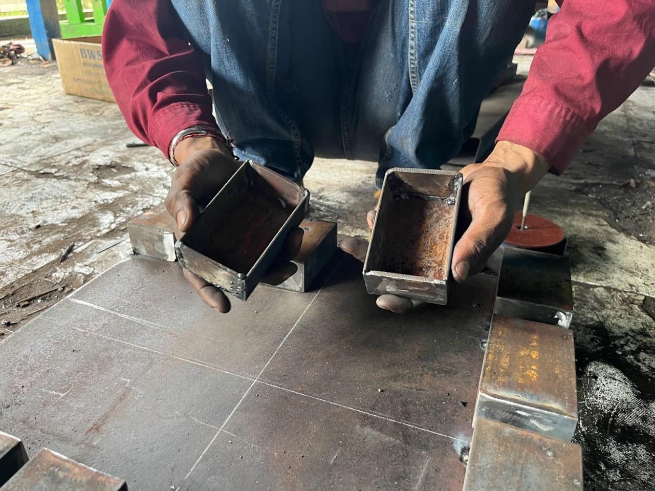

Step 5 - Make the hinge
Hinge are consisted of two parts, the one that are fixed to the door and the one that are fixed to the frame.
you can cut all the parts with the plasma cutter and weld the assembly together.
once hinges and locks are made, we recommend to attach the hinges on the main frame first (check step 7)

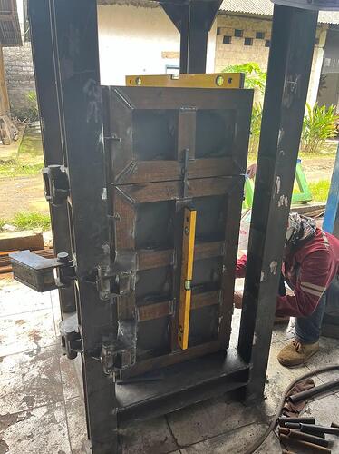

Step 6 - Build the door
All four sides of the door have different placement of hinge and lock so make sure you follow the design properly.
We designed the front door with a fold down feature for more ergonomic access to load materials into the machine
If you are unsure about your ability to weld things precisely, we recommend you to not attach the hinge to the door before making sure all your components are aligned (see step 7)
Step 7 - IMPORTANT: Hinge and Door alignment
To make sure that your door are aligned properly, only weld your hinge to the door after you position the door in the right place. Following the hinge on the frame as a guide to make sure it moves smoothly
You can weld a temporary ‘staple’ like in the picture as a support or scaffold to aid the hinge alignment
weld the hinges to the door according to alignment with the frame then remove the temporary welded 'scaffold'
Make sure to remove excess materials from the welding process .When it is aligned properly, all the hinges and the locks should run smoothly. You should be able to open and close all the 4 doors smoothly

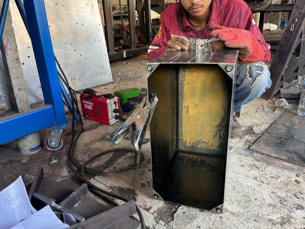

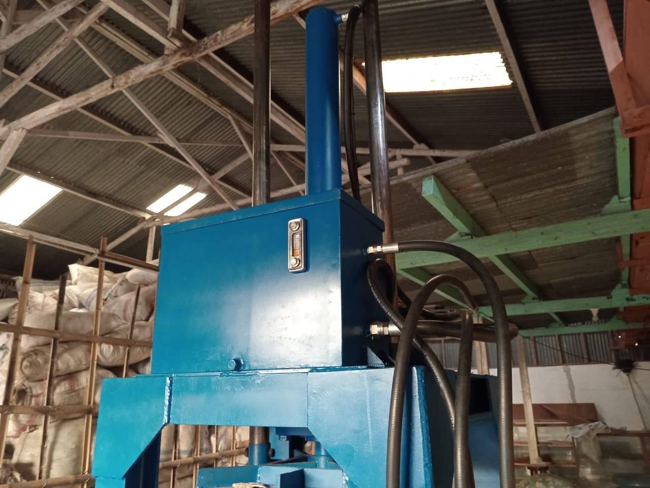

Step 8 - Build oil tank and case for the motor
Make sure there are no leaks in the seams
attach it to the top part of the baler according to the 3D drawing.
Step 9 - Assemble the hydraulic
This needs a few people to do as the hydraulics are very heavy two strong persons needs to be at top as a receiver, two other lifting the hydraulic and one securing it from underneath.
lift the hydraulic up and secure it in position

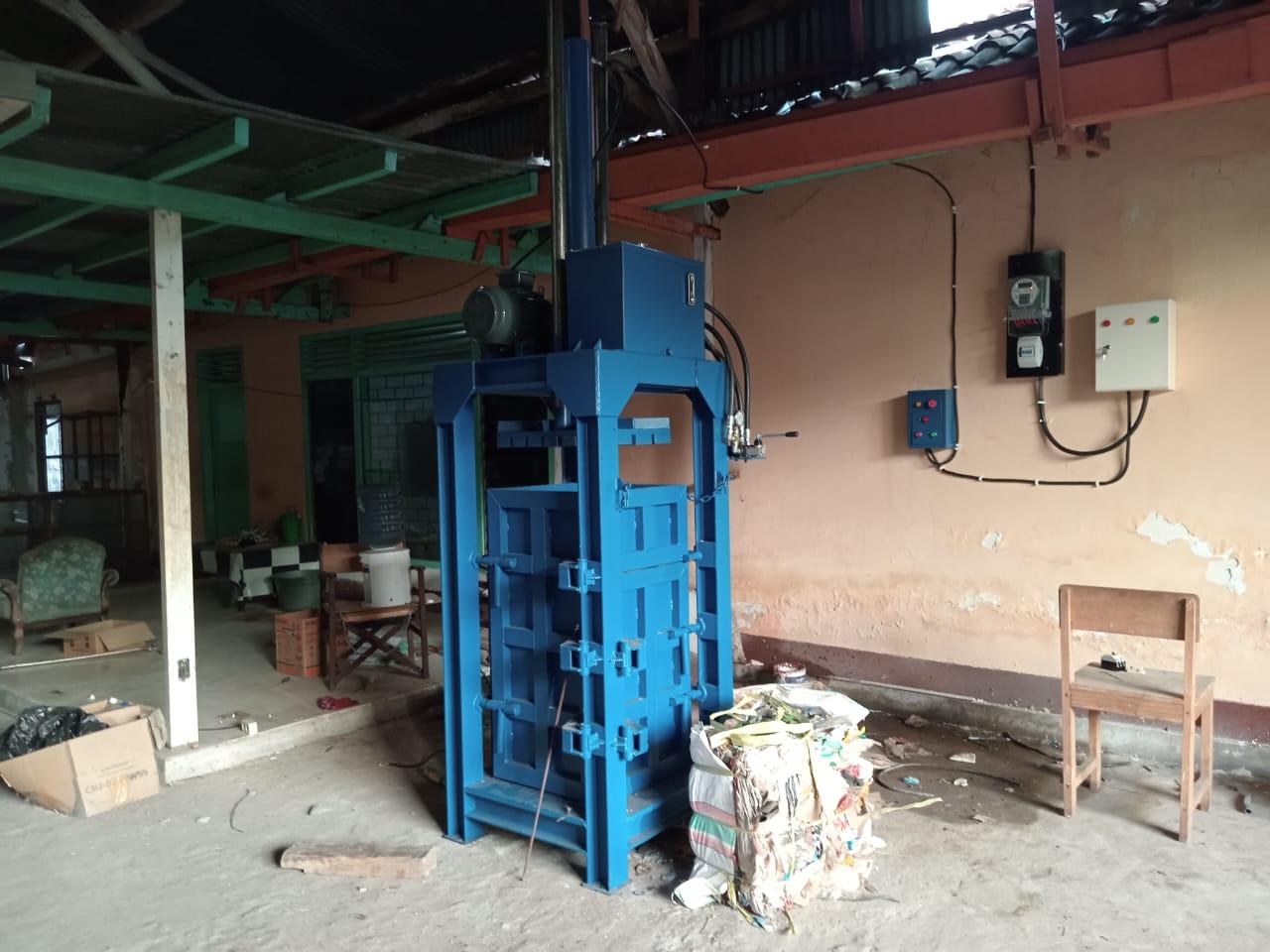

Step 12 - Time to press!
We recommend placing your machine on a leveled floor and it's even better if you can screw the machine to the floor too for more stability.
Line the thread/rope you are using to bale
load material you want to press to the chamber the door
Lock the door
Turn on the power
Lower Handle valve until pressure gauge gets to 100 bar (max hydraulic capacity
Release
7.Add more plastic until you achieve your desired dimension and repeat the process
