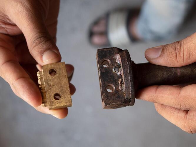

Step 2 - Make your stamp
Make a design for your stamp and mill it in metal. We made ours from brass, but I guess other metals would work as well. Tip: make sure to mirror your design
Step 3 - Press
For pressing we like to use arbor press. It works fast and are easy to use/find. Put the product underneath apply some fore and take it out. You can get really fast here
Step 4 - Use mould for alignment
We like it when things are consistent. So we use a little mould to put in our product to make sure we always stamp in the same place. This actually also makes sure the product doesn’t move when applying force. Not a must, but would highly recommend

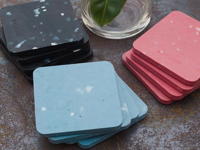

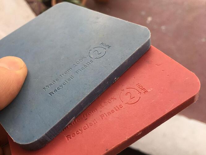

Step 5 - Ready!
Here you can see a few products we stamped. We made one stamp for our logo and one for the type of plastic.
