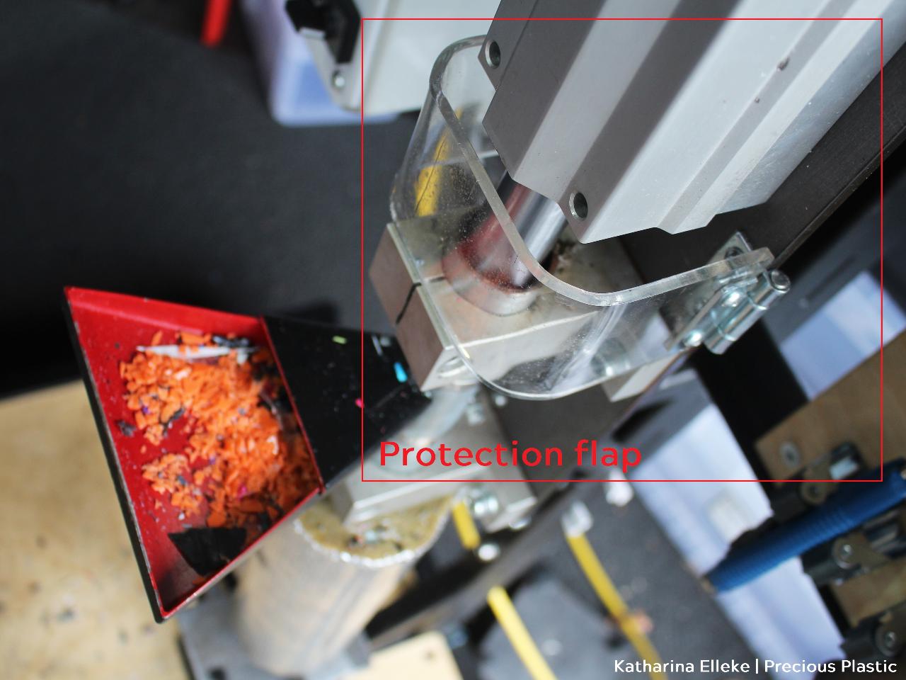

All the machines you use in public have to be safe against gross negligence. For a better performance, make sure that everything is clean, working properly and maybe you have some spare parts with you.

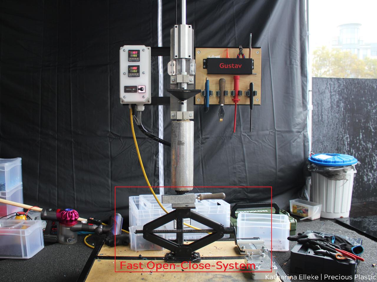

Step 2 - Prepare your moulds
Like the machines you use in public your moulds have to be reliable as well. We recommend moulds with a small cycle time, so as many people as possible can produce a product…
That means:
  • Quick release-System to open and close your mould fast
  • Small injection volume
  • The product is easy to demould

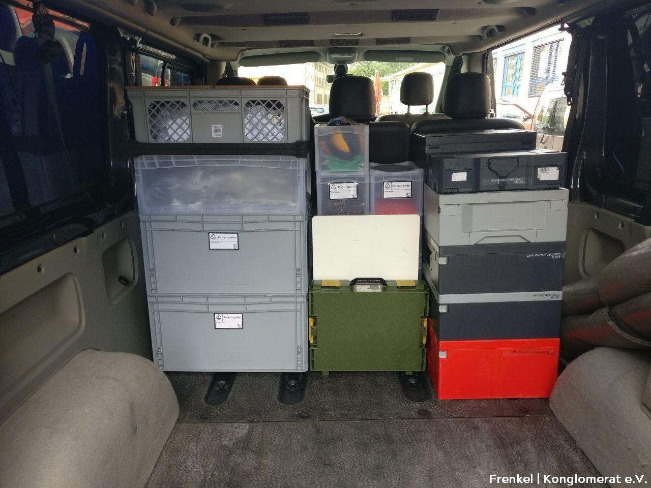

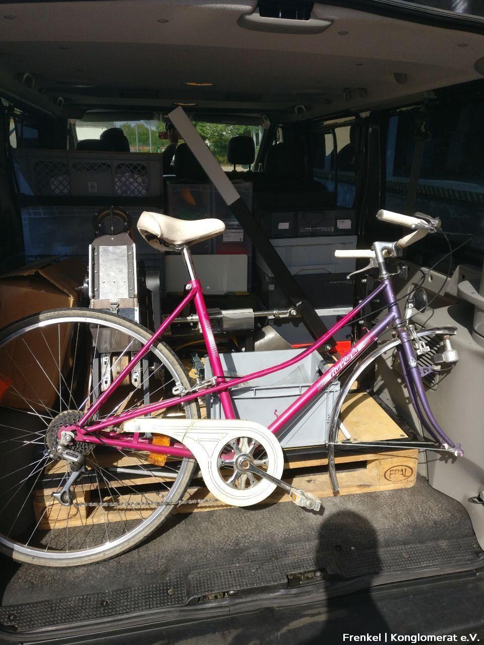

You are leaving your workshop, so you need everything to run a plastic recycling workshop mobile.
As everyone has their own way of doing it, you get a list from Kunststoffschmiede (Germany) for your inspiration:

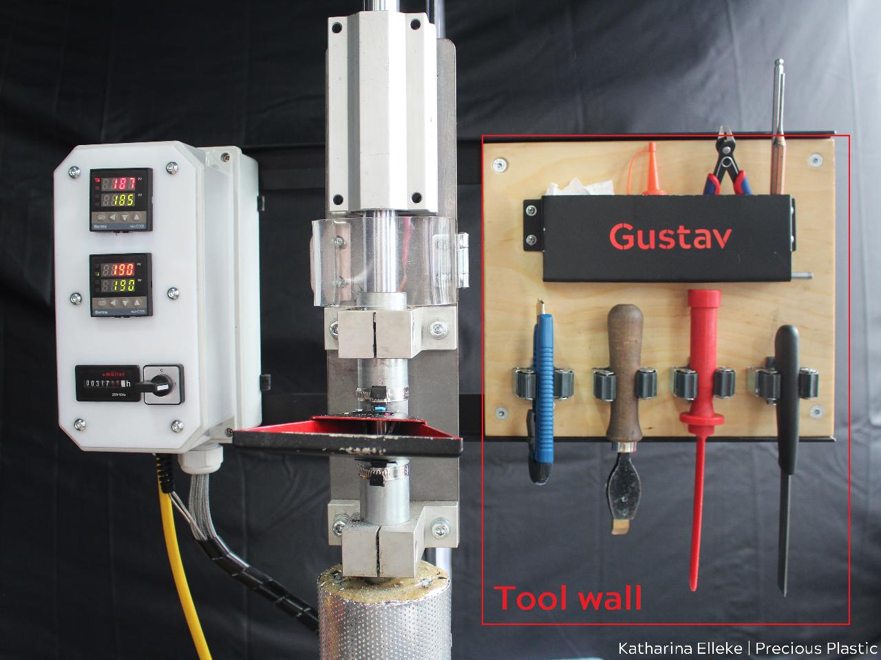

  • Injection machine and the bicycle shredder
  • Tools for maintenance
  • Productcounter

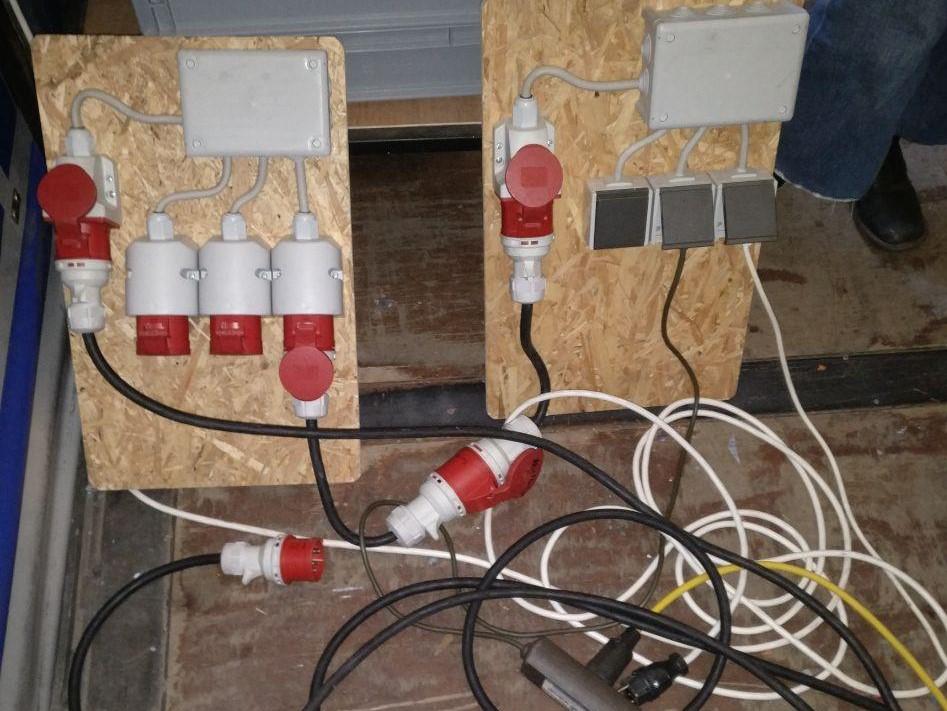

  • Electric box (including: Power cable, distributer and some lights)
  • Moulds

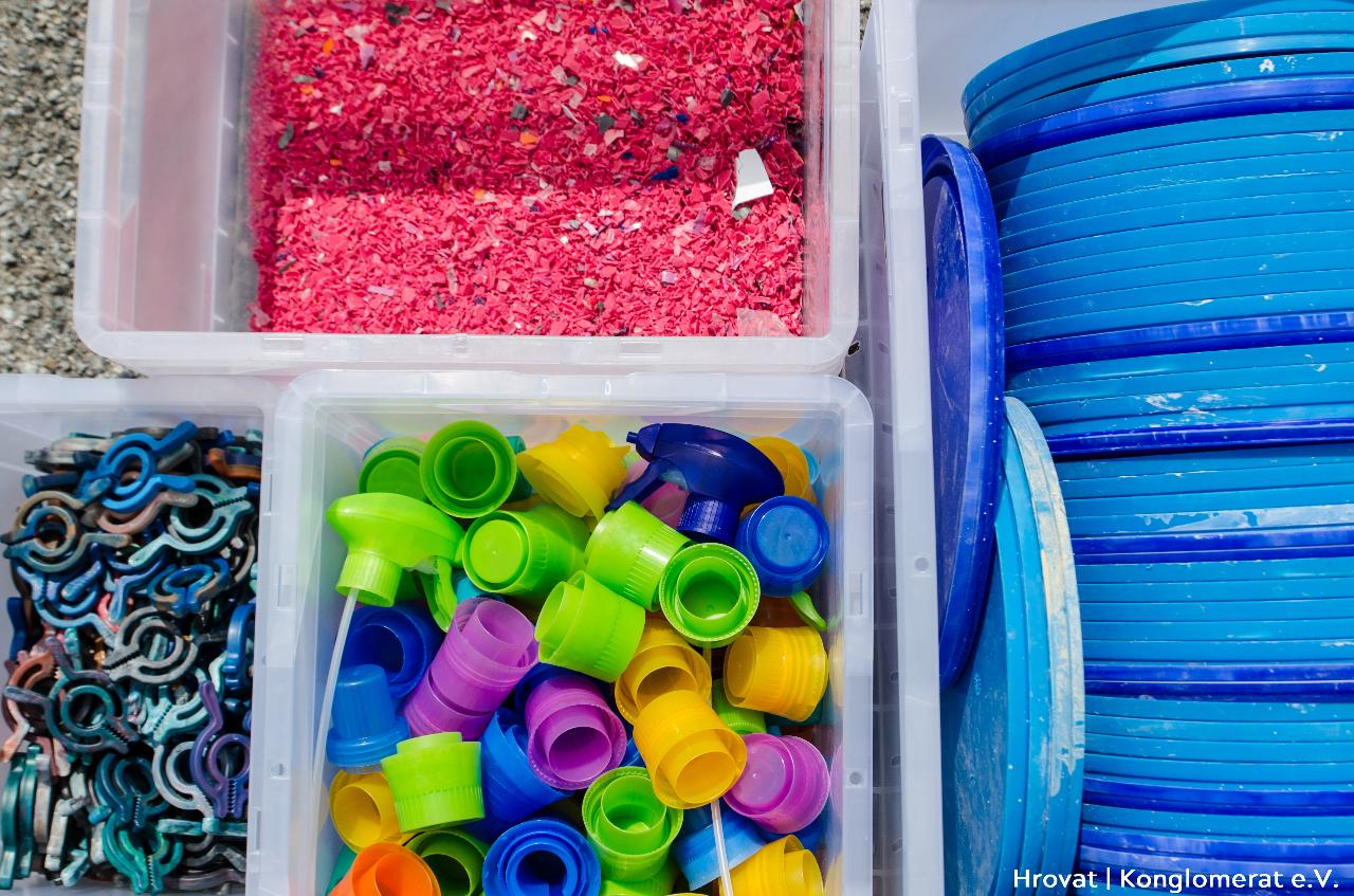

  • Shredded plastic
  • Clean and unshredded plastic
  • Samples from us and the community to show the possibilities
  • Informations like flyers and posters
  • First Aid Kit
  • Camera
  • strap, tape and ropes
  • Tub and cleaning stuff to wash the plastic

For your workshop you need shredded plastic and some clean plastic which is ready to be shredded. Reserves are always good, maybe the shredder stops working and you are running out of fresh granules… Be prepared!

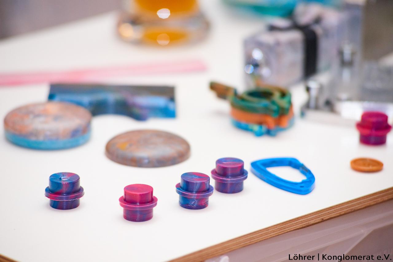

Step 5 - Prepare samples
It’s always good to have a variety of material and product samples to inspire people and help them understand the possibilities of plastic recycling.
You can use your own products, or get some more from the Precious Plastic Bazar to show what other workspaces around the world are doing. Present the products in a beautiful setting.

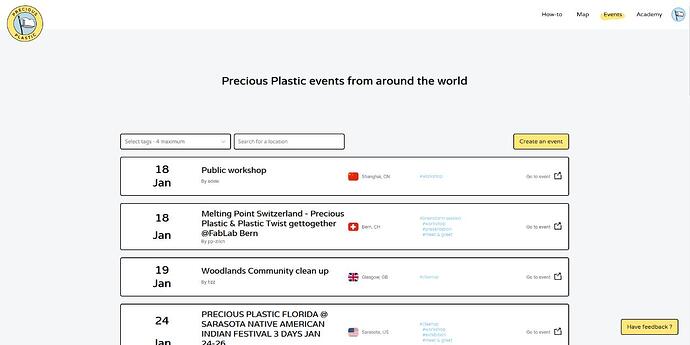

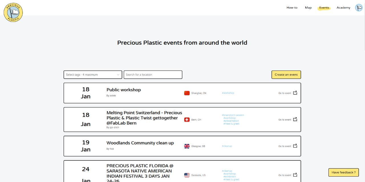

  • create an event on the community platform
Precious Plastic

  • Power source: Is it strong enough, and how far is the plug?

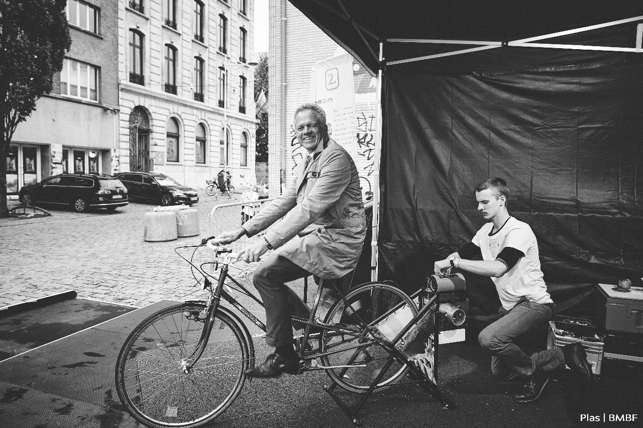

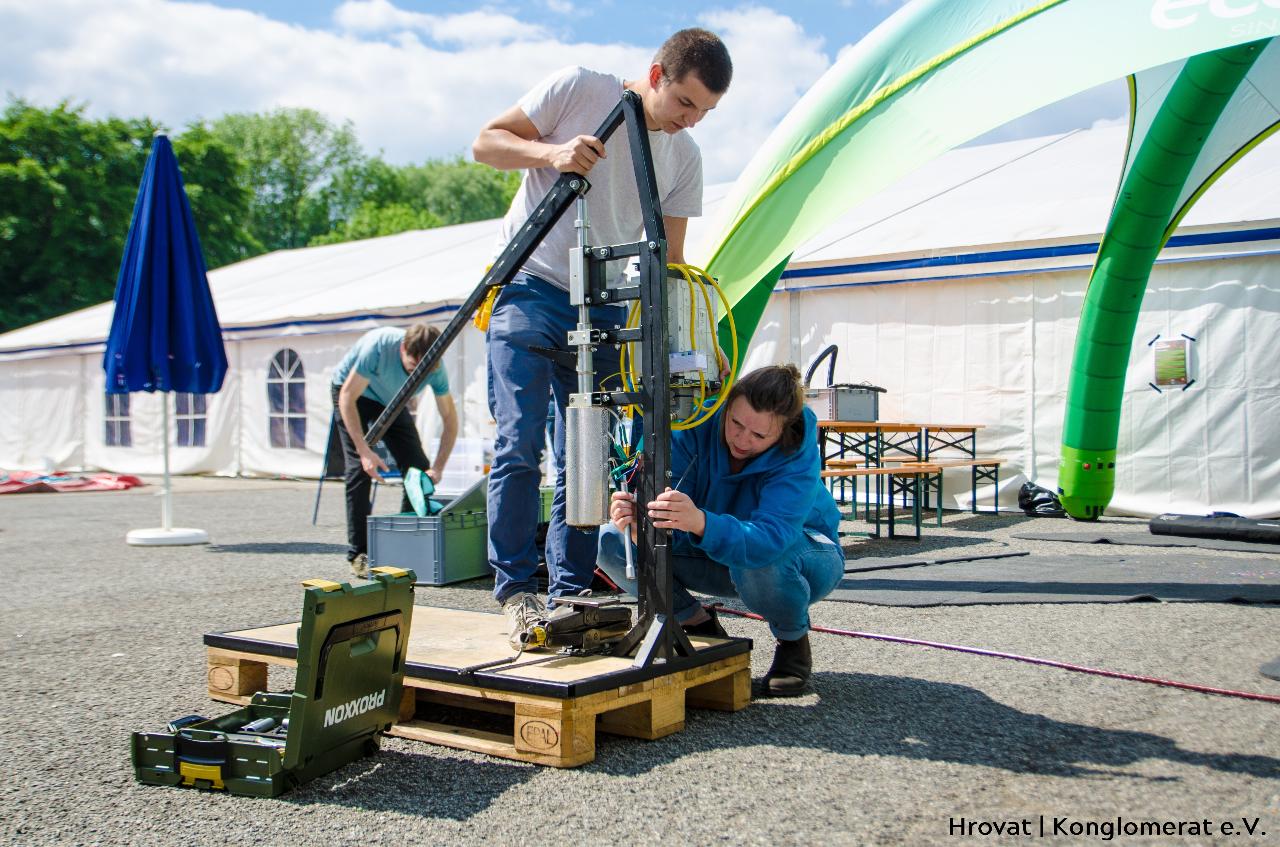

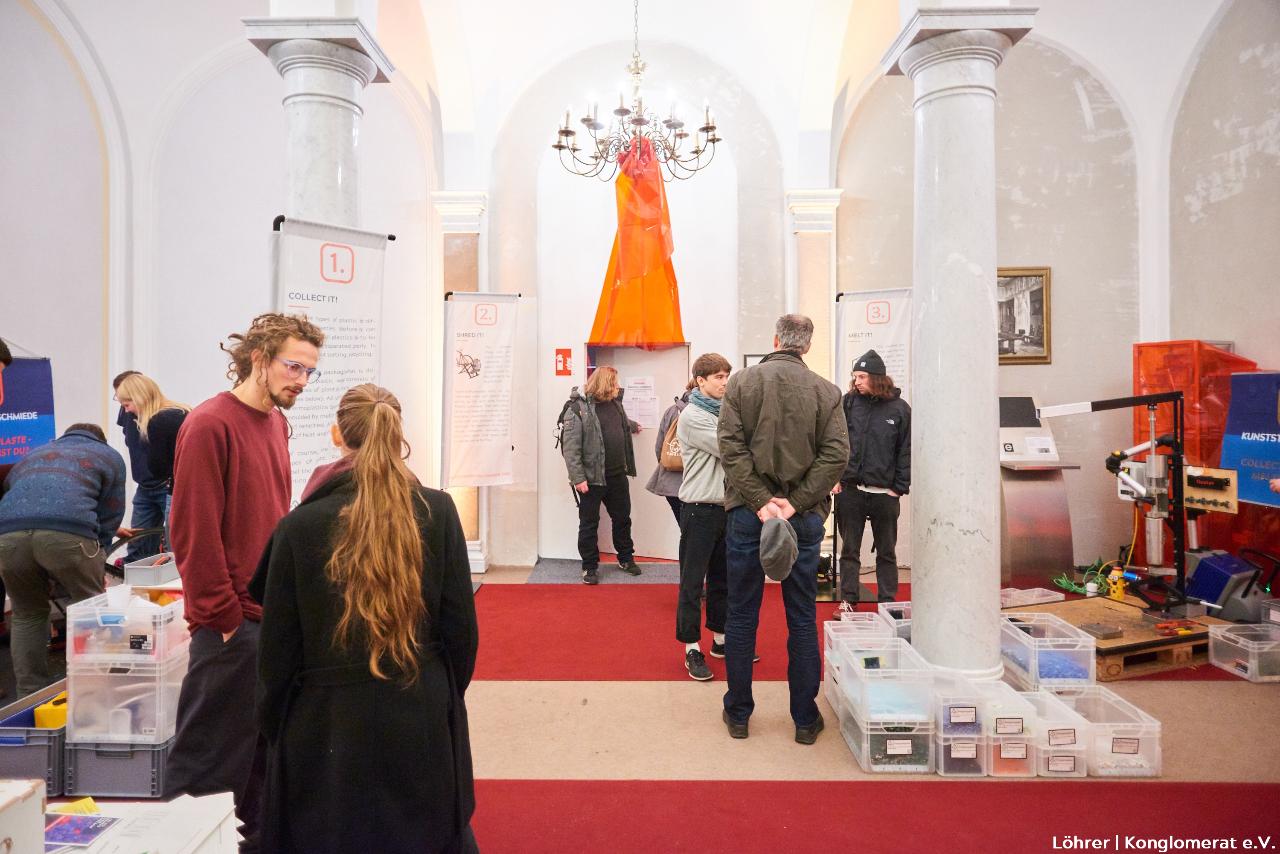

Step 12 - Construction on site

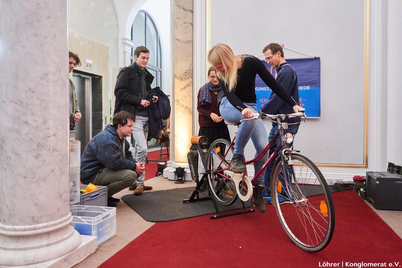

Label all the stations and create enough space around the machines so many people can see what’s happening. Compare your setup with the course of the recycling process and check if it’s similar.
Build up your mobile workshop with enough time and take a break before everything starts.

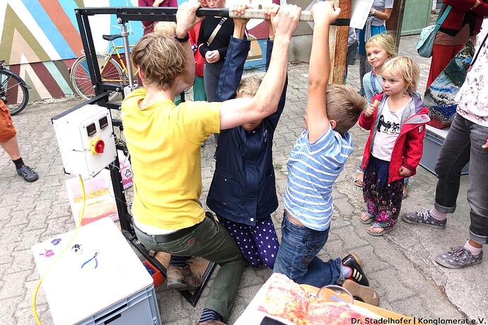

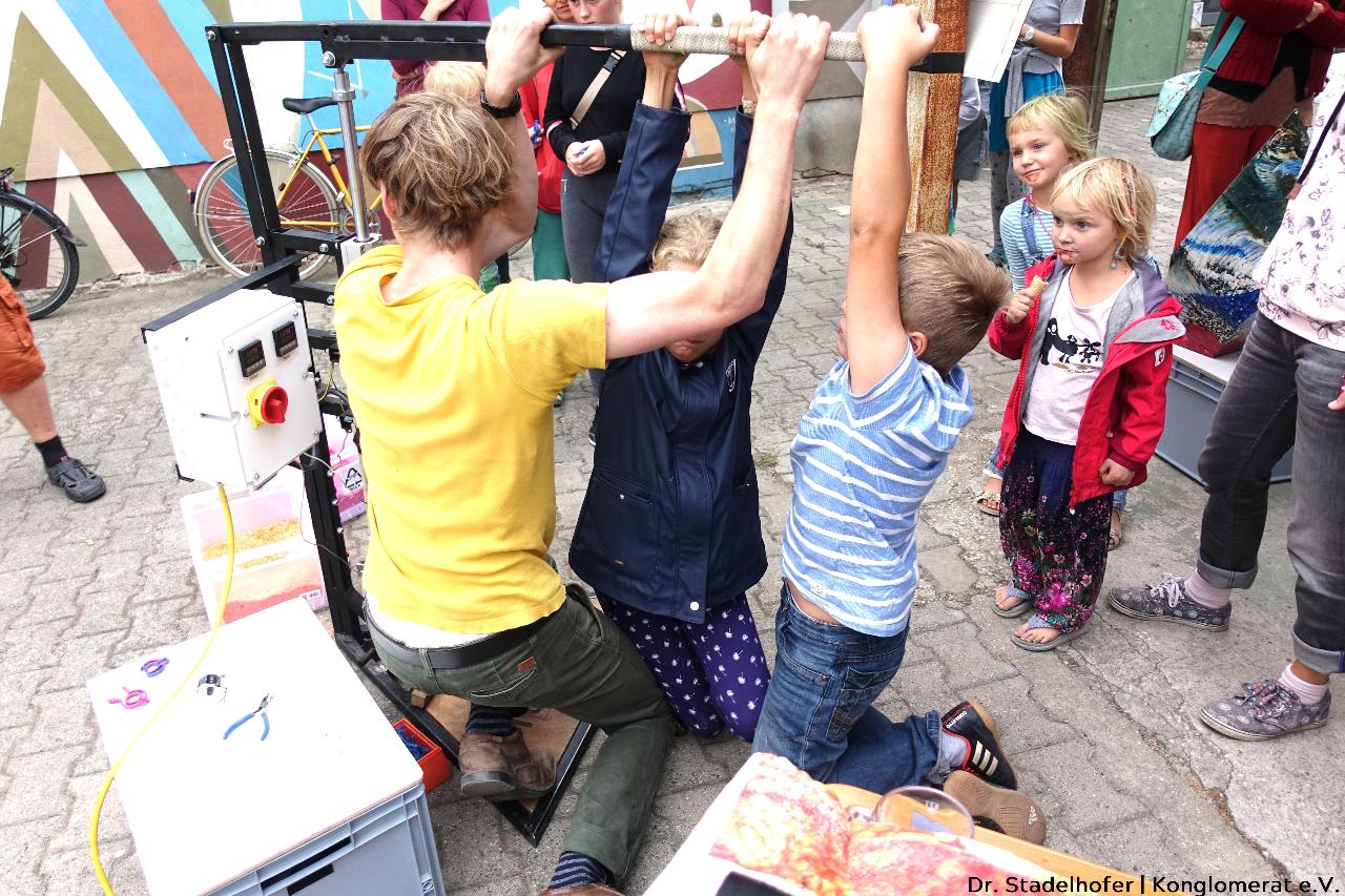

Step 14 - Participation

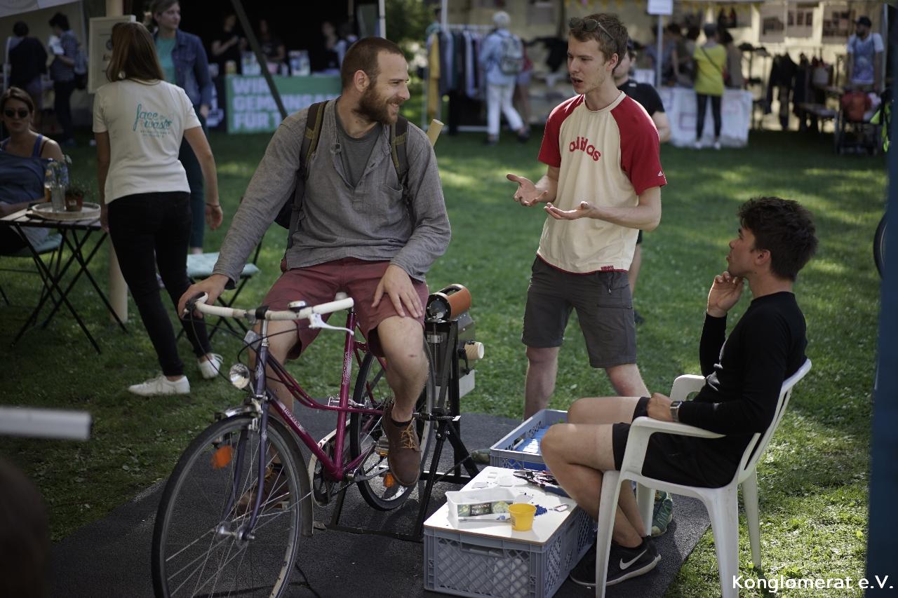

Think carefully about how to get strangers involved in the process. What can they do without endangering themselves or the machines?
