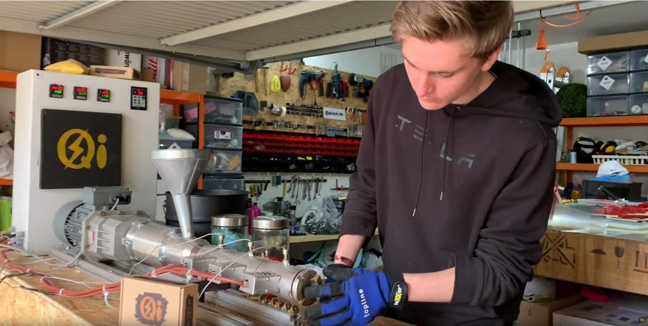

Step 1 - Extrude hot munition

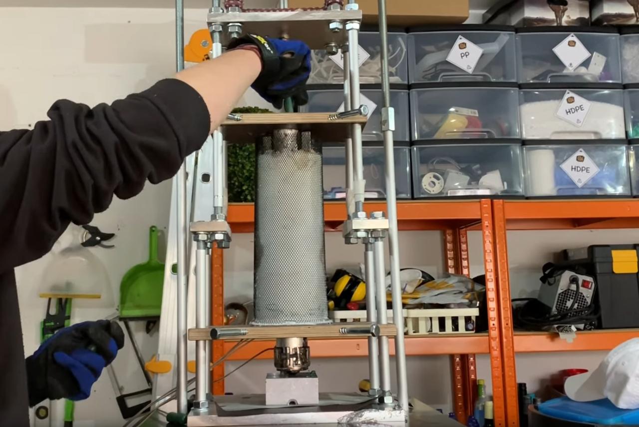

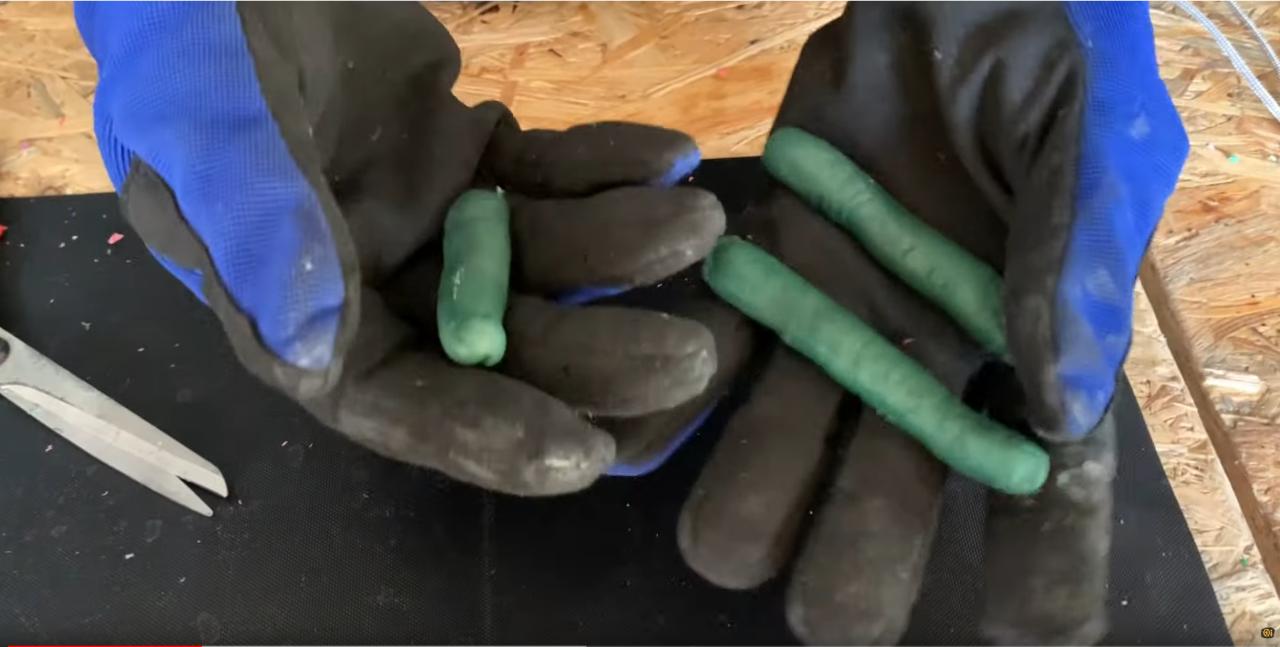

Instead of filling up the injection machine with flakes, use your extruder to produce hot munition. Remove the nozzle, in order to extrude thick stripes. Instantly take them and fill your injection barrel with them.
In the extruder, the plastic is mixed well and heated properly, so it is instantly processable with the injection machine.

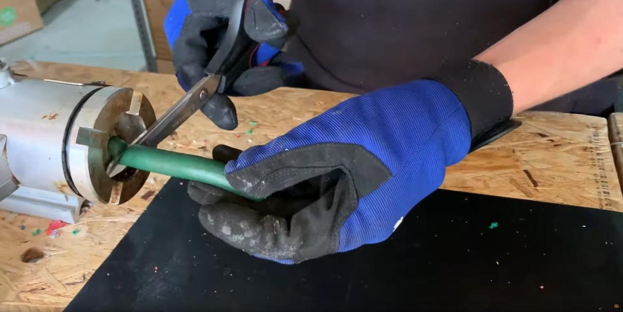

Take the hot stripes and insert them into the barrel of the injection machine. Try to extrude them a bit thinner than the diameter of your barrel. If they are too thick it will be a pain to load the machine. If they are to thin the barrel won't be loaded to its full extent.

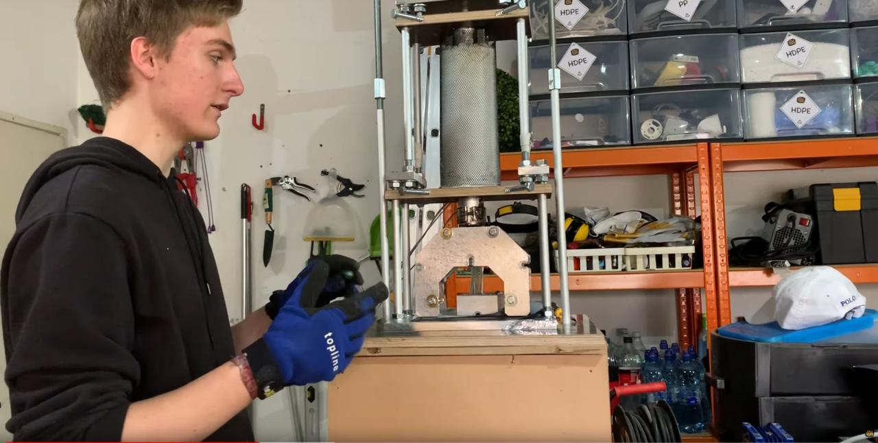

Now place the mold under your injection machine and inject the melted plastic. In this case, we are using the professional mold for face shields from Plastic Preneur (a cool company from Austria). In order to achieve maximum efficiency, we have one person reload the injection machine, while the other person opens & closes the mold. This way, we achieve a cycle of about 2 minutes per part.
