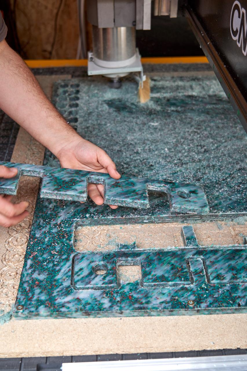

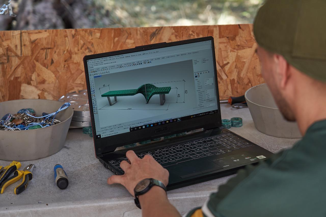

We usually use CAD and 3D modeling software to design the products and define cutting lines to take it to CNC machine.
Solidworks, Rhinoceros for 3D modeling and Autocad and Illustrator as CAD software to define cutting lines on 2D.

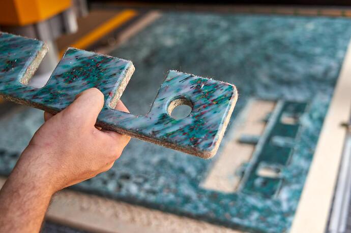

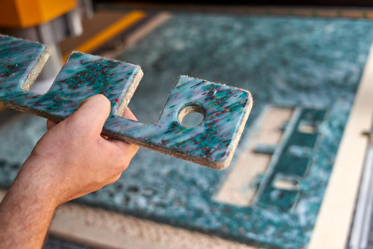

Having a predefined design, we take the material to be machined on CNC cutting machine.
• Tips •
Always be careful to make the most of the material you spend, always try to manage the cutting space to avoid wasting the boards.
Plastic boards are a little softer than wood in general, so you could cut in one stroke using the same drill you would use to cut wood. This optimises production time and gives a cleaner finish to plastic parts. Remember always make a test at first.
You can save the shaving after cut to use it again as raw material on sheetpress or extrusion machine.

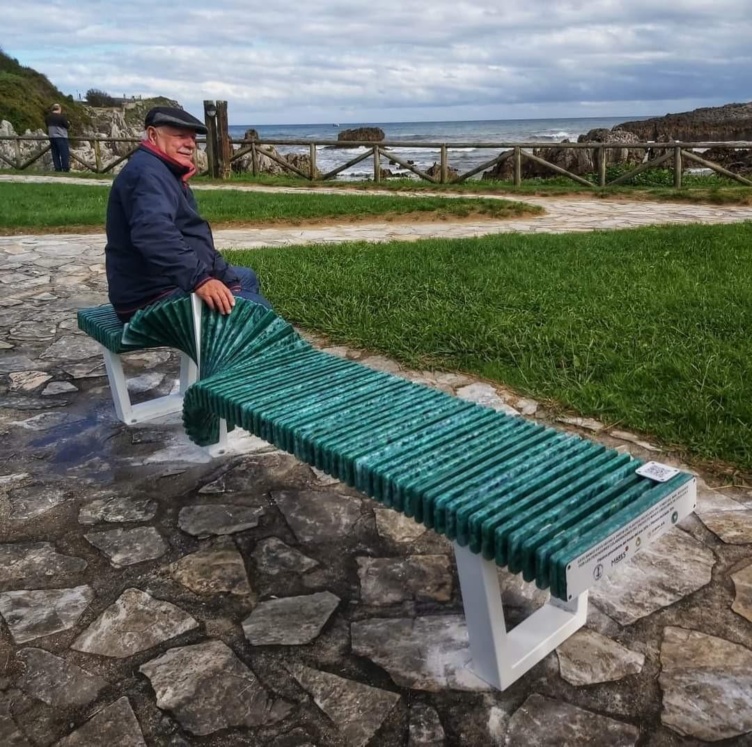

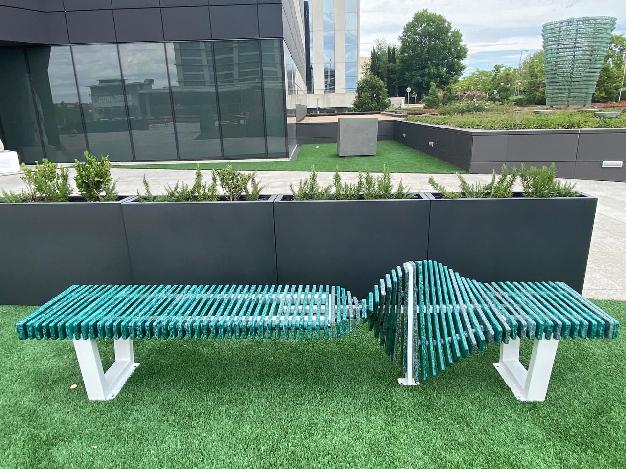

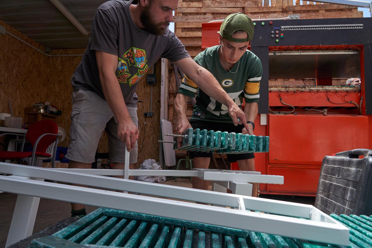

Step 3 - Manufacturing and assembly of Urban bench.

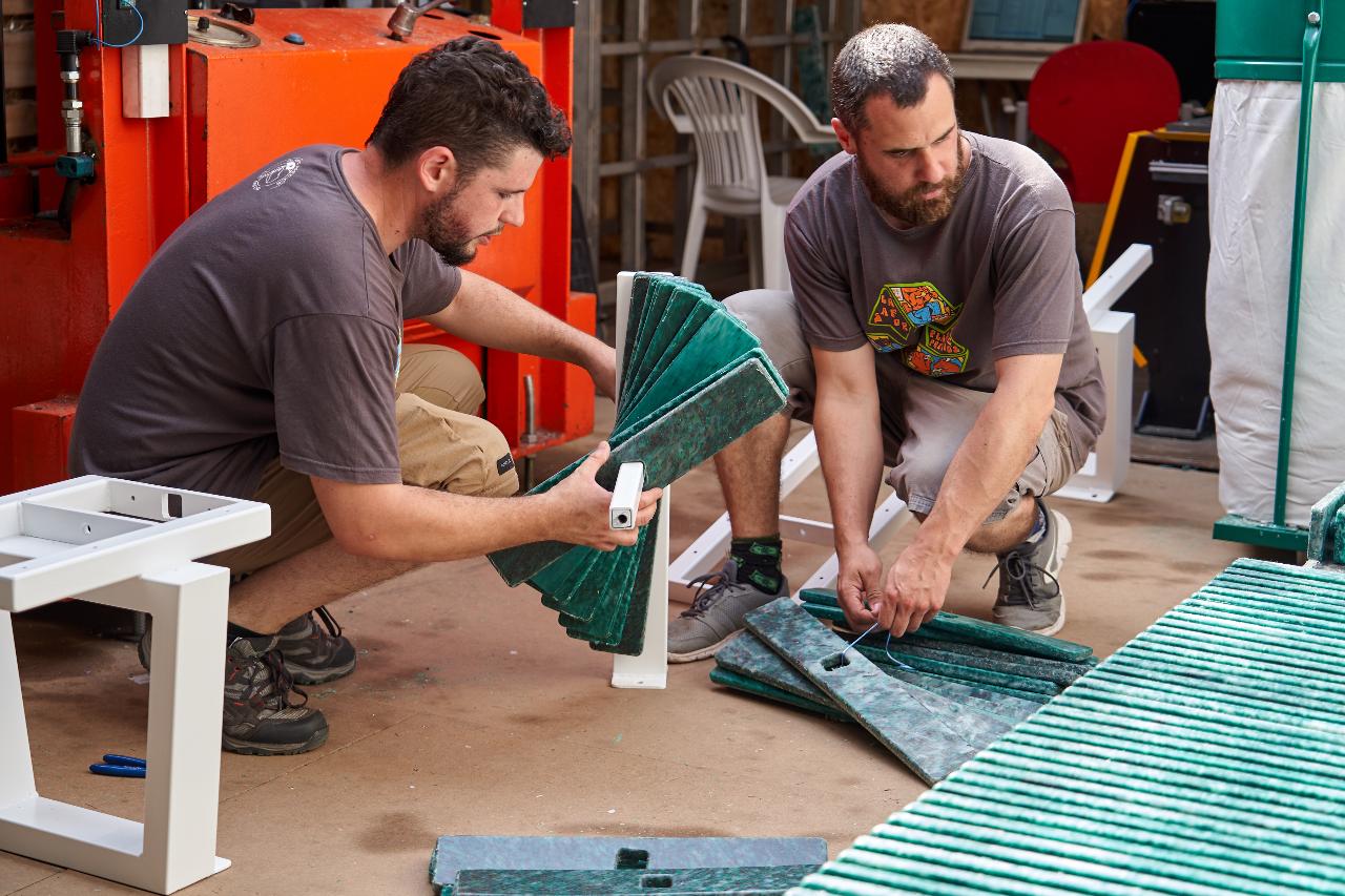

Once we have the cut parts we continue with assembly of the bench and its structure.
In this case, as it is urban furniture, we have designed a metal structure that allows to complement the object and give it stability and durability.
• Tips •
For the connection of the plastic elements and the metal structure you can use galvanized or stainless steel screws and nuts. Stainless steel are a little expensive than galvanized ones, but are more resistant to oxidation.
To screw plastic parts we always recommend to do a drill with the size of the screw you want to install, this prevents the plastic from breaking or deforming when screwing with much pressure.

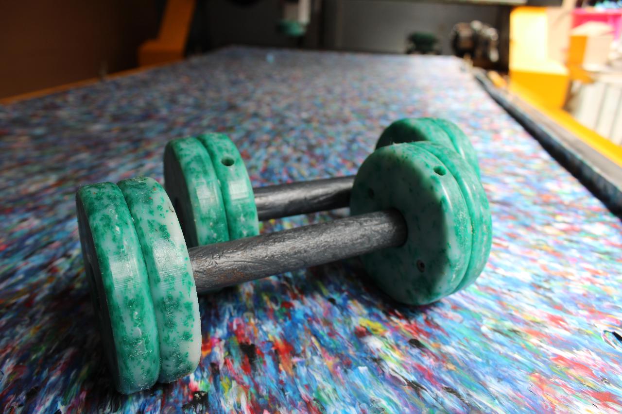

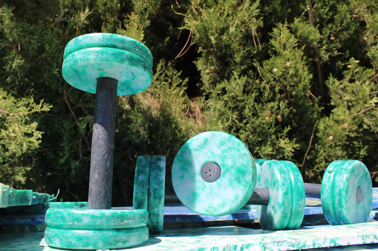

Step 4 - Manufacturing of Dumbbells.
To make dumbbells weights (round pieces) we use the same marine litter boards than bench in previous steps and we also cut them on CNC machine.

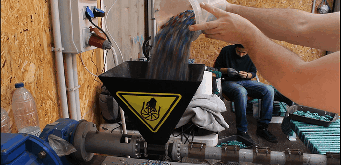

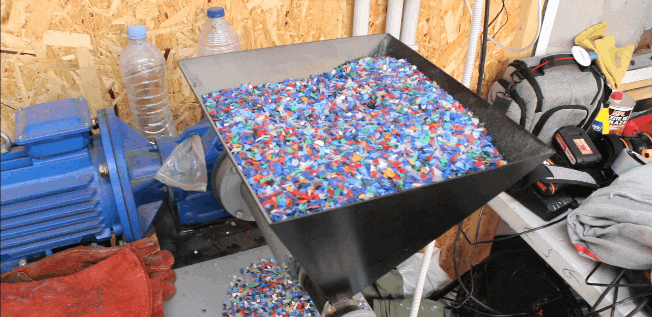

For manufacturing handless of dumbbells we use a colorful mix recycled plastic from bottles caps.

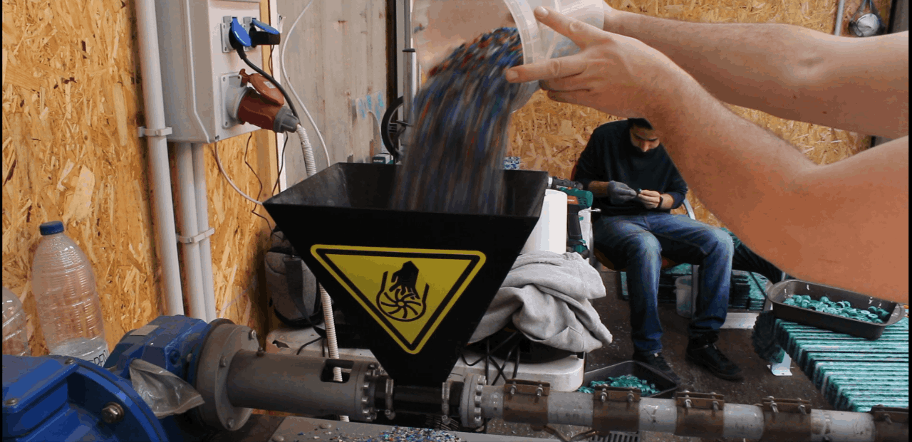

We use an extrusion machine to make plastic rods 3 meters long and diferent shapes and thicknesses, rounded or square.

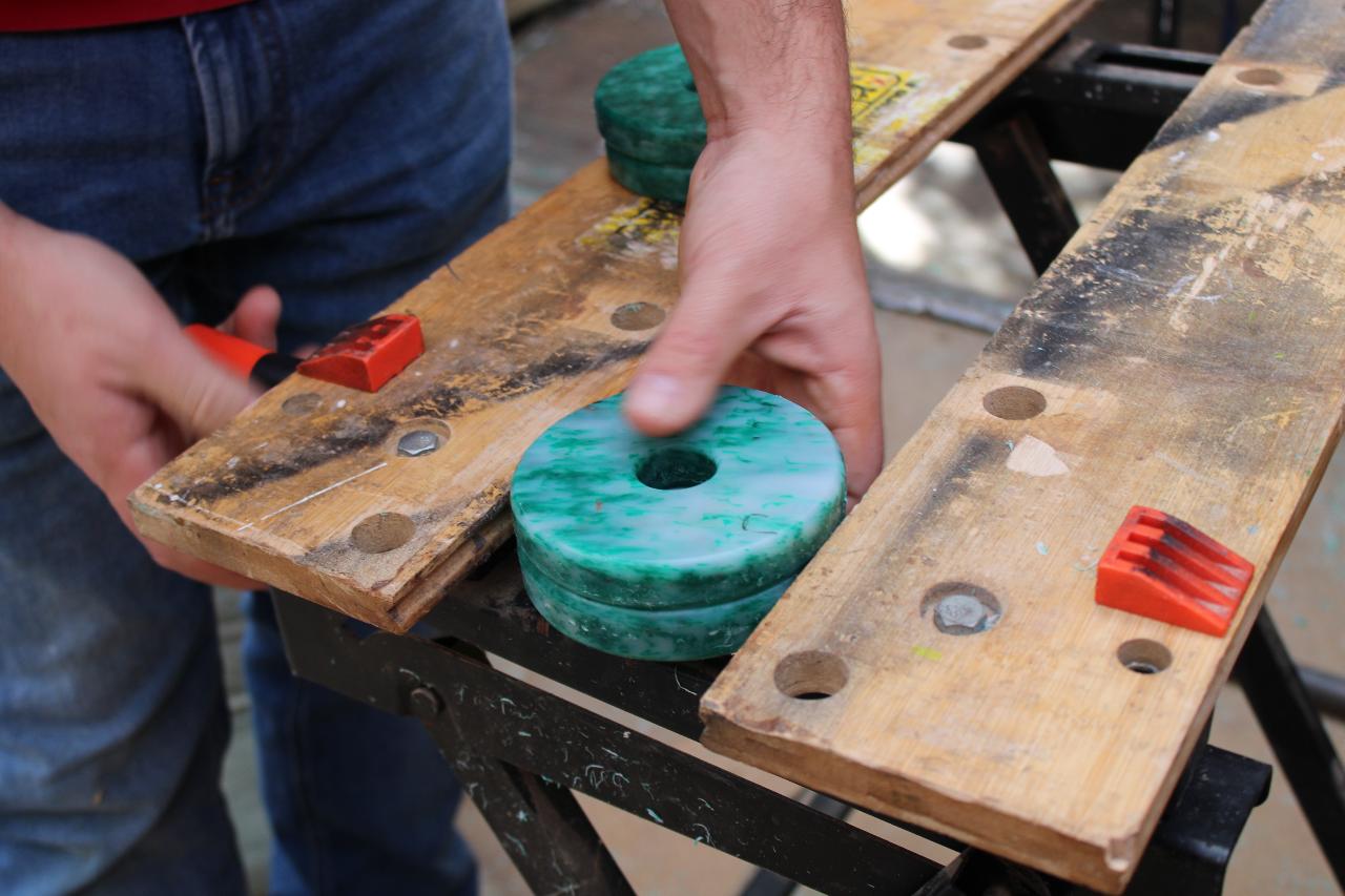

Step 5 - Assembly of dumbbells

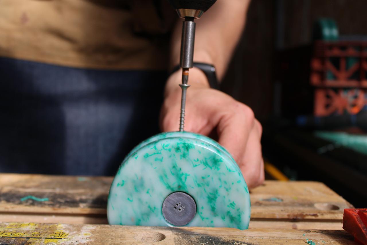

To assemble the pieces, we used stainless steel screws. So, as we recommended before, the first thing we do is a drill bit the size of the screw we will use, in this case we did 3mm drill to 4mm screws.
• Tip •
To assemble different types of plastic parts, we have decided to use torx head screws to give security to the products and that they are not so easy to disassemble.
