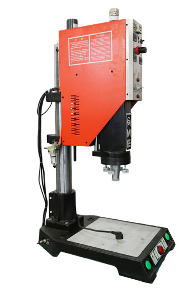

Ultrasonic welding, its limitations, and applications using plastic:
Ultrasonic welding is a process that uses high frequency vibrations to join thermoplastic parts. It works by converting electrical energy into mechanical energy in the form of ultrasonic vibrations. A transducer converts electrical input into vibrations at ultrasonic frequencies of 15 kHz to 40 kHz. These vibrations are transmitted to the materials being welded via a sonotrode (horn).
The vibrations create alternating compressive and tensile stresses between the plastic parts at the weld interface. This causes friction and heating of the materials, melting the plastic locally and allowing the materials to mix and join together. The entire process takes just a fraction of a second.
Limitations of ultrasonic welding:
  • Only suitable for thermoplastics, not thermosets or metals. The plastic must have some natural compatibility and ability to melt together.
  • Parts must have an accessible energy-directing surface and be rigid enough not to dampen the vibrations. Complex geometries can be difficult to weld.
  • Strength is dependent on the plastic’s natural compatibility. Two incompatible plastics may form a weak bond.
  • Dimensional limitations based on part size and access to the weld area.
-Difficult to automate and integrate into production lines compared to other plastic welding methods.
Applications and uses:
  • Assembly of plastic parts, containers, enclosures, medical devices, automotive components, consumer products, electronics.
  • Useful for water-tight seals. Commonly used for enclosures, food and medical packaging.
  • Can weld thin plastic films, ideal for plastic bags and packaging.
  • Suitable for small production runs where investment in automation is not feasible.
  • Can weld dissimilar plastic materials like multilayered plastics.
