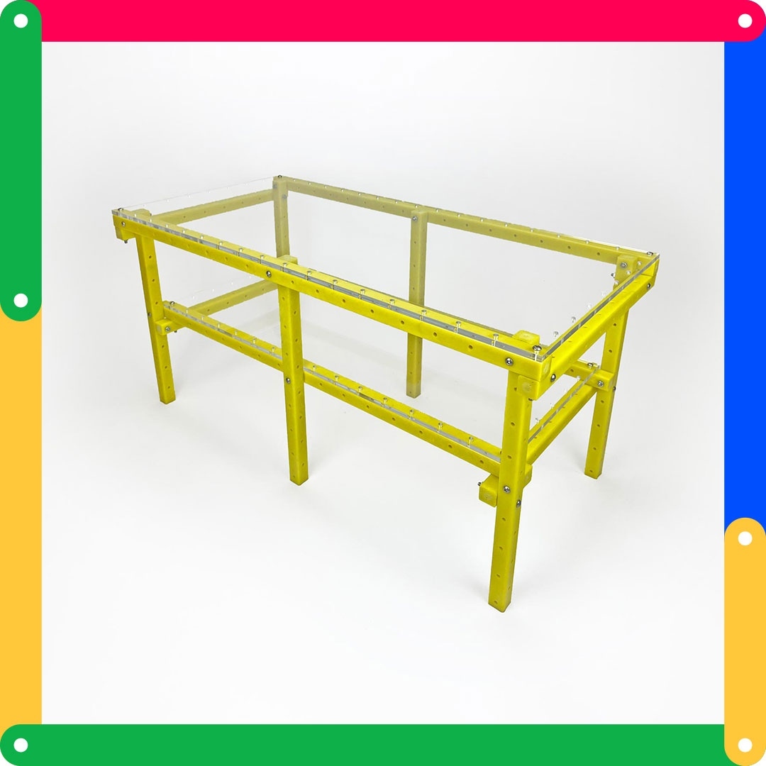

There is a temptation to extrude beams, but as was stated, a plastic like HDPE just has poor properties for a general purpose beam application. Even something like pine has at least 6x the modulus of elasticity. That’s before you consider voids and other defects. For a specific design, like the hanging chairs in the Maldives project, it is not a driver but for a replacement for 80/20 or steel angle, it is a tough sell.
v3 and v4 won’t extrude enough strength and size to make this work for that sizes as seen in ‘grid beams’. you could only try extruding support material with a shape that could host any of the thousands metal hole beams/extrusions; in a way you still can penetrate (outside can be fine too) the beam with at least 1cm depth on each side per bolt. more or less you will need at least 3x4cm, or better 4×8 cm of such beams to build a structure which can hold 50kg+
on the public market, a plastic grid hole beam is about 5 euro, for 3 meter, and it’s often used in the furniture industry as support material (drawer)

Product Liability could be another subject, but in this case I would like to borrow it. Creating and selling modular beams with which you _could _build a safe product is different from creating and selling a product that should be safe.
Lego probably also had a deadcount before they came up with Duplo…
With grid beams, the flimsy slides could be strenghtened to support even me.

It would be quite feasible to use a metal hole template (jig) when drilling through the plastic – in order to get the right spacing. In fact, this is the way people accurately space manually drilled rivet holes in sheet metal work (even on aircraft structures).
However, to ensure the holes remain square to the beam (and for safety), it would still be best to use a pillar drill, and something to securely clamp the beam and template.

– Structures can not be optimised for strength, weight, and compactness. Your structure may do the job, but it will be bulky and overly heavy for the loads involved. But that isn’t a problem if the structure is only meant to be temporary, to (say) demonstrate a concept.
– It also makes it easy for you to get carried away, ignoring the need for stress analysis, by allowing you to quickly build structures that are actually unsound.
– With regards to making beams out of some kind of extruded plastic (HDPE?) one major problem is that the material itself is not suited to large static structural loads. HDPE suffers from creep so it shouldn’t be relied upon for building stuff, unless the expected stresses are very small.
