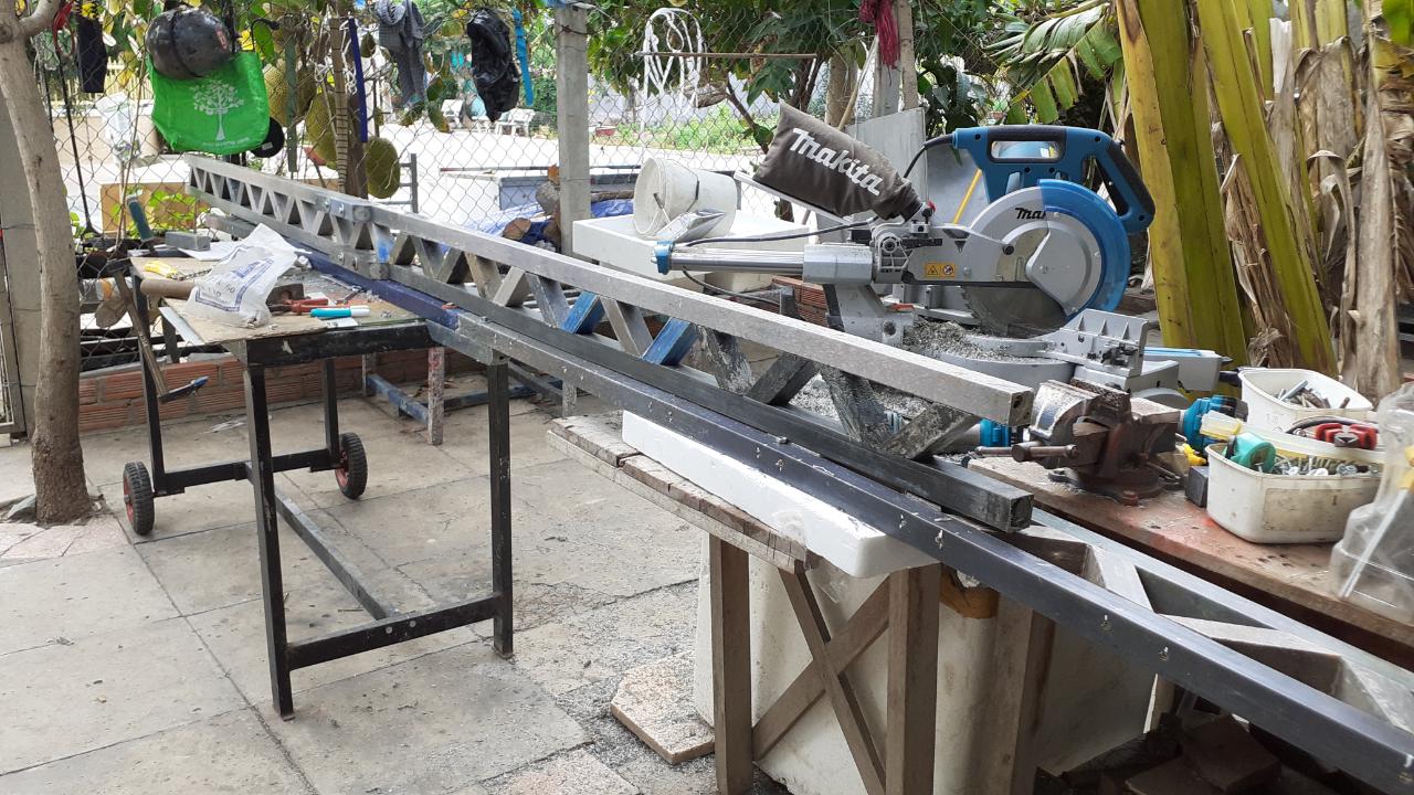

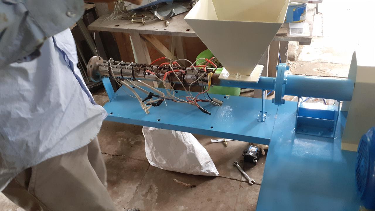

Step 1 - Extruding sticks
We use the mix of plastic found on the beach or in the environment, about 40 % LDPE, 20% HDPE, 20 % PP, 10 % shrunk EPS and a small amount of shredded PET, aluminium coa. ted chips bags, EVA , but no PVC … we accept some downgrading which is possible for a bit lower quality in this way.
My friend Toan Nguyen has developed the first extruders built in Vietnam.

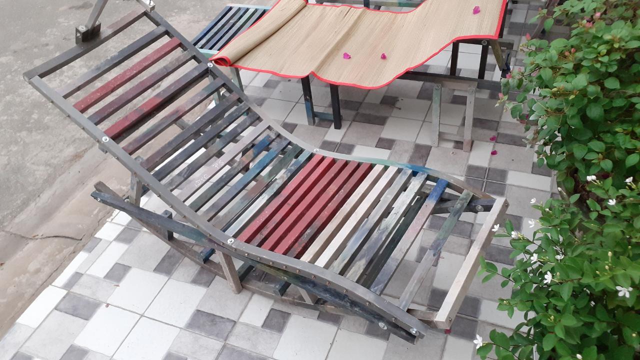

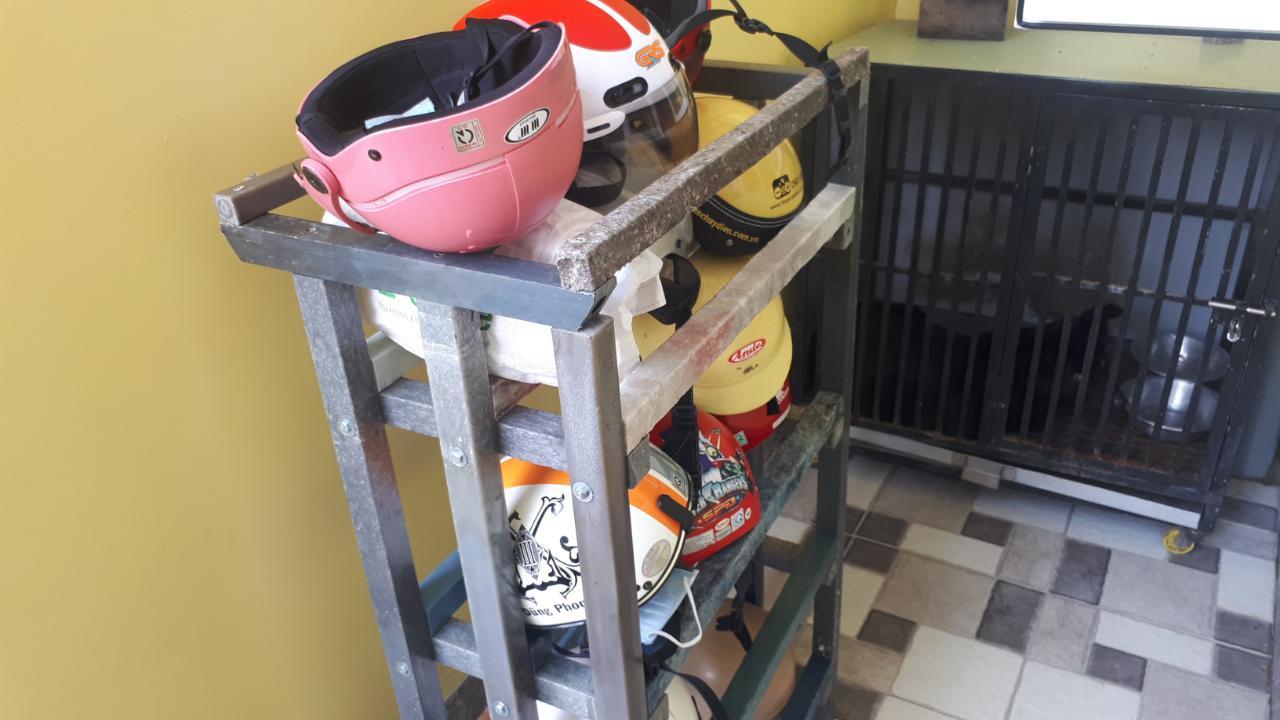

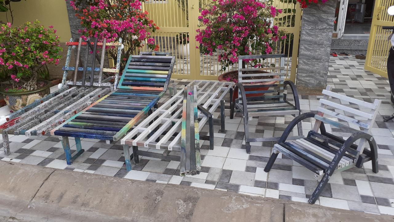

Choose a furniture design (you can just copy an existing piece of furniture which is made out of wood) and prepare the pieces you need to build it.

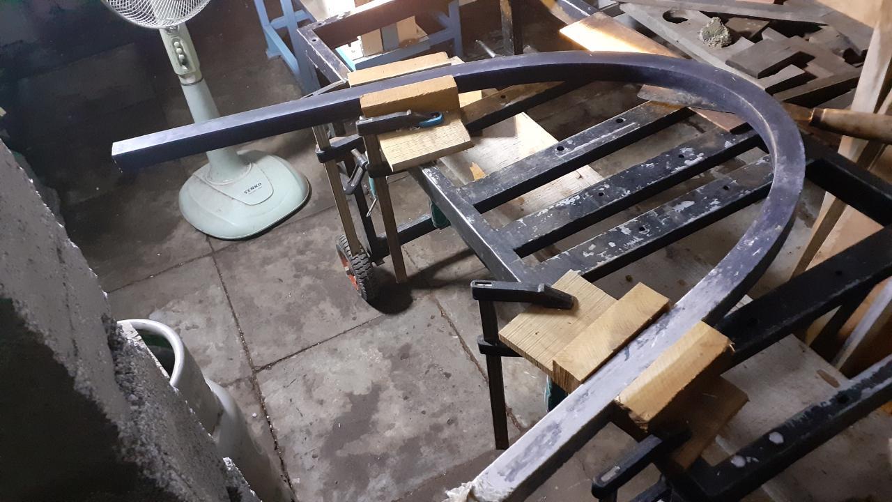

In most furniture it's enough to use straight beams, but you can also bend the sticks so you have round elements.

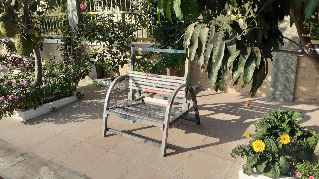

Step 3 - Screw the parts together
If you have all your parts ready you just need to screw them together like you would do with wood.
Then your furniture is done!

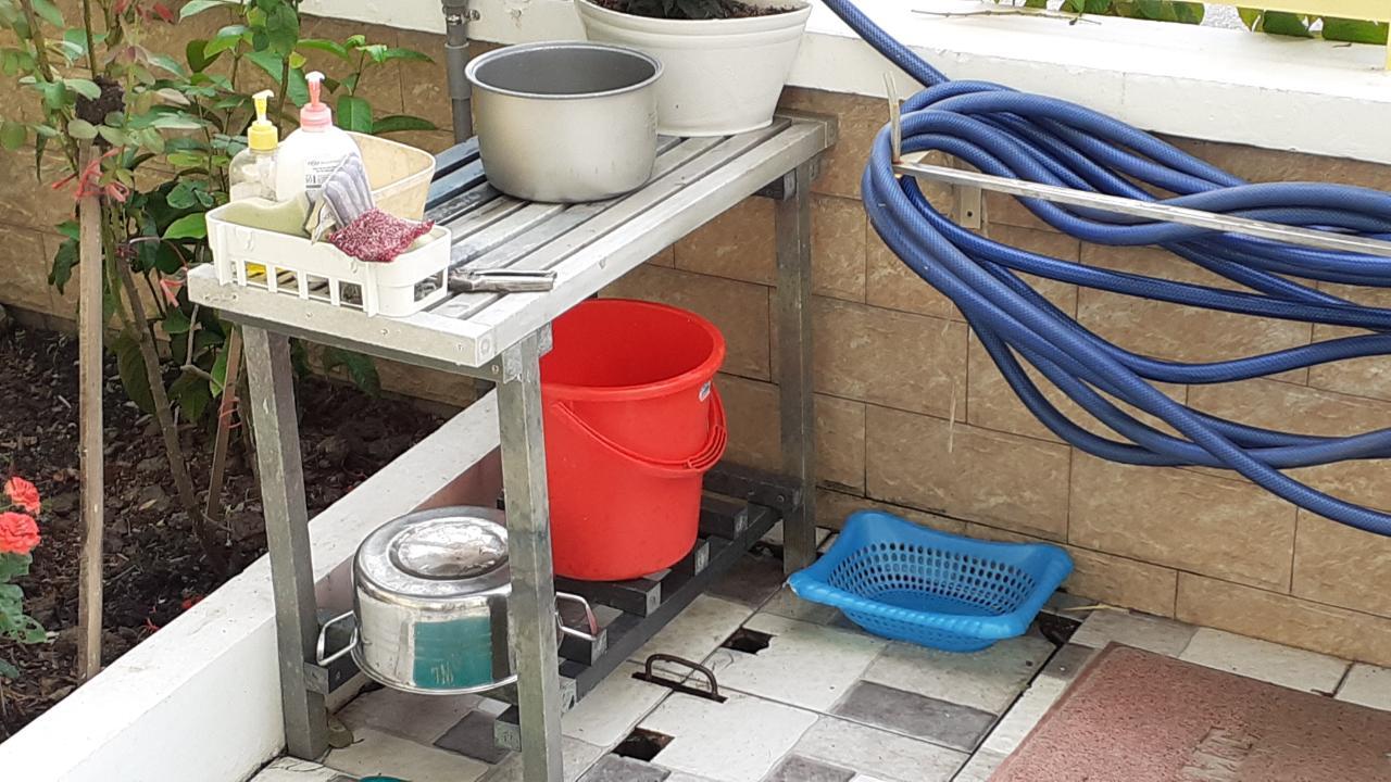

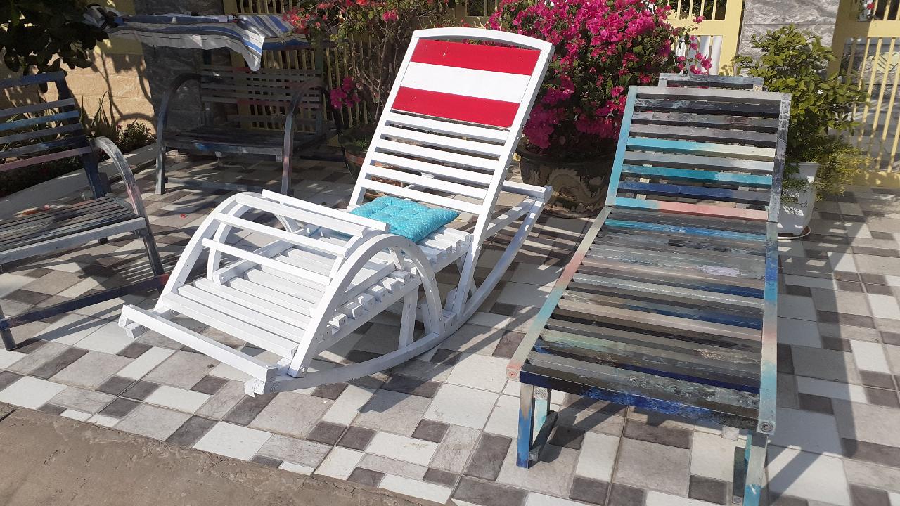

In this way we can process lots of plastic and all kinds.
We build outdoor shelves, tables …
