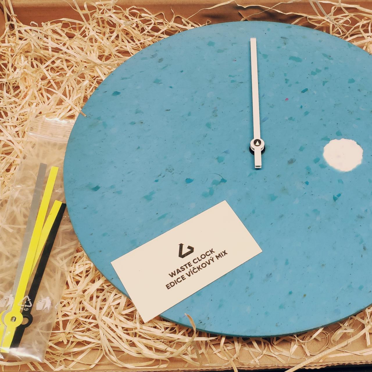

Making clock is not difficult and you are able to recycle about 300g per clock in less than 2 hours. With creative design can be clock nice present for your friends or family. These hand made products can be done with electric oven, mini press and a simple compression mould. Clock diameter is 30 cm with thickness of 5mm. Material cost is about 6 EUR/ clock.

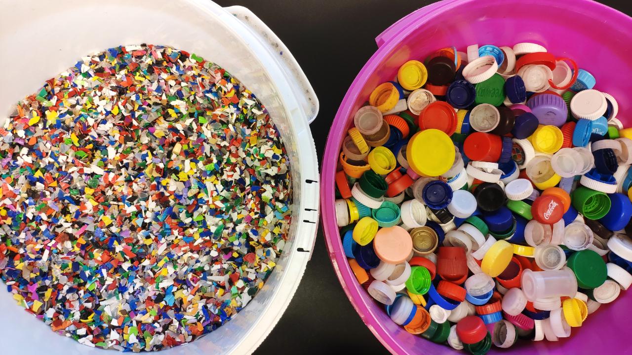

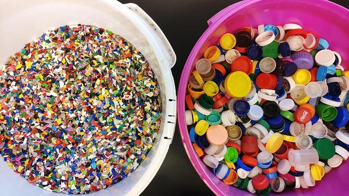

I have already tested HDPE, PP or PLA with good results.
You can play with different colours and bottle cap design. :slight_smile:
You need between 270 - 350 g / clock (depends on material density)

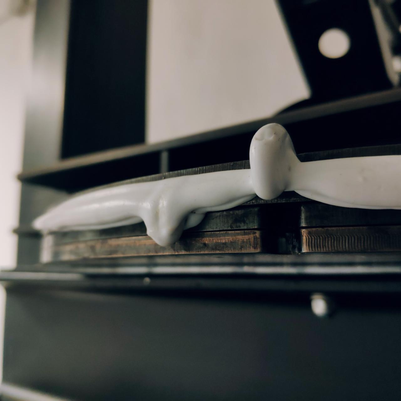

After baking process, press mould.
Cooling process take 20 - 30 min.
If you open mould earlier, there is risk of deformation.

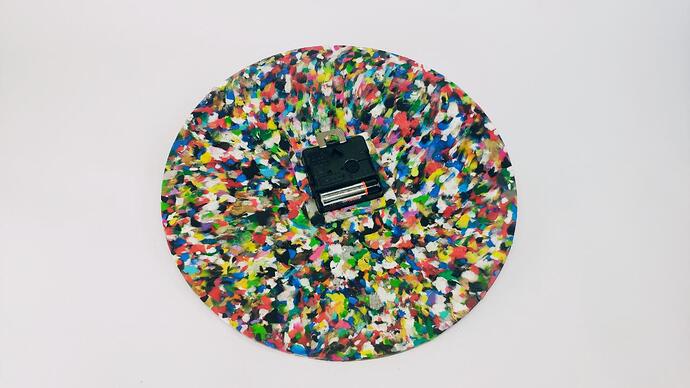

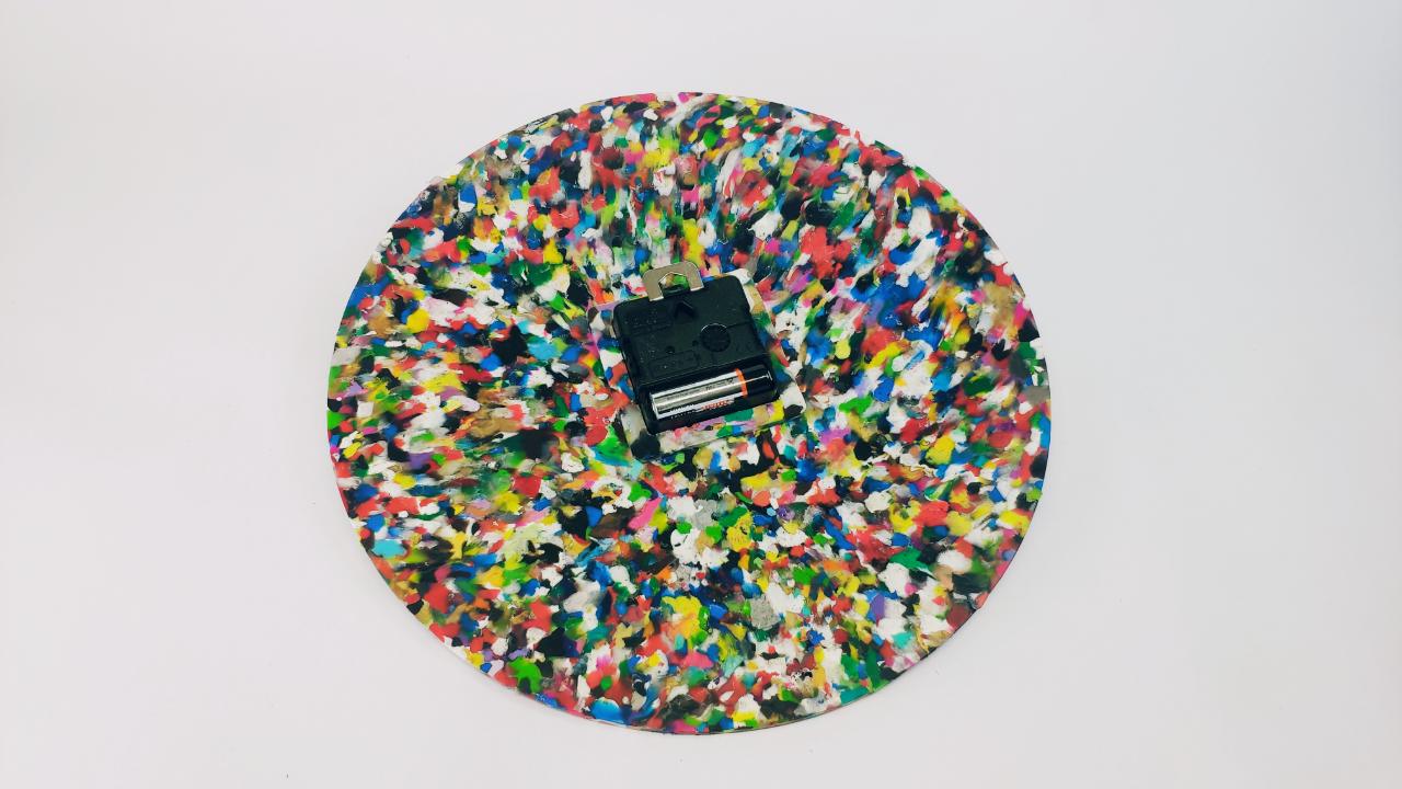

Drill hole in the middle according to size of your clock mechanism.

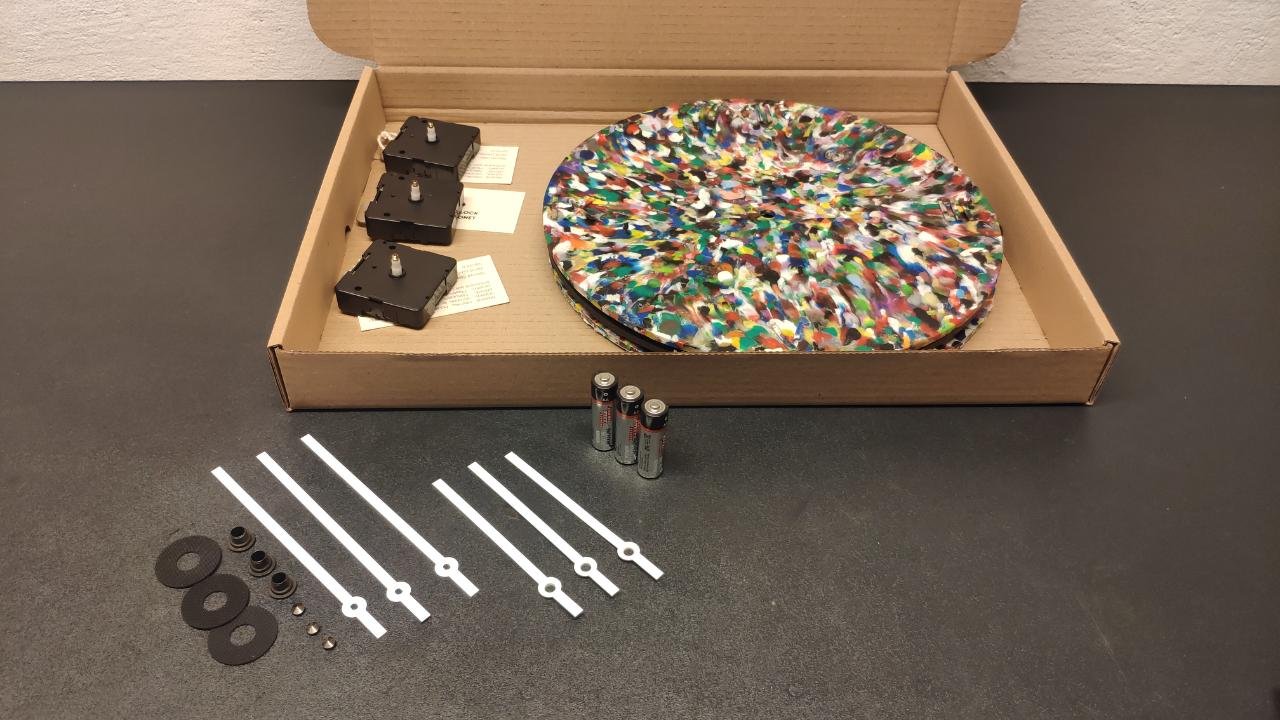

List of components and tools for clock assembly that I use - available in supporting material.
I buy them from Czech company.
On back side of clock there is small square frame which fits to the clock mechanism I use.
You can modify mould as you want. I prefer to fix position of clock mechanism to prevent its rotation.
I do not recommend sanding of surface if you use plate with numbers (area around numbers can be difficult to sand).

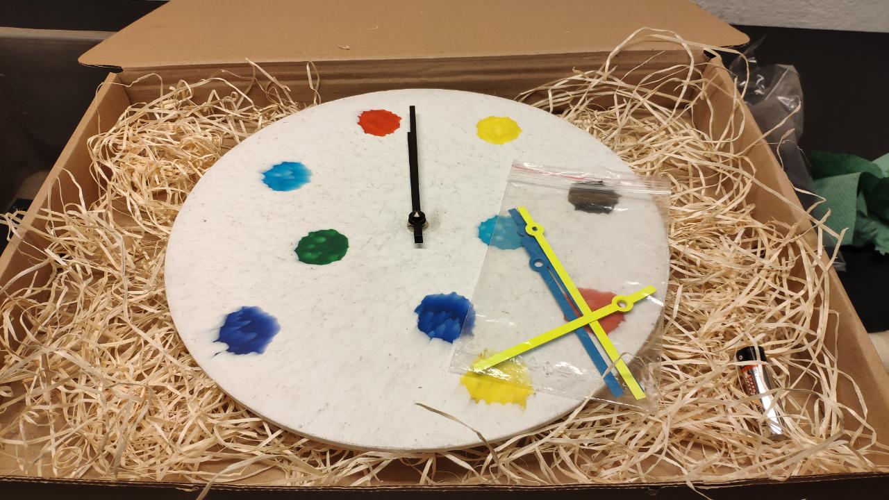

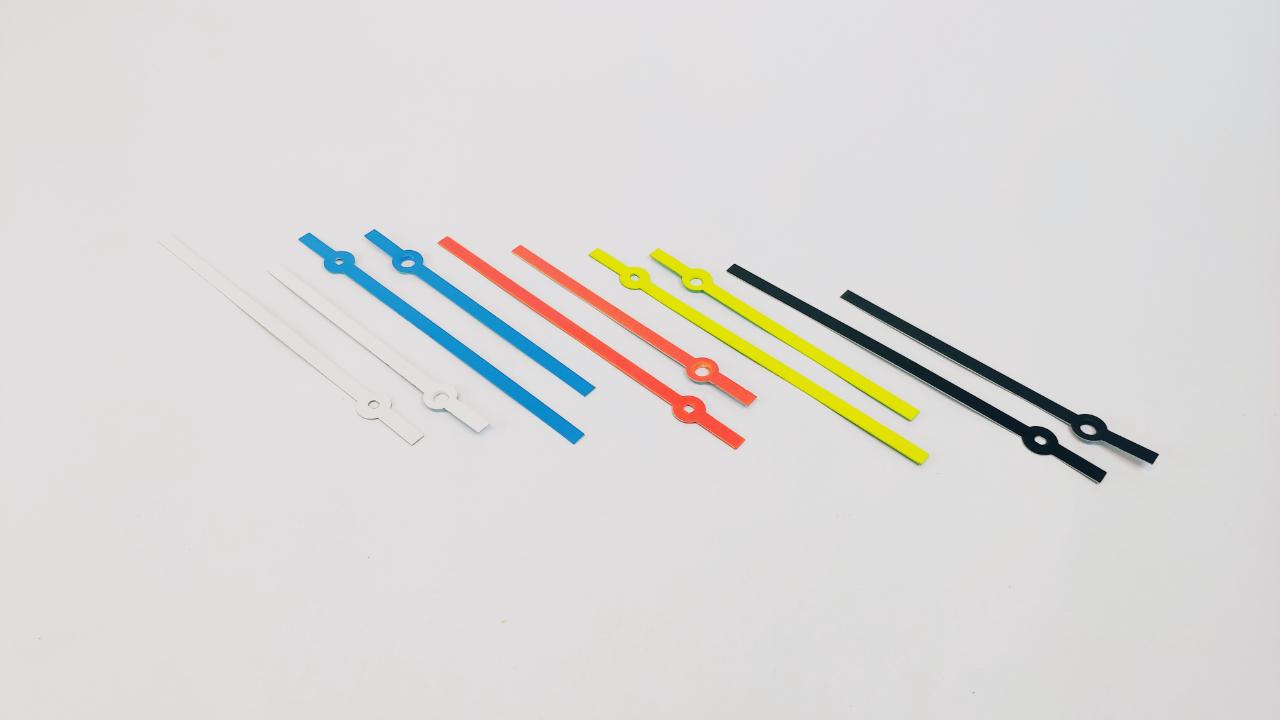

Nice advantage is different colours of clock hands, you can combine different colours. :slight_smile:
