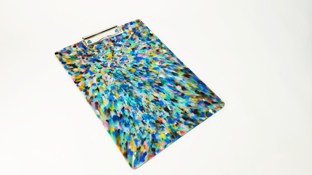

Make original clipboard from recycled plastic material. Board size is 315x230 mm thickness 5mm, 4x radius R8 in corners.

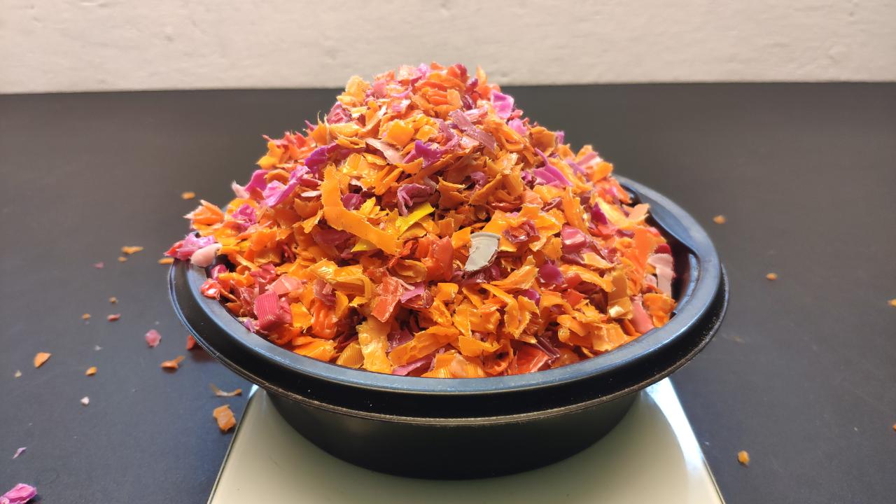

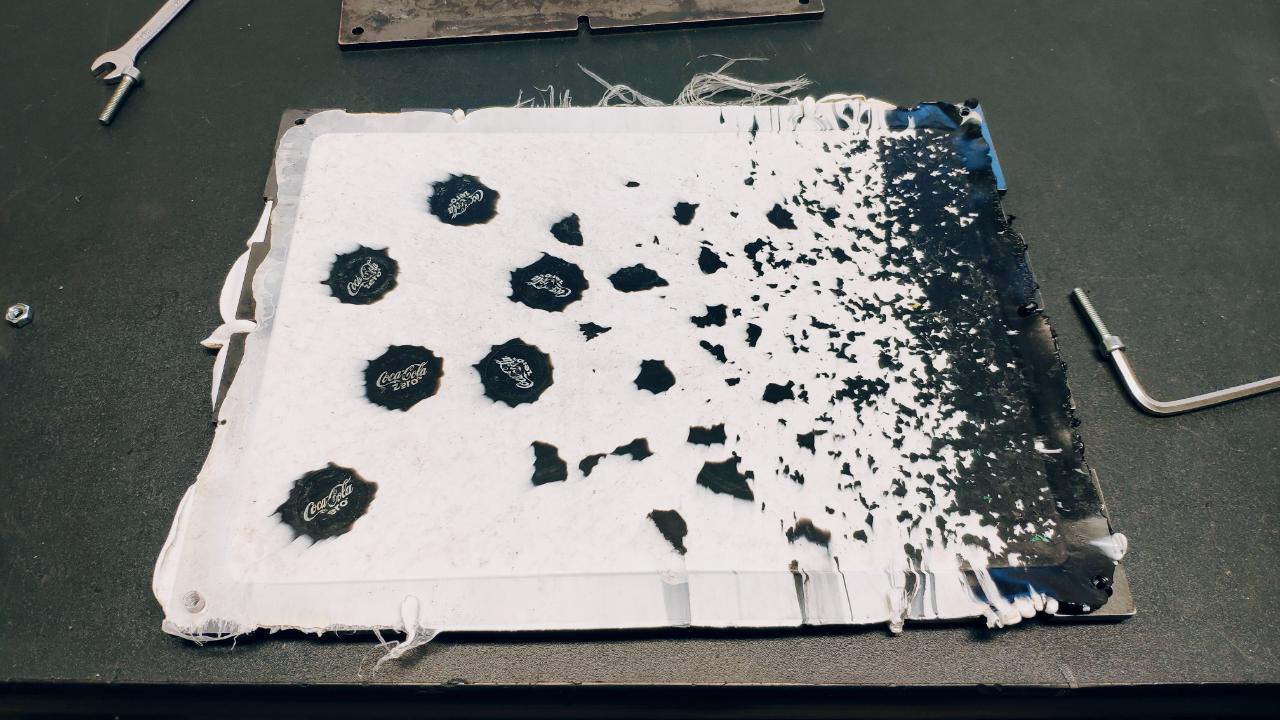

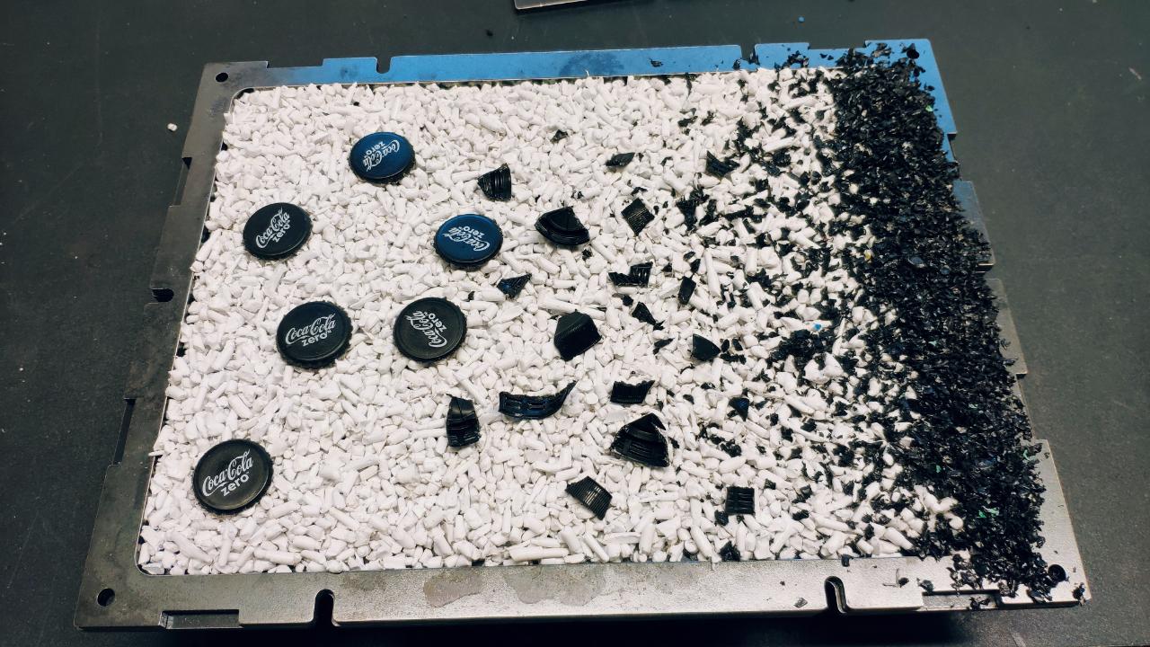

Step 2 - Prepare material + mould
I have already tested HDPE, PP or PLA with good results.
You can play with different colours and bottle cap design. ![]()
You need between 320 - 350 g / clipboard.
Before testing new material type, make a note/ picture how many material did you use. It will help you with future production.
Clean mould from impurities, dust or remaining plastic particles from previous production. (I use smooth sand paper)
To avoid sticking use mould release or oil.
Make sure your oil will not get to its smoke point:
https://en.wikipedia.org/wiki/Template:Smoke_point_of_cooking_oils
I recommend oil with smoke point above 230 deg. Celsius

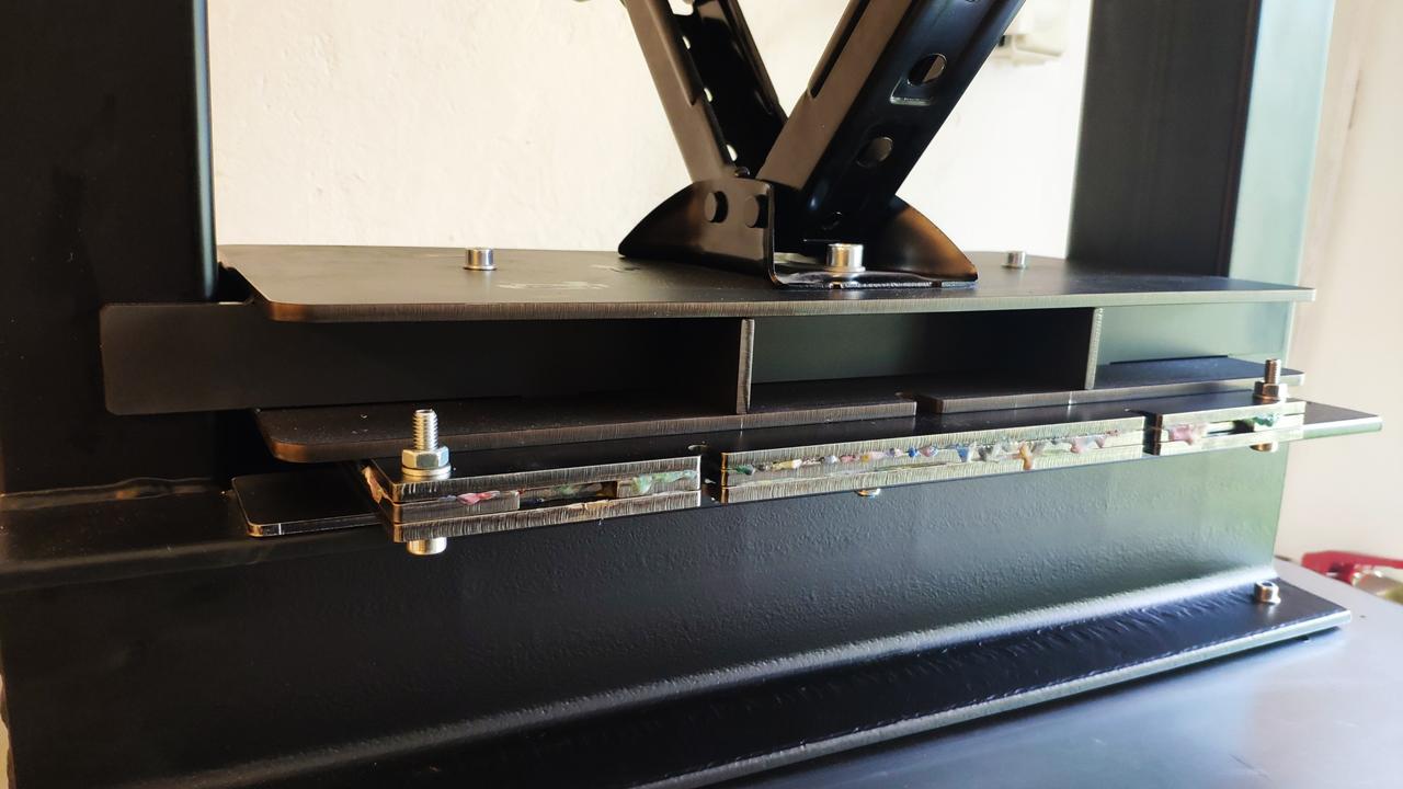

Step 3 - Baking + pressing
I use IKEA Görlig electric oven.
Set up temperature according to your material type.
For HDPE and PP I use temperature 225 deg Celsius.
I put mould in the oven for 35 min.
Set up timer.
Attention - use heat resistent gloves when you operate with mould from oven ![]()
After baking process, press mould.
Cooling process take 20 - 30 min.
If you open mould earlier, there is risk of deformation.

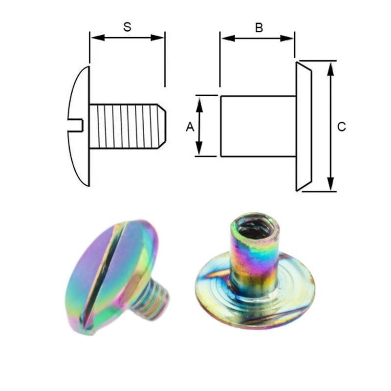

I prefer screw type rivets - you do not need special tools and you can make easy and quick change board design with clip.
Rivet size:
A: 4mm
B: 6mm
C: 10mm
S: 4mm

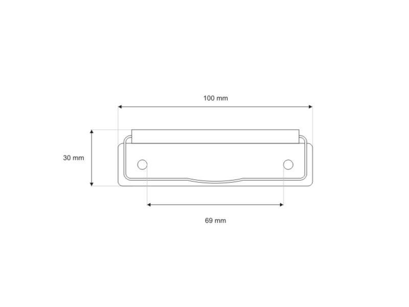

Step 5 - Follow Plastmakers
To provide more open source content, I will be happy for share, subscribe, like, follow or comment. <3
