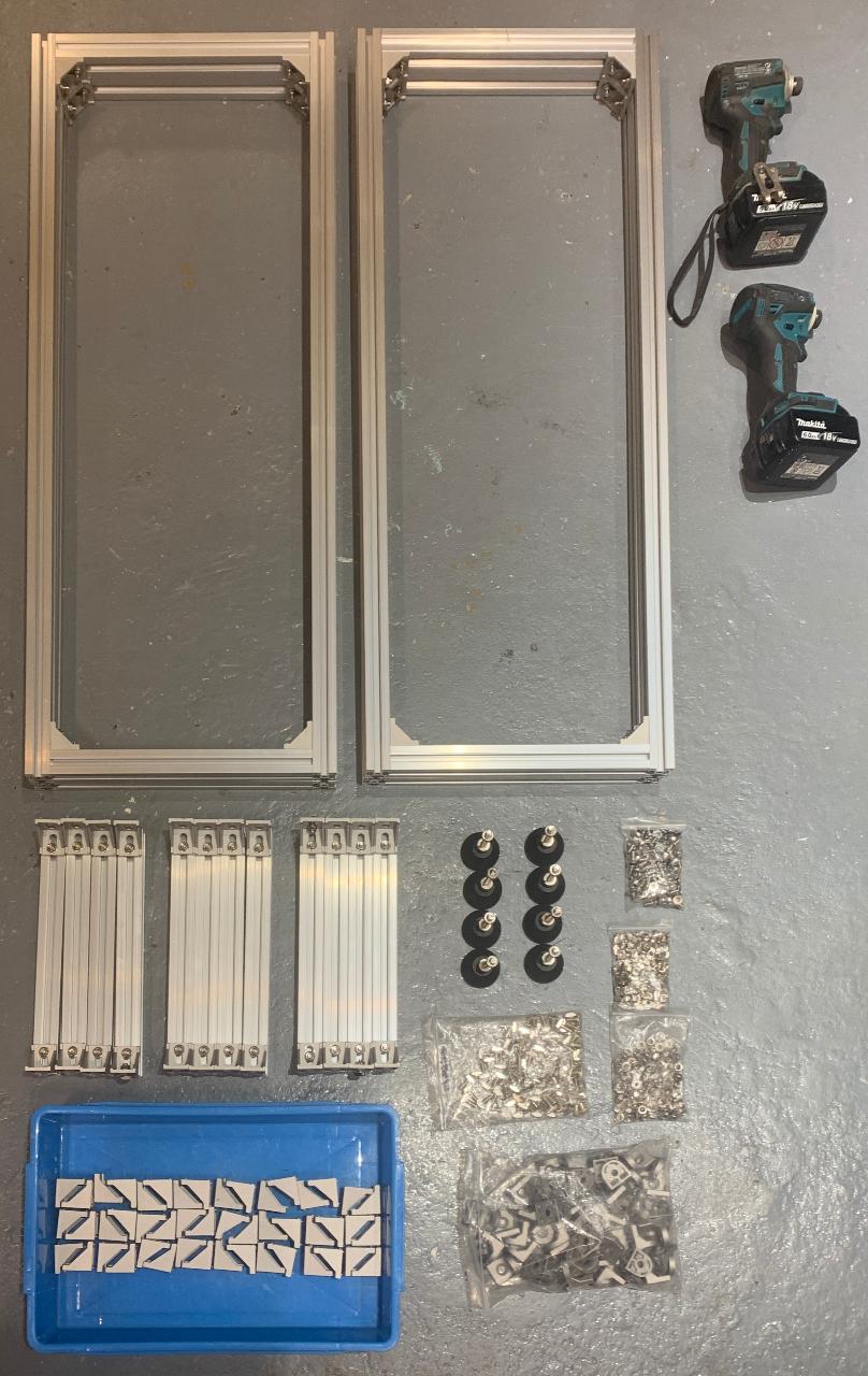

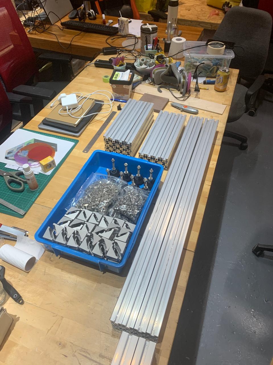

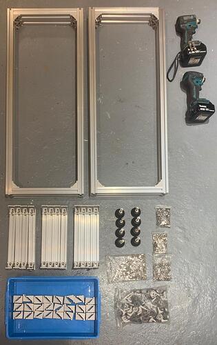

Step 1 - Prepare materials
Prepare material according to the size and design of the recycling bin.
In our case:
30x30 alumimum tube 935mm x8
30x30 alumimum tube 316mm x8
30x30 alumimum tube 300mm x12
Corner fixing clips x50
Corner fixing plate x50
legs x8

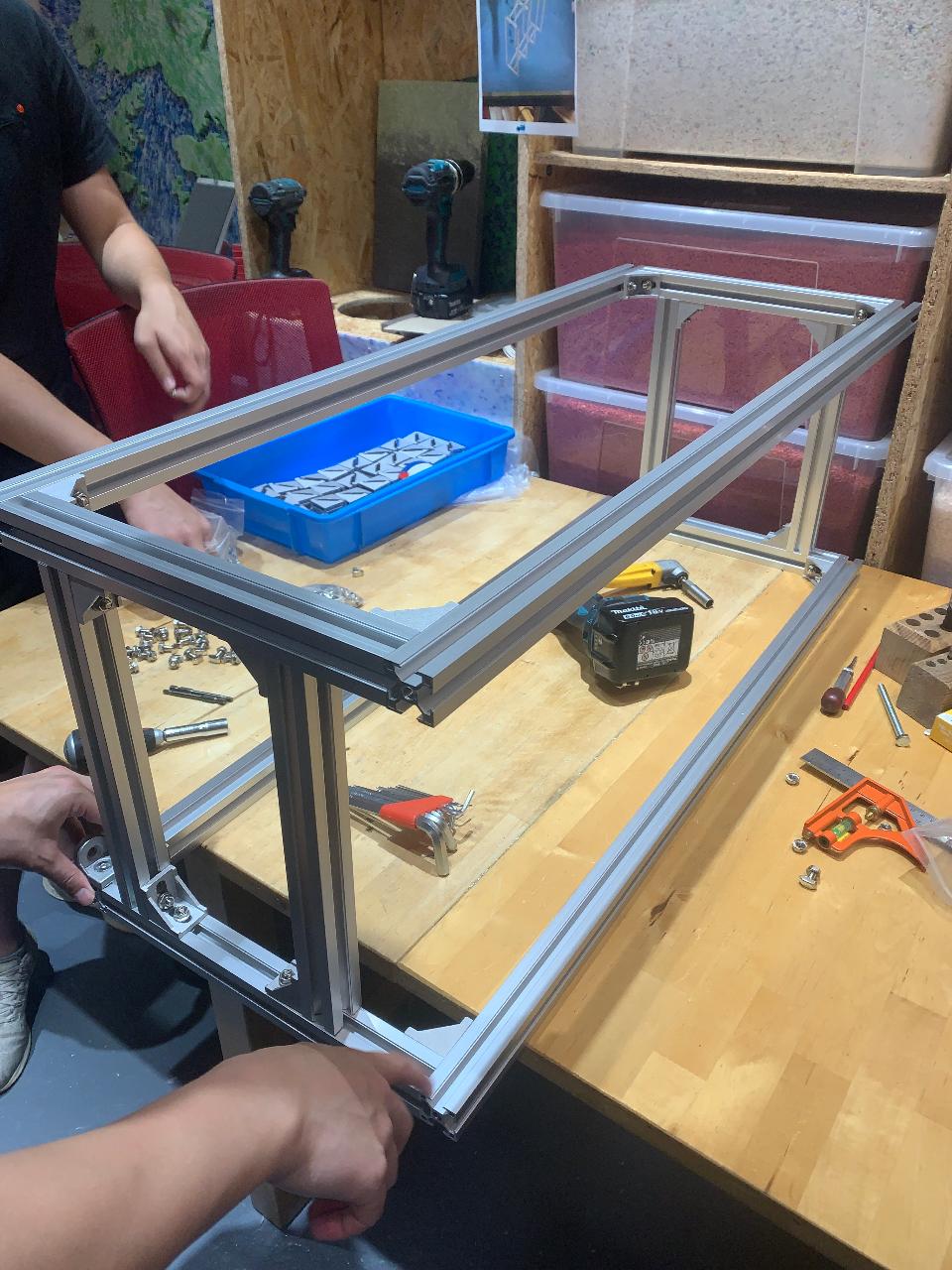

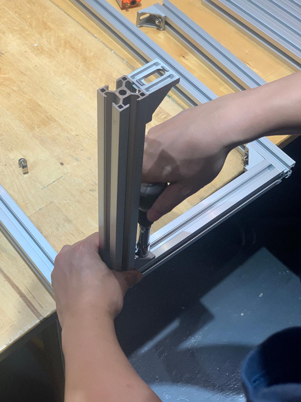

Step 2 - Assemble the frame

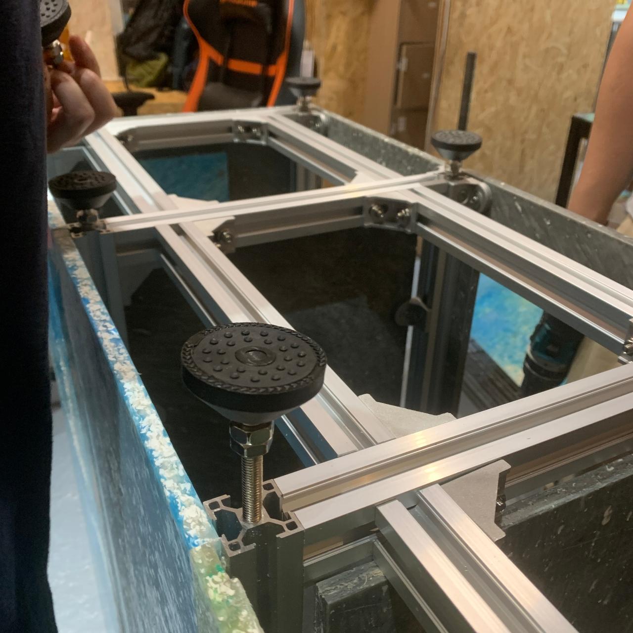

Assemble the frame, with the corner fixing clips and avoiding the corners for mounting the panels afterward.

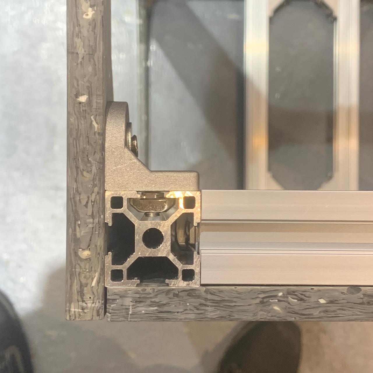

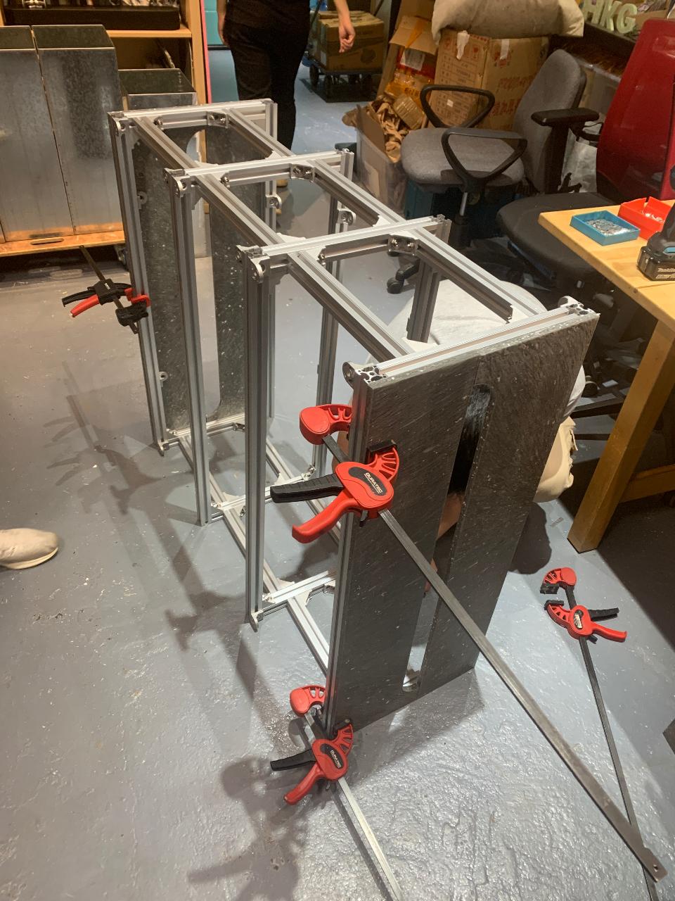

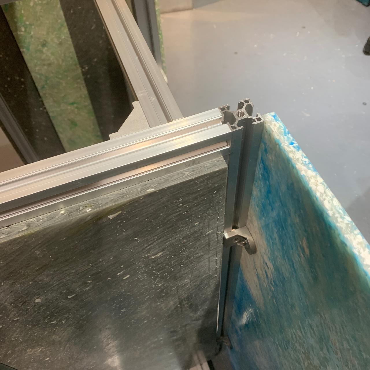

Step 3 - Mount the panels
After the frame is done, fix the panel onto the frame with screws and corner fixing plate.

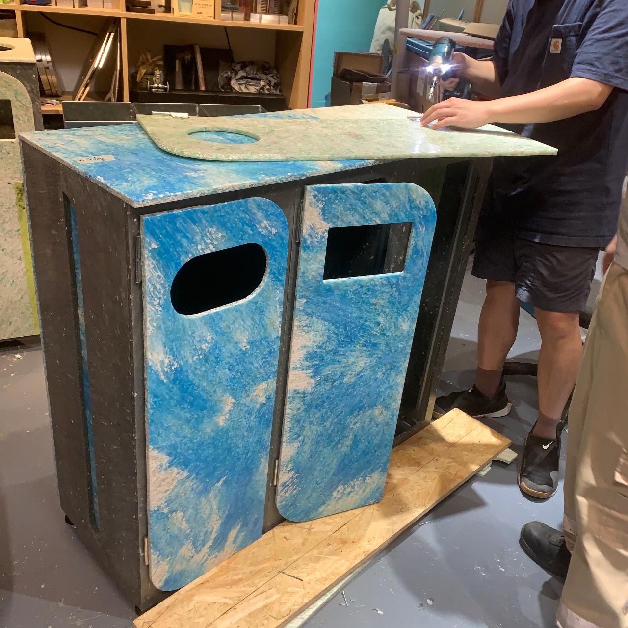

We use 12mm thick PP sheets and use CNC milling to cut into the right shapes.

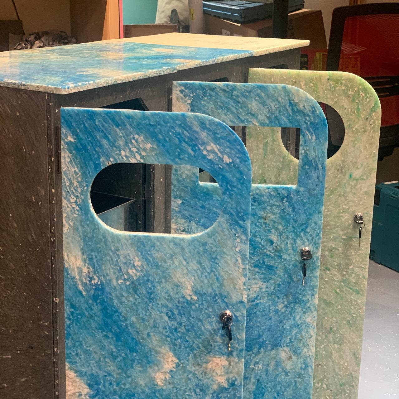

Step 4 - Legs and doors
Add legs to the bottom of the bin for uneven floor.
Lastly, assemble the doors with door hinges, and add locks or magnets to keep them close.
