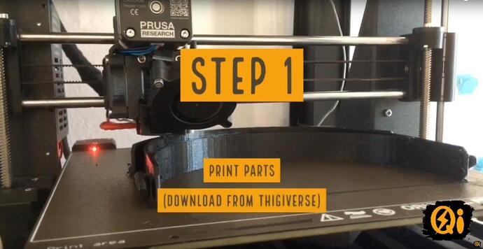

Step 1 - Print Parts
3D-Print the Top and bottom part of the shield. Download the Files for free from Thiniverse or Prusa or use the files in the zipped folder you can download here.

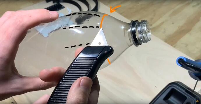

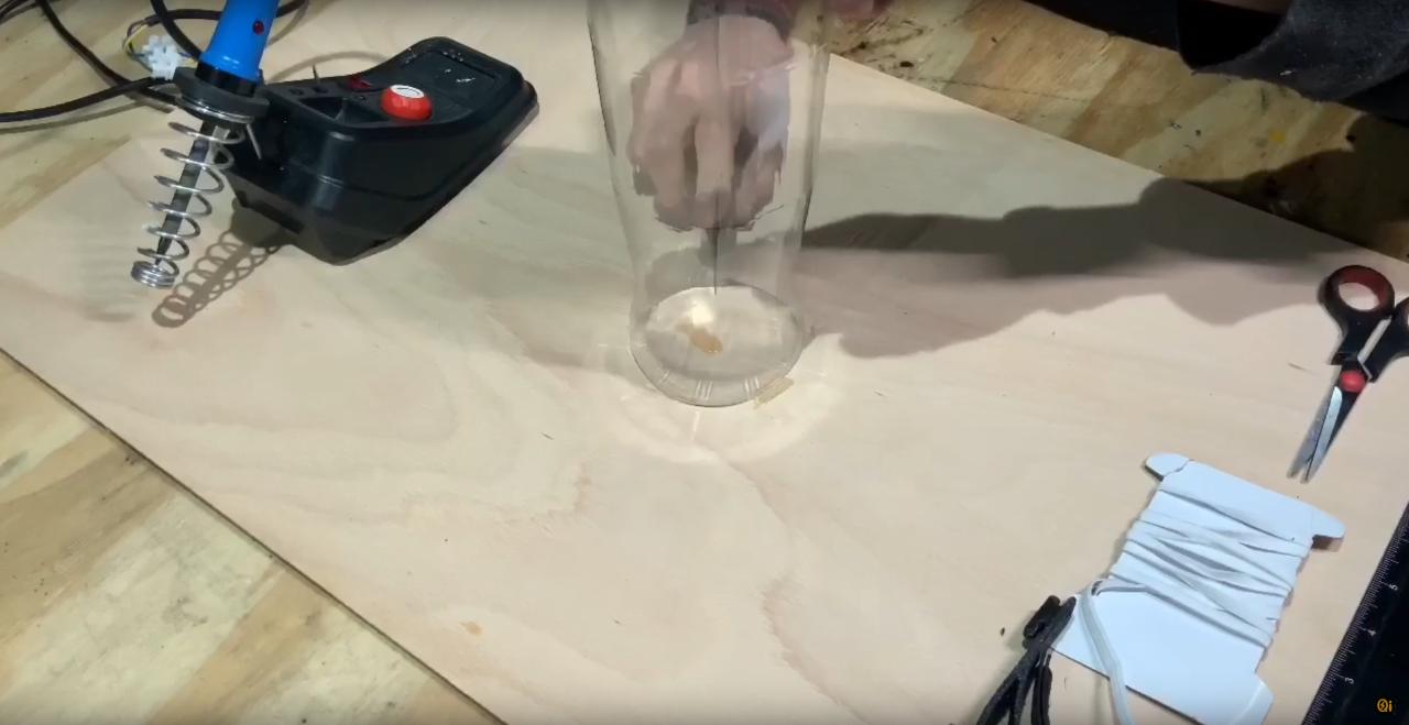

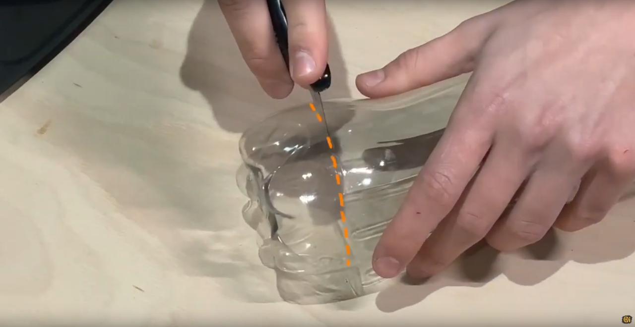

Step 3 - Prepare bottle
First of all, you need to wash out the bottle and then cut off the top and bottom parts. Finally cut along the side of the bottle so you can bend the Plastic open.

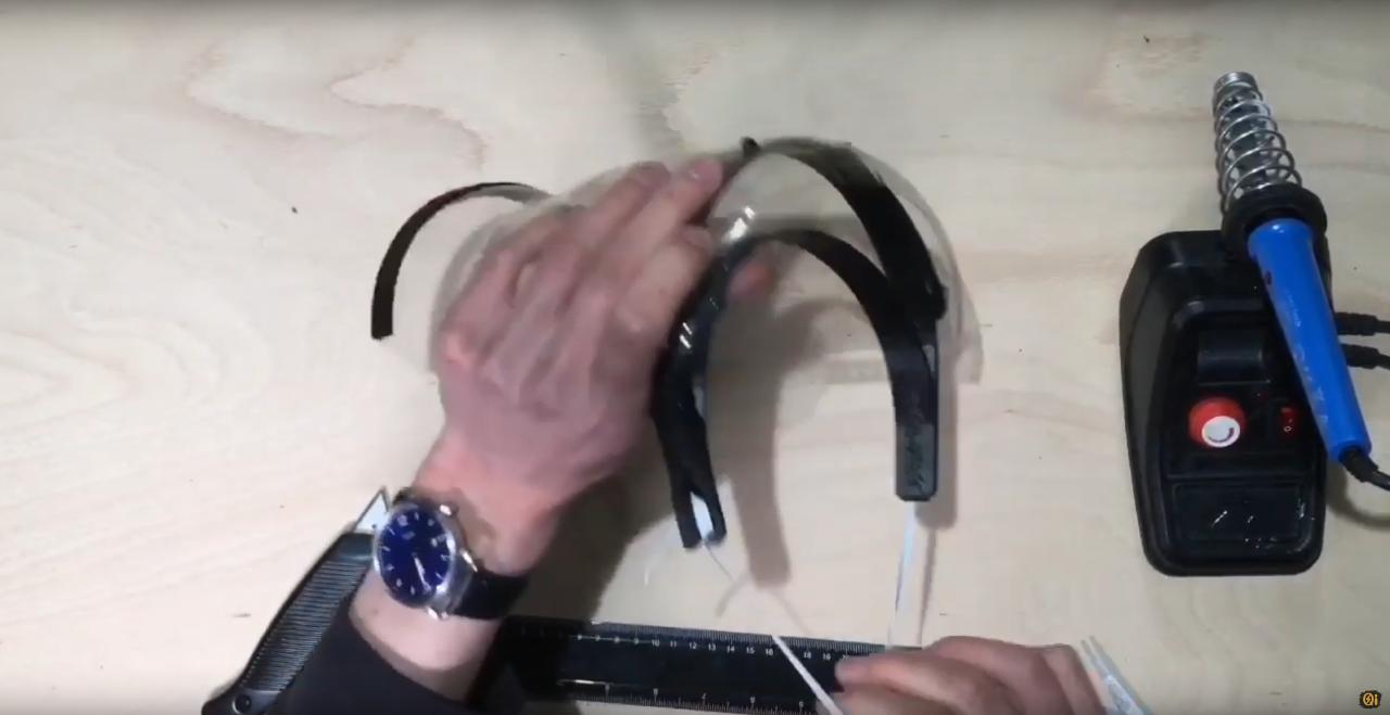

Step 4 - Connect 3D-Printed parts

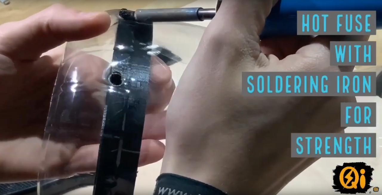

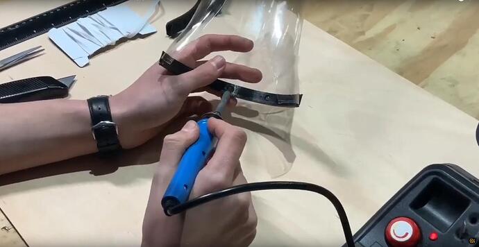

Start off with the bottom part. Fold open the PET bottle and press it into the the slit. The use the soldering iron to melt the PET and the printed parts in 3 Points that are visible from the inside.

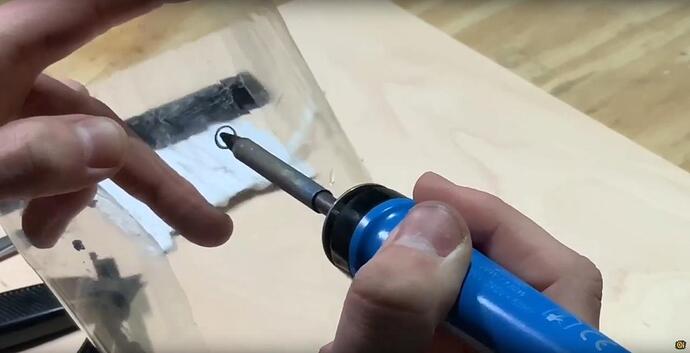

The Next step is to attach the top part. First, use a edding to mark where to make holes in the bottle. Then use the soldering iron to melt these holes. After attaching the top part you can use the soldering iron the melt the plastic together for additional stregth.

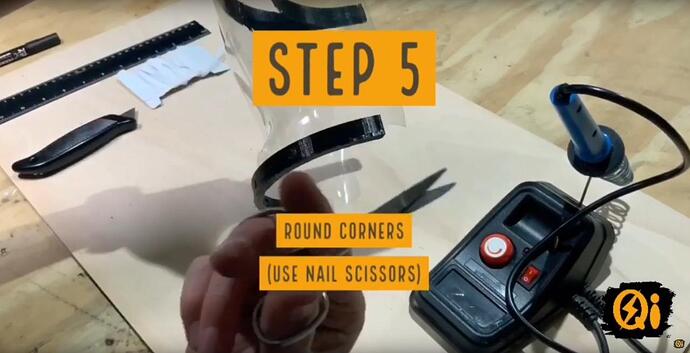

Step 5 - Round off corners
Use nail scissors to round off corners at the bottom of the PET shield. If you don't have nail scissors you can also use normal scissors.
