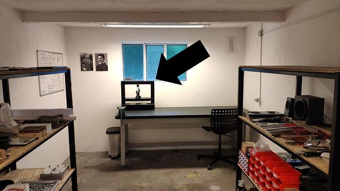

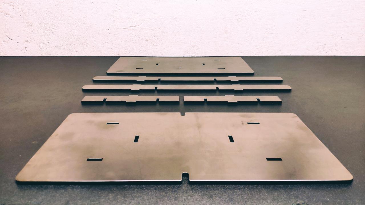

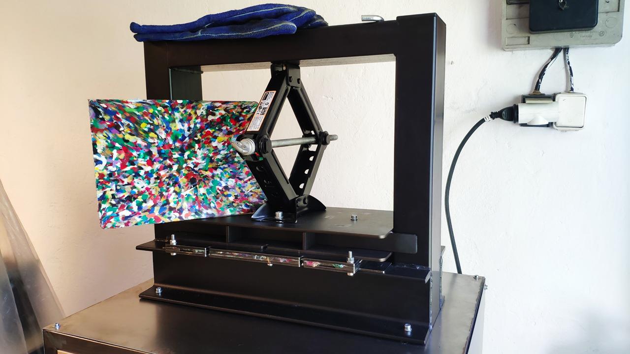

Tutorial how to build mini press for compression moulding. For making this simple machine you need welding machine, access to laser cutting machine, drilling machine and basic assembly skills.

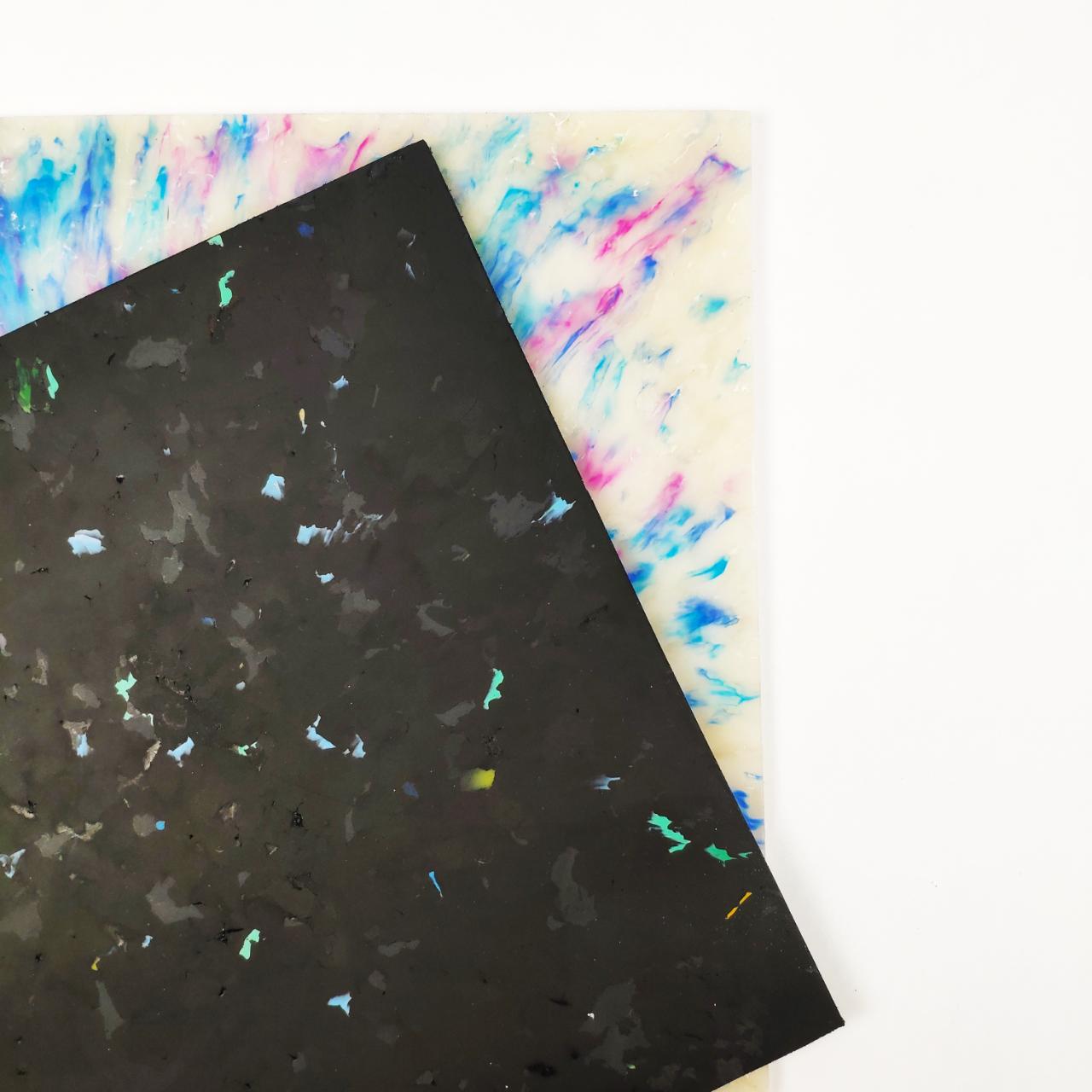

With this standard size frame it is possible to press sheets with area 37x37cm.
Max. recommended mould height is 80mm

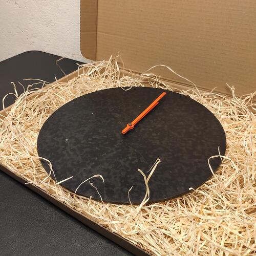

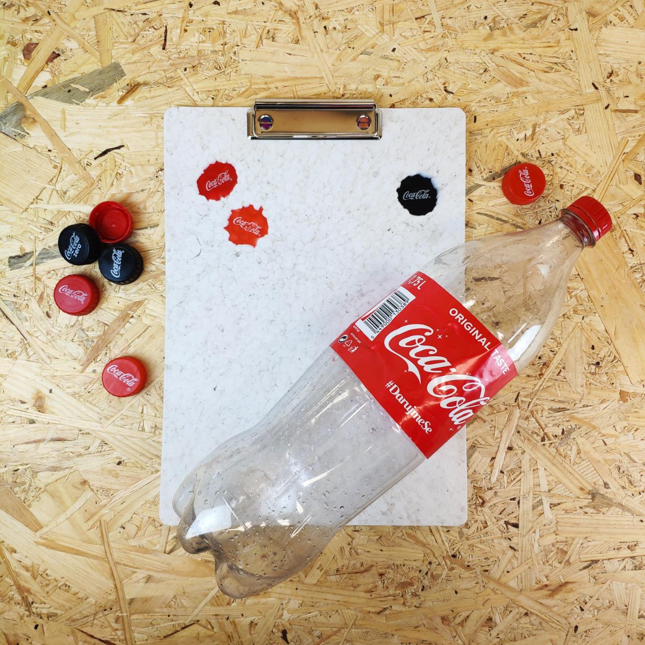

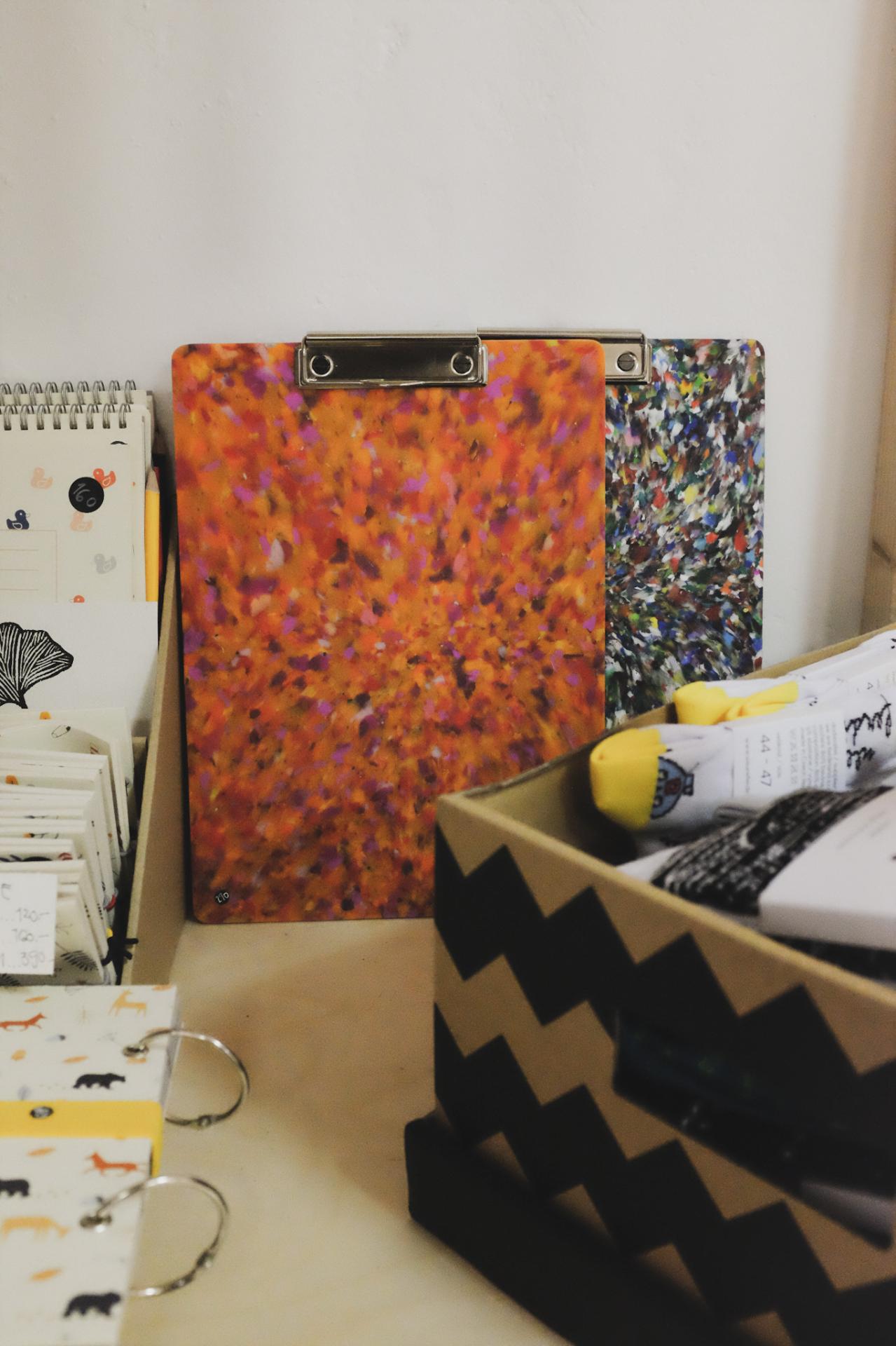

I have already produced:
sheets 37x37cm, thickness 3, 5, 20mm
coasters
clock
clipboard

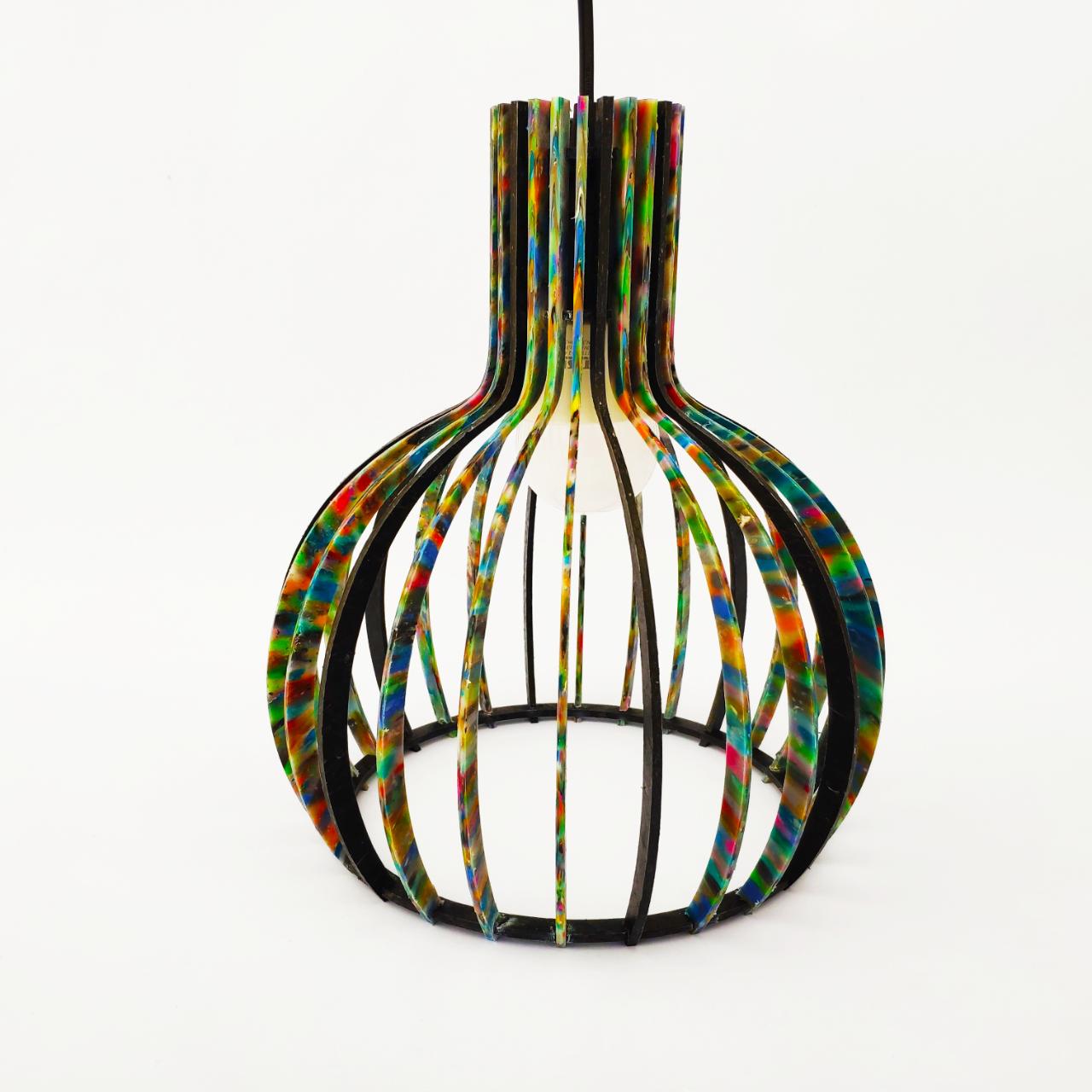

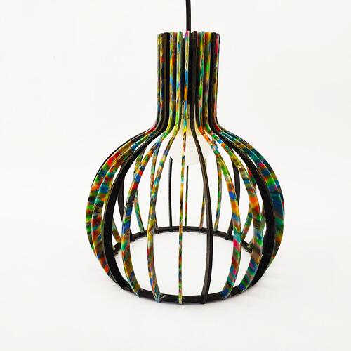

sheets which was latter used for CNC cutting - design of lamp, animal models.
