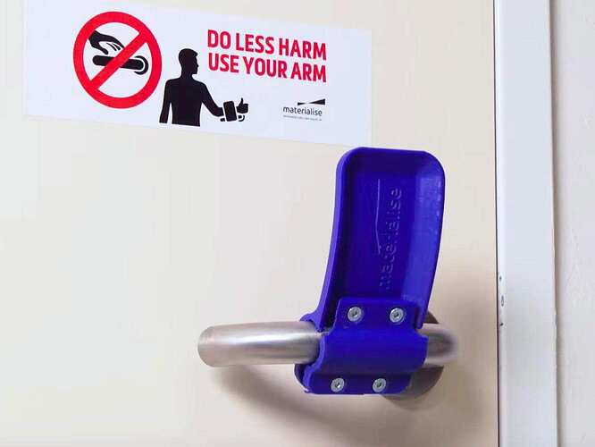

With this How-to you can make your mould to inject a "hands free" door handle - to help stop the spread of COVID-19!

Step 2 - Inject and assemble
Once you injected your parts with your injection machine, you can assemble the product.
You'll need:
The two injected parts
2x M4 screws and Nuts
1x bike tube for in between

Step 3 - Use it!
Do less harm, use your arm ![]()
