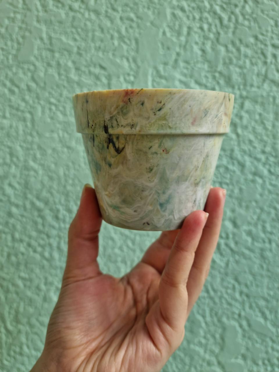

Here we share some files to make your own flowerpots with the injection machine.

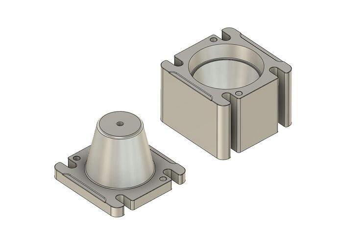

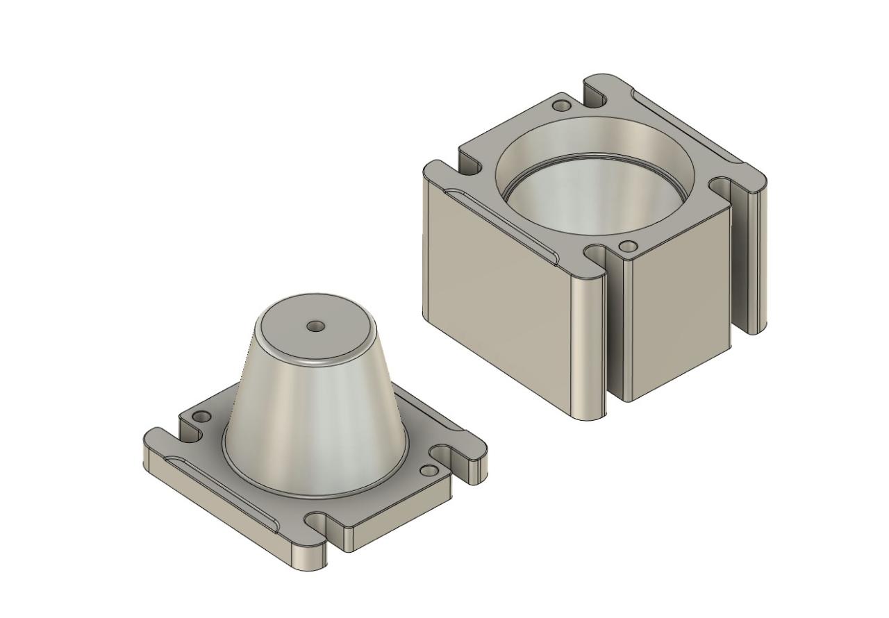

Step 1 - Make your own mould or get it over at the Bazar!
You find the CAD files linked above to make your own.

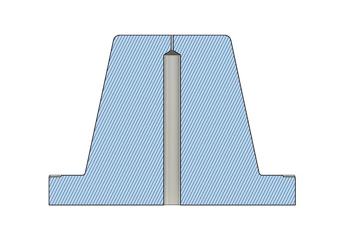

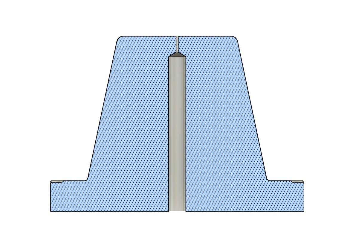

Step 2 - Tricks for the mould part ejection
Removing the parts can be sometimes a bit hard. There are two ways to ease up the process a lot.
1.) Pressurized Air - drill a very small hole (<1mm) into the inside piece of the mould followed by a larger hole from the other side.
After you injected a piece use a blow gun of an air compressor to pop out the parts easily. If done right the plastic won't flow beyond the small hole.
2.) Add a bolt instead of pressurized air to the inside piece of the mould and cut a thread inside. Then after injecting you can screw in the bolt and the parts will fall out easily. This way you stay mobile for workshops out in the open :wink:

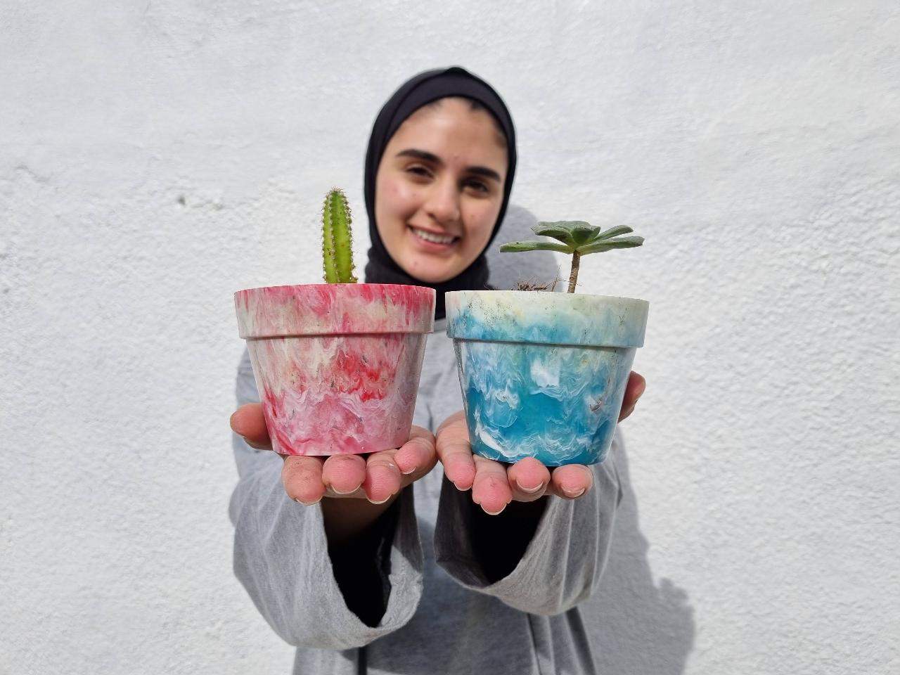

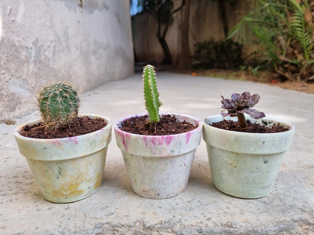

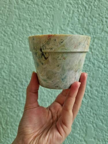

Step 3 - Plant some nice flowers
Altough small you can get some nice assemblies of flowers or cactus in them :slight_smile:
