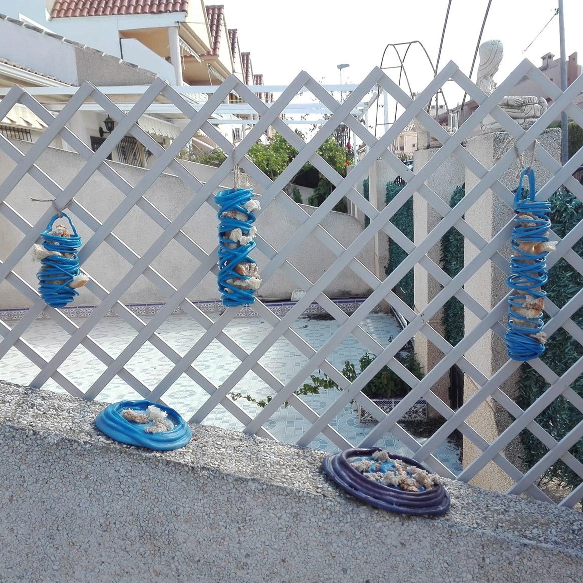

Bird feeder made with recycled plastic and Precious Plastic extruder.

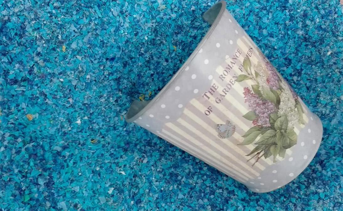

Step 1 - Select plastics

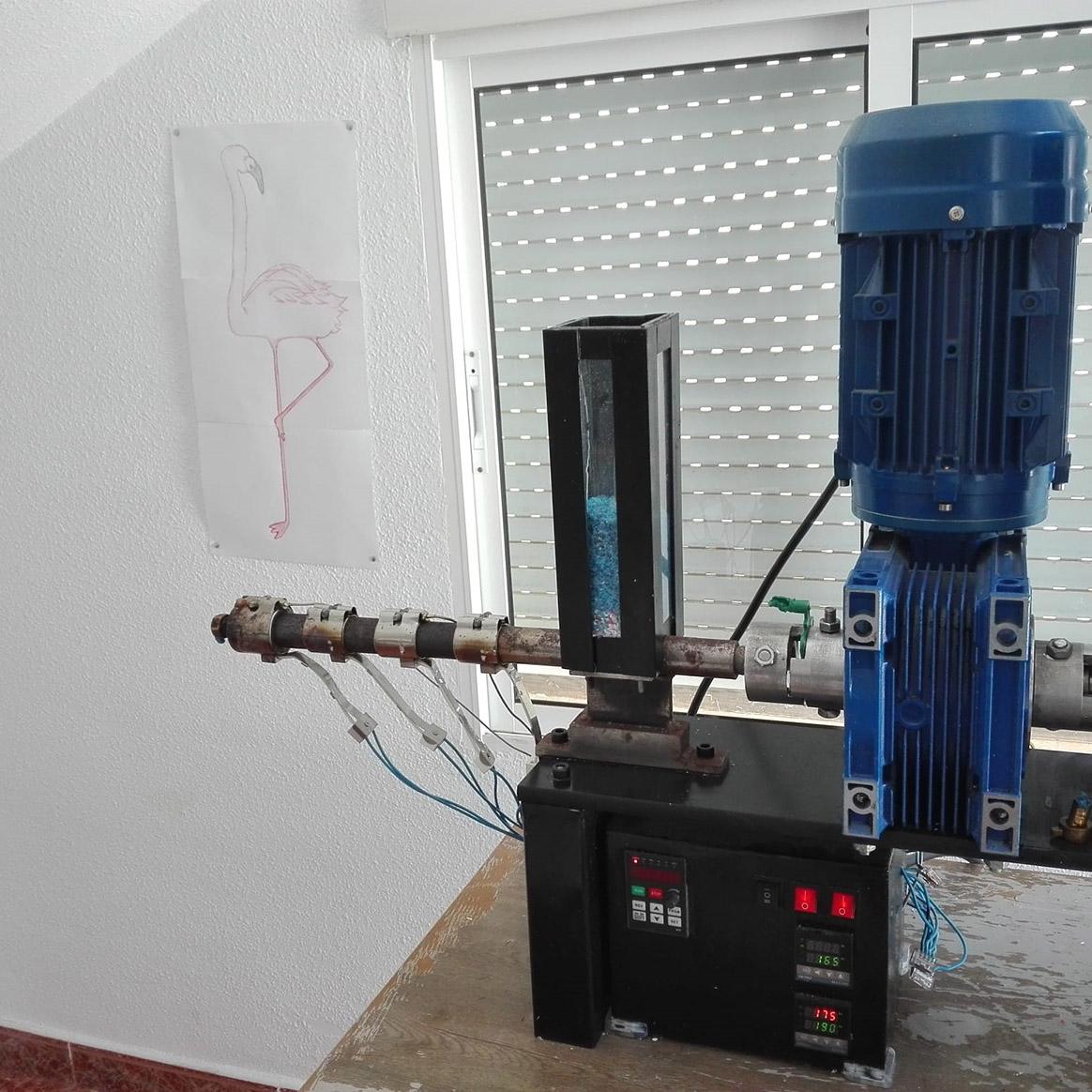

Crush the plastic that we are going to use (preferably HDPE) and fill extruder.

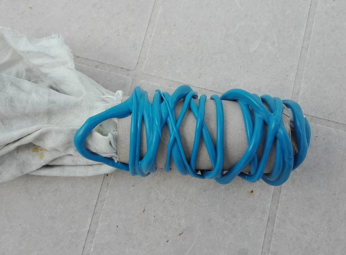

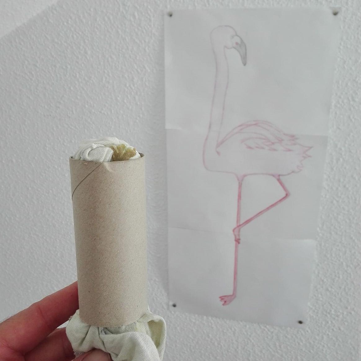

Step 2 - Pick some cardboard
Use cardboard of toilet paper or similar. Put some cloth inside.

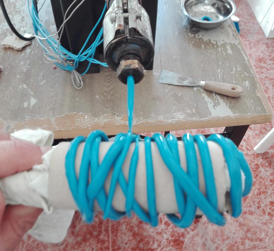

Step 3 - Rolling plastic
We will slowly roll the plastic on the cardboard. Change direction to make it resistant.

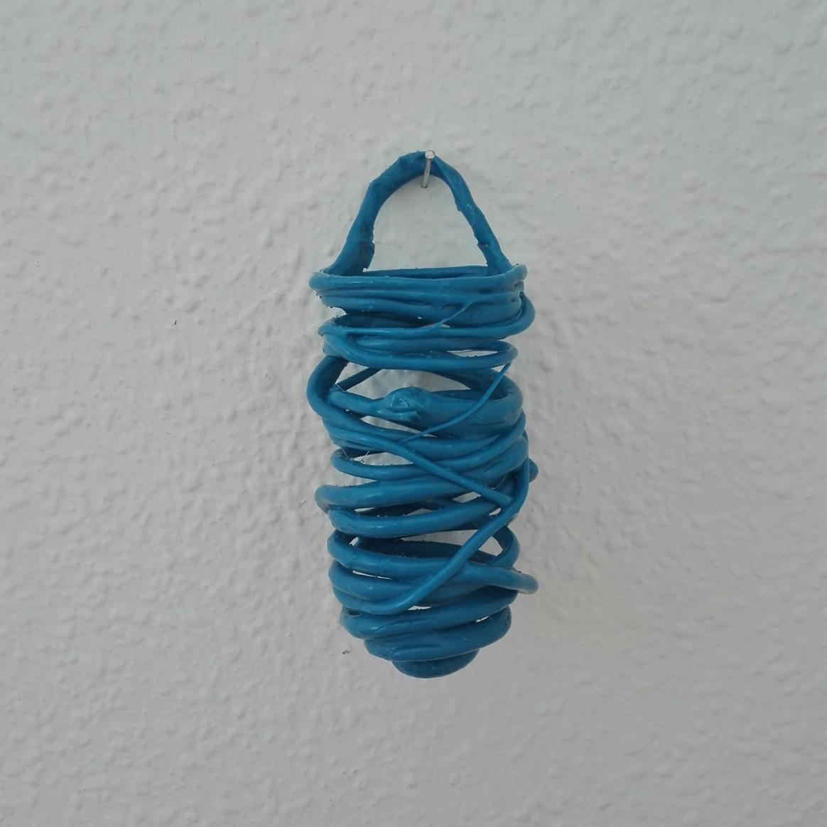

Step 4 - Demolding
We let it cool and take out the cardboard slowly.

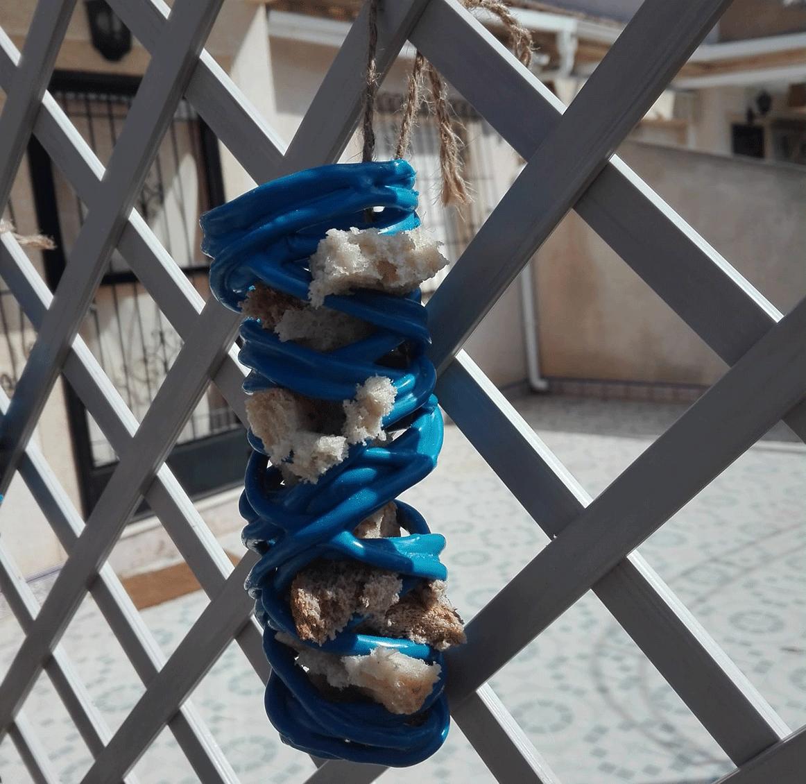

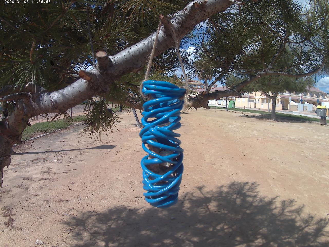

Step 5 - Feed it
Done! You have a bird feeder ready to use.
