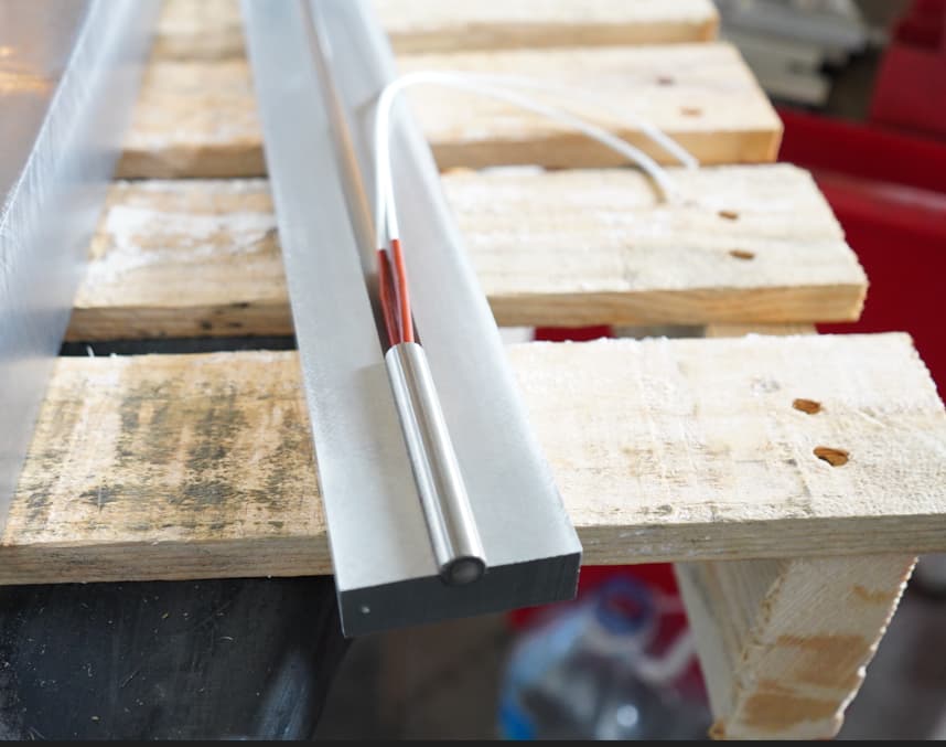

Cartridge Heater Back Mount Blocks -

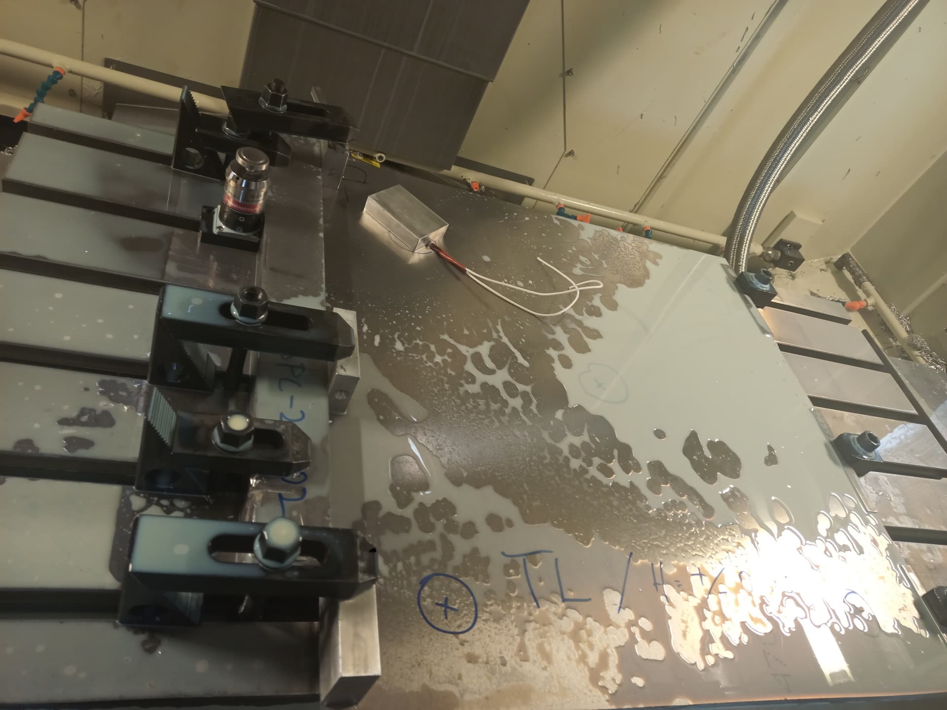

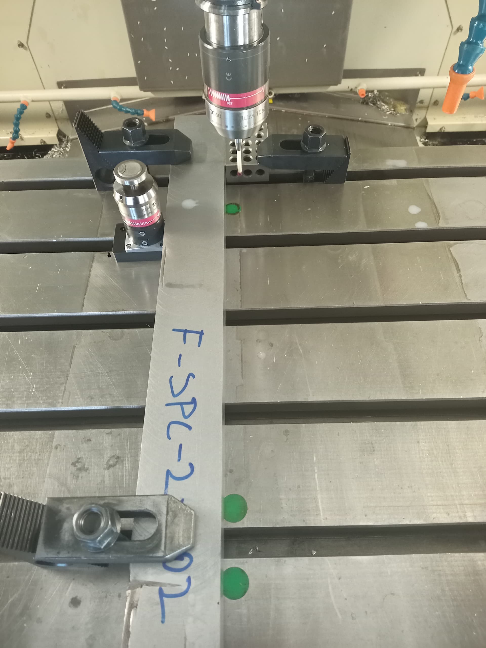

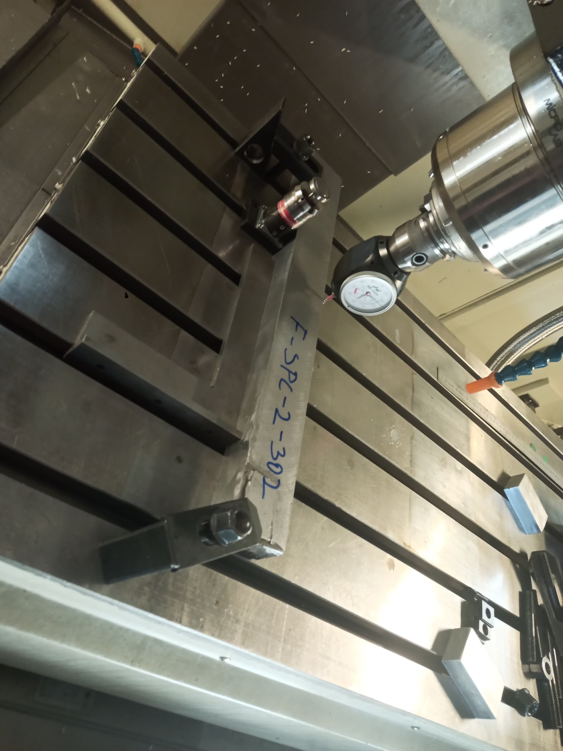

Variant Nr. 3 looks more promising, easy, precise & fast. Instead of drilling, we slot it just! The cartridge heater is being held in place with 20x60x80 blocks, on the heating plate.

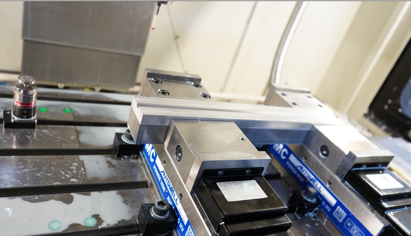

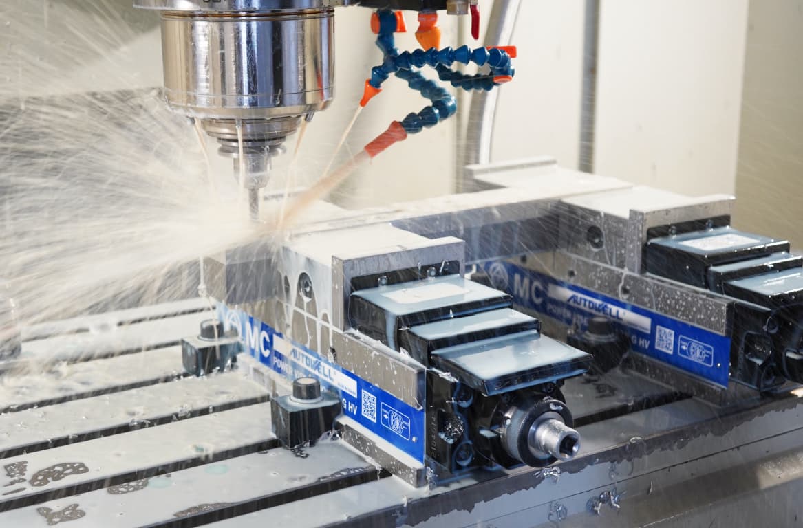

Here an example of milling a bar
CAM : https://a360.co/3ePvYzx - Roughing & finishing, perfect fit with gentle hammer kick, running S3500 & F3000.
More testing with IR camera in progress ![]()
