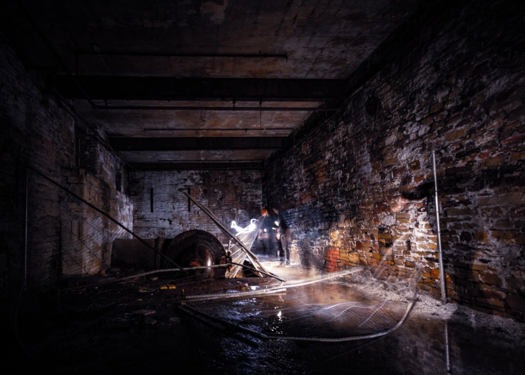

Interestingly, a (now derelict) mill near me (mentioned in this thread) installed a water turbine in 1920 – utilising a larger vertical fall of the river Colne than had previously been possible for thier old waterwheel. There is a recent photograph below (taken by some unrban explorers). The turbine produced 85 horsepower (63kW) which was a useful amount of power – but when you consider that it is about the same as available from a typical small (1.4 litre), normally aspirated, petrol car engine – then you can see why the relative capital cost of the earthworks, ducting, and turbine is now seen as excessive. However, if fossil fuel prices rise considerably, or people actually decide to stop burning coal/oil/gas to prevent a global catastophe, then the relative economics would certainly change.

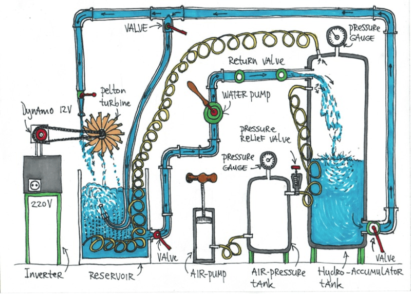

But please, don’t give up your dream of using the power from rainwater captured by roofs. As you say, @donald , there can be applications for micro power sources – and using static pressure from the head of water, for actuation, is always a possibility.
