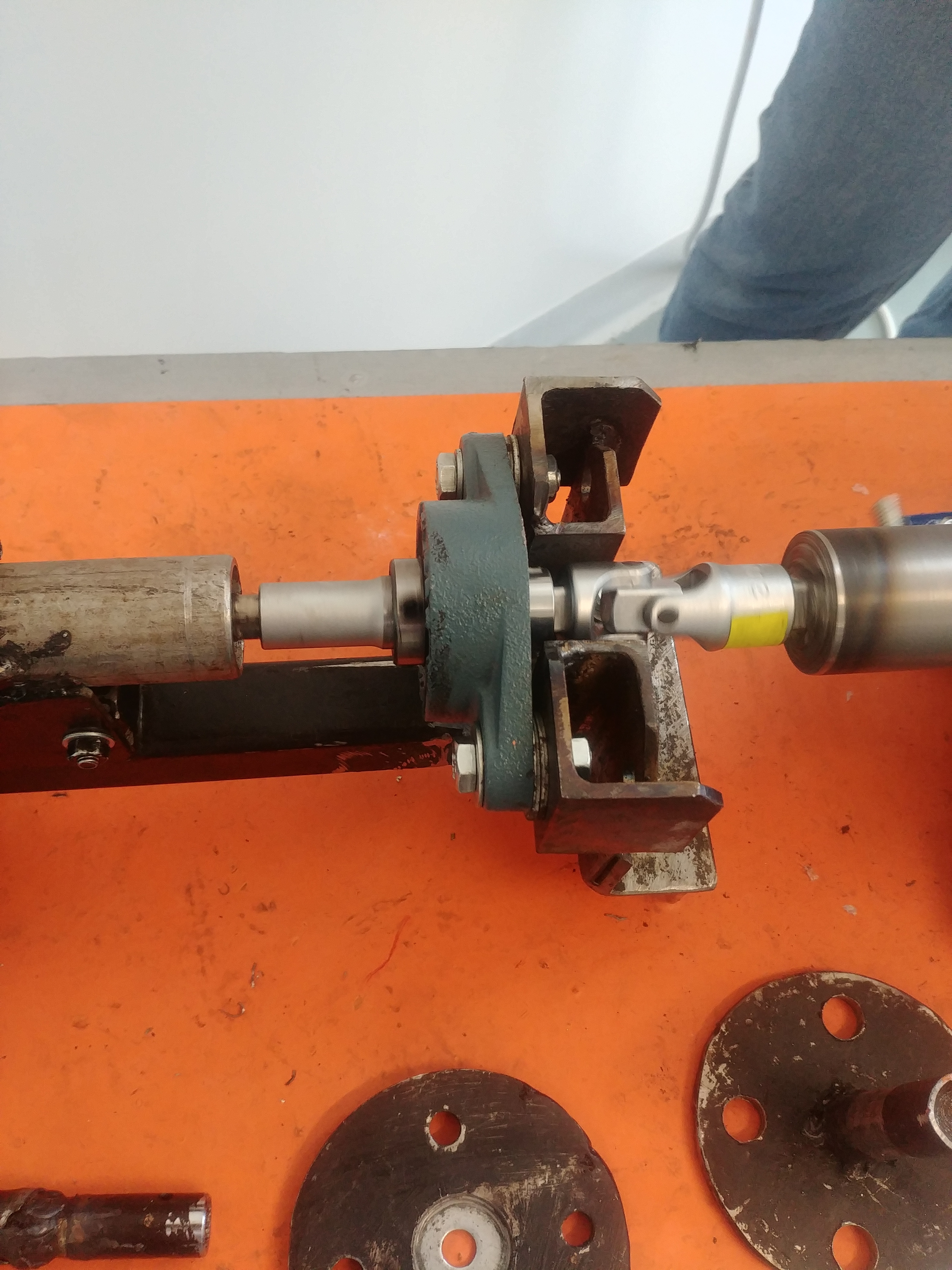

I have an issue with my extruder, which bend the bearing support in the first run.
I start the heaters as 230° for 3 heaters and 250° for the last one and wait for 15 min after it reach the temp, but the machine jamed and after adding a small quantity from PET.
After I opened the nozzle I found non melted plastic which create a jam and push the extruder to back which bend the bearing support.
So what is your analysis of the situation and how can we fix this problem?

Hi everybody,
I fix the machine adding a new strong support and flexible link between the motor and the bearing.
The motor is 1.5 HP with output 72 rpm
And I changed thermocable sensor location.
After 1 hour I will try to use the machine with new setting
HDPE plastic
Front heater is 300°
Back heater 280°
And I will inform you about the result
