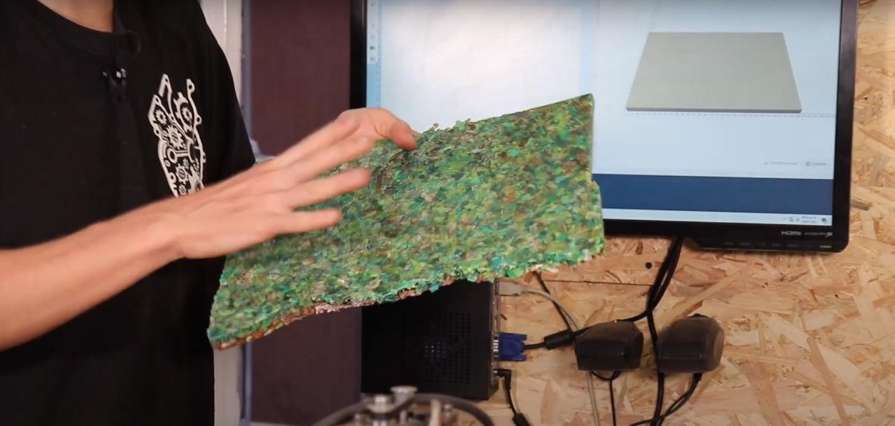

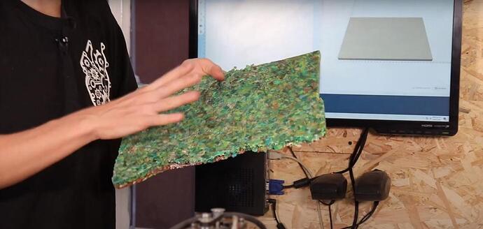

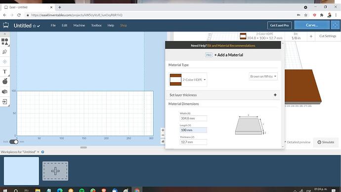

Step 1 - Measure the plastic sheet

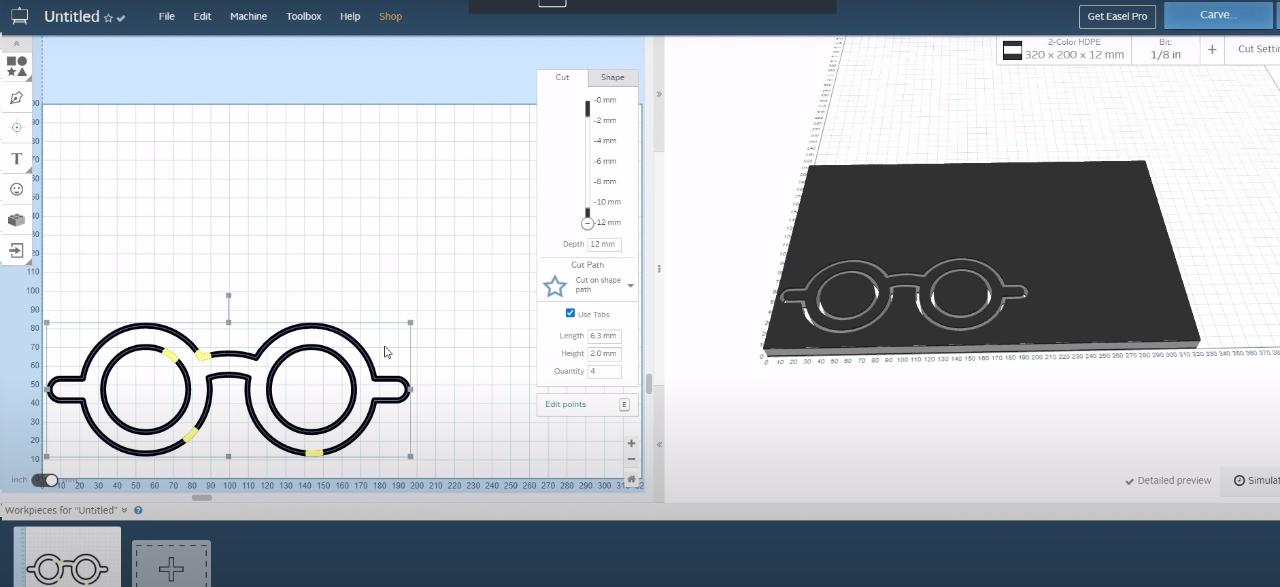

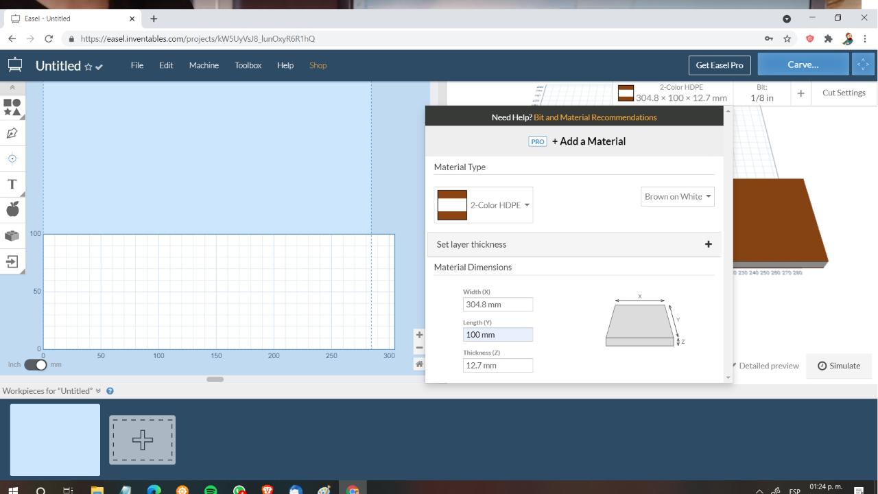

For this step we need to measure our plastic sheet: Height, Width and Thickness. Our X-Carve machine works with the CAM Software EASEL, for me, the easiest software for CNC milling out there.
The cool thing about Easel (https://easel.inventables.com/) is that you can "simulate" your actual material and THEY EVEN HAVE HDPE 2-Colors in their cutting material lists!!

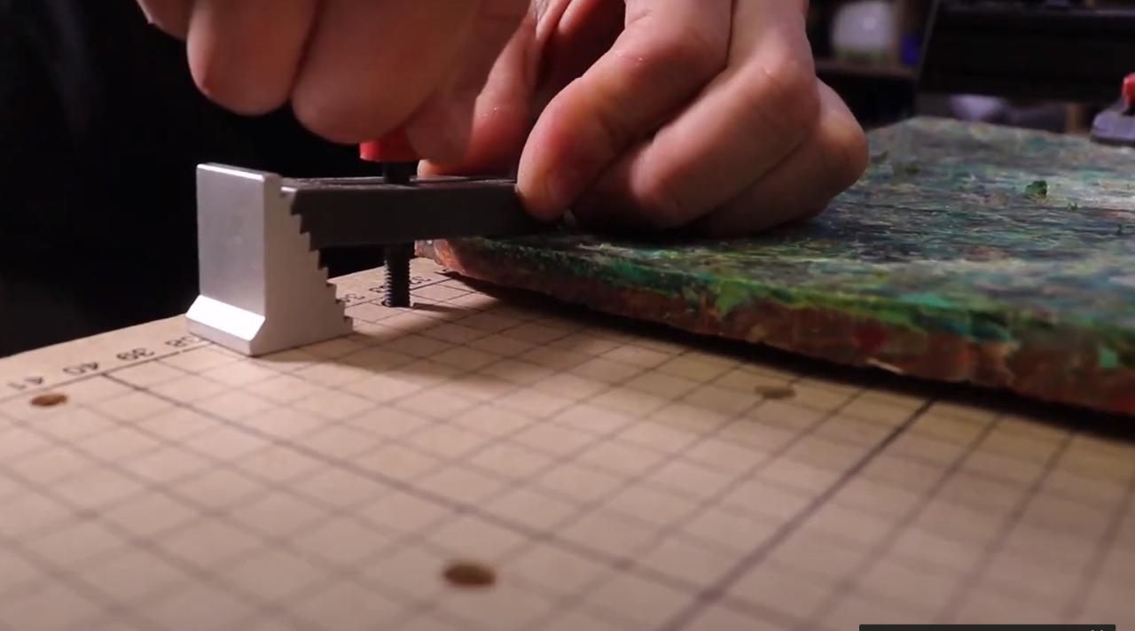

Step 2 - Secure sheet
Using the CNC clamps from the X-Carve, secure the sheet to the table,

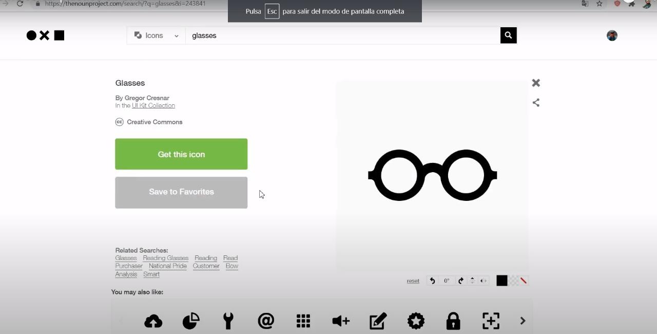

Step 3 - Choosing a file to cut
Now we go to our illustrator, such as Inkscape to design a vector file or download and open source one frome https://thenounproject.com/.
We download the SVG file, which is an open source vector format and import it to Easel.

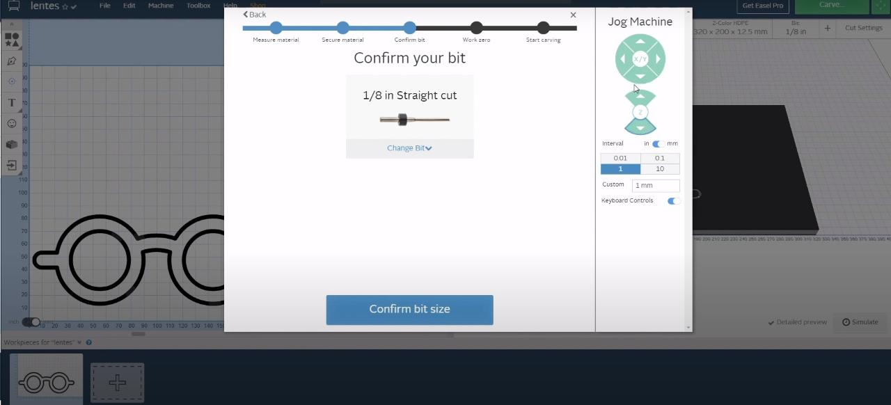

Step 4 - Follow the cutting Wizzard

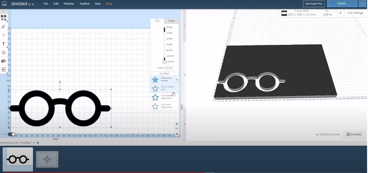

Now with the file we can choose the width we want to carve/cut and then we go to cut and start the wizzard:
We check that the sheet is fixed.

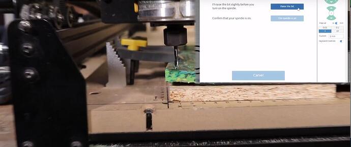

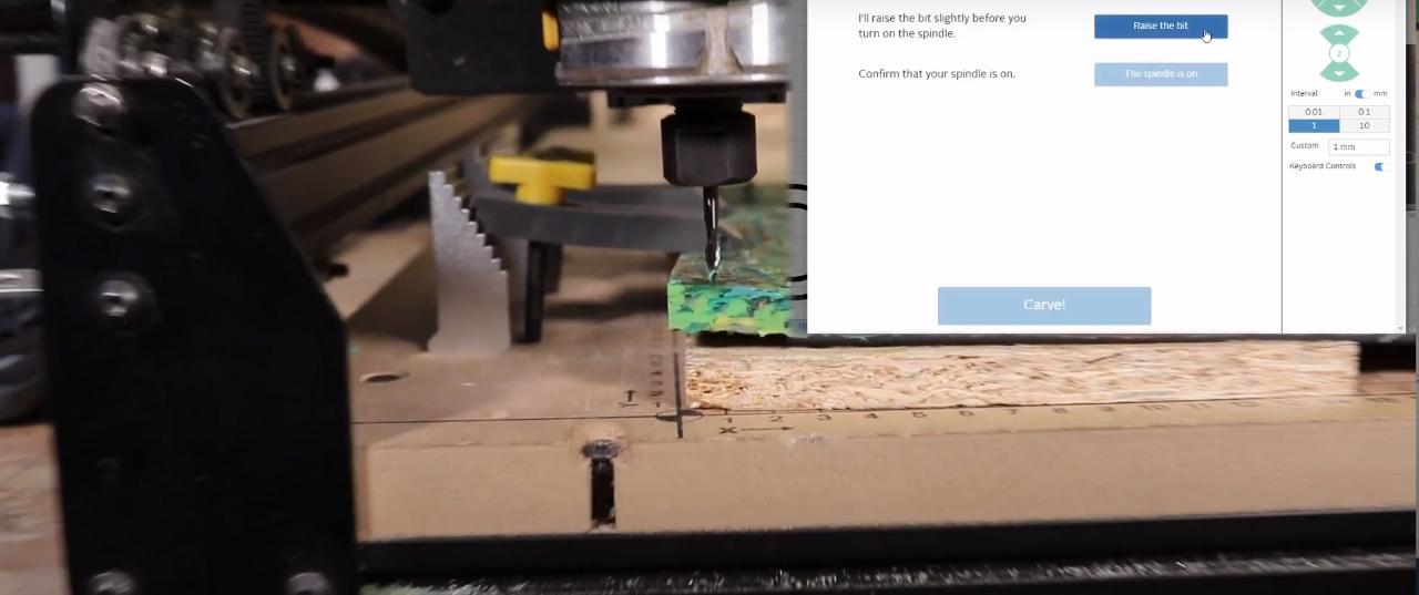

We also specify the cutting bit, we are using a 1/8 flat flute bit.
We tell the machine where the coordinate 0-0 is, which we always choose as the down left corner.
We raise the bit, turn on the Router!!!
AND PUM THE MAGIC BEGINS!!

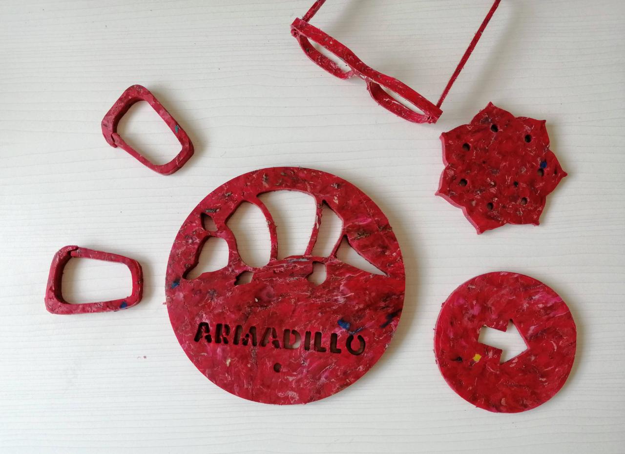

Step 5 - Post-production and show case
You take now your glasses or object and postprocess them and of course show it to your friends, family and so on.
