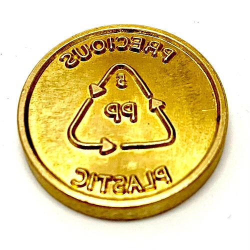

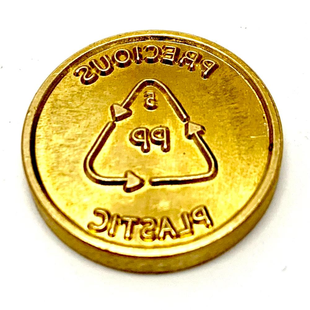

Advantages: *Implement the Precious Plastic plastic type coin directly into your mold. *Get a good embossing quality. *Never forget to tag the type of plastic on your product. *Save time.

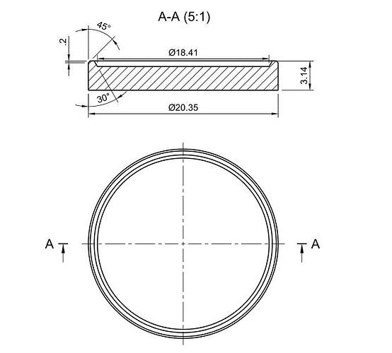

Step 1 - Order the coins & check
Visit the Precious Plastic bazar and search for "coins" or just hop here:
https://bazar.preciousplastic.com/extras/precious-plastic-stamps/

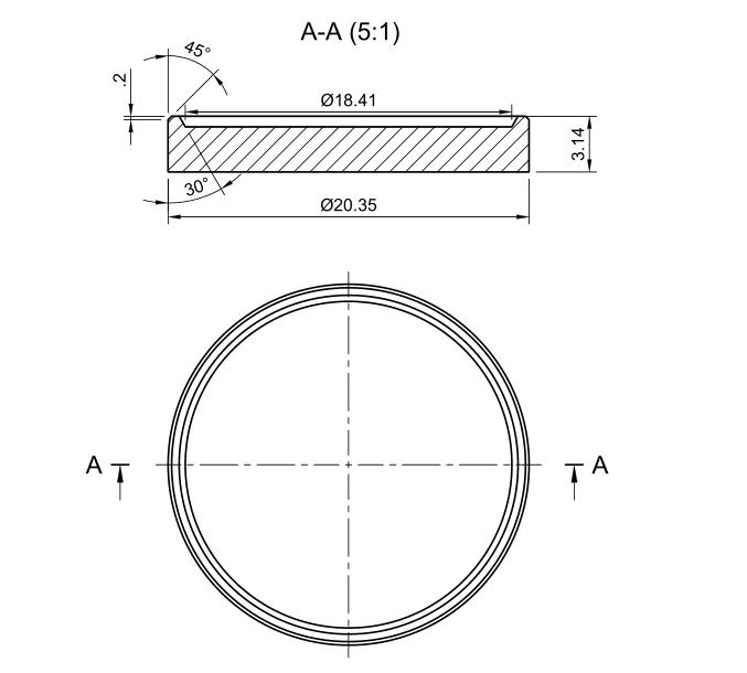

Check the dimensions.

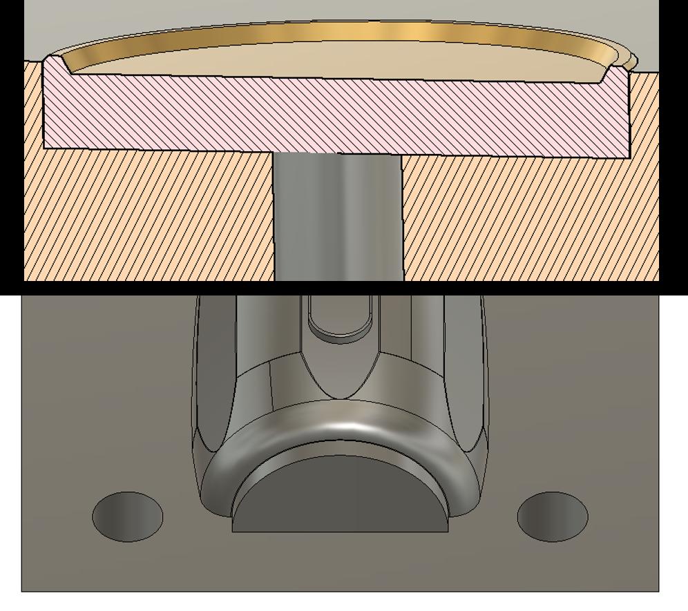

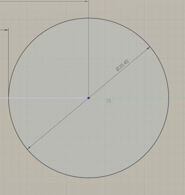

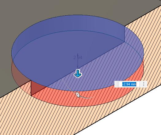

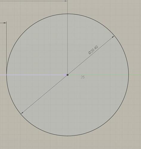

Step 2 - Design the pocket
Pocket-Diameter a bit bigger than the coin: 20,4mm (2.4mm)
Depth: 2,94mm (2.94mm)

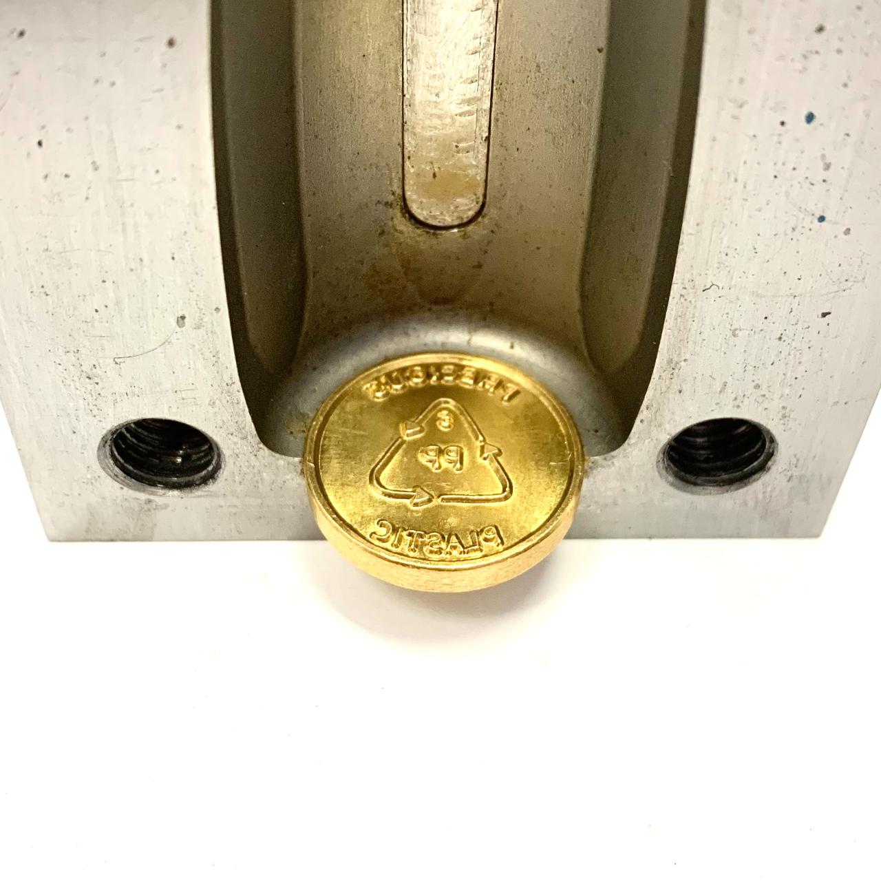

Make sure to add a drilling under the coin if the coin is not inserted at the mould parting surface.
You can also make the pocket-depth smaller, so you will see the ring of the coin better.

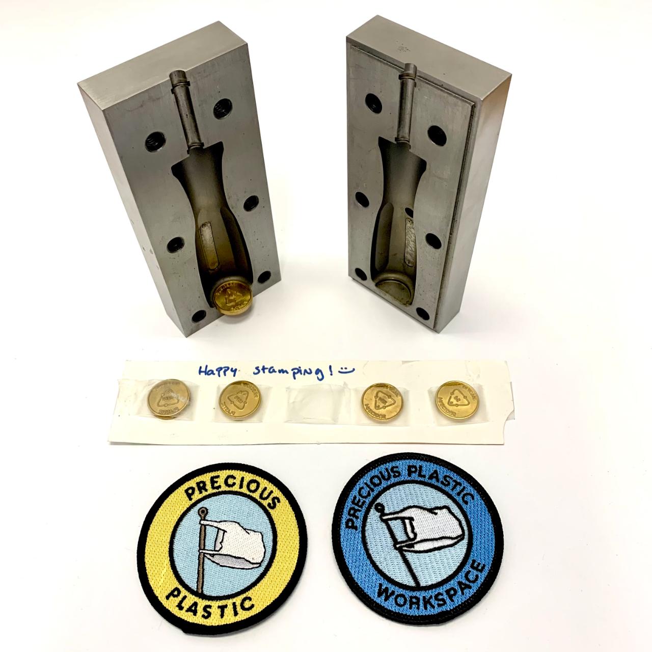

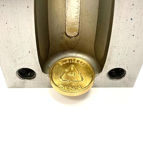

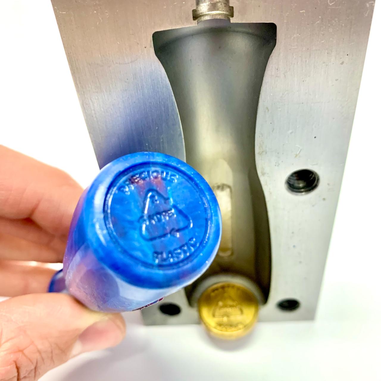

Step 3 - Insert & inject
Choose the correct plastic type coin, insert, produce & let the part in the mould cool down.
