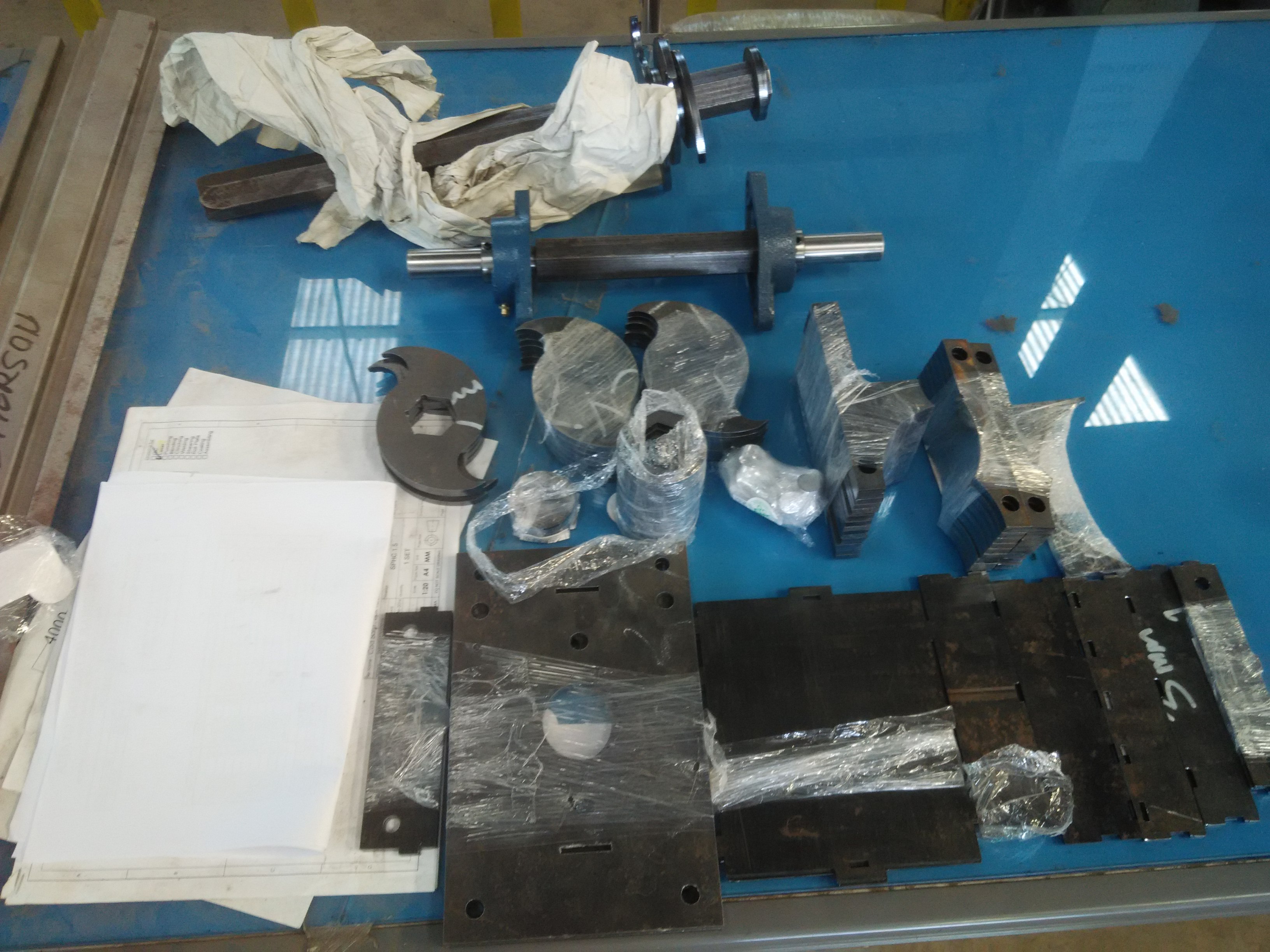

Im Ramdhan, currently making Shredder v2.0
using steel (not stainless) as basic material.
here is some progress photos and videos i made.
next time i’ll upload better quality.

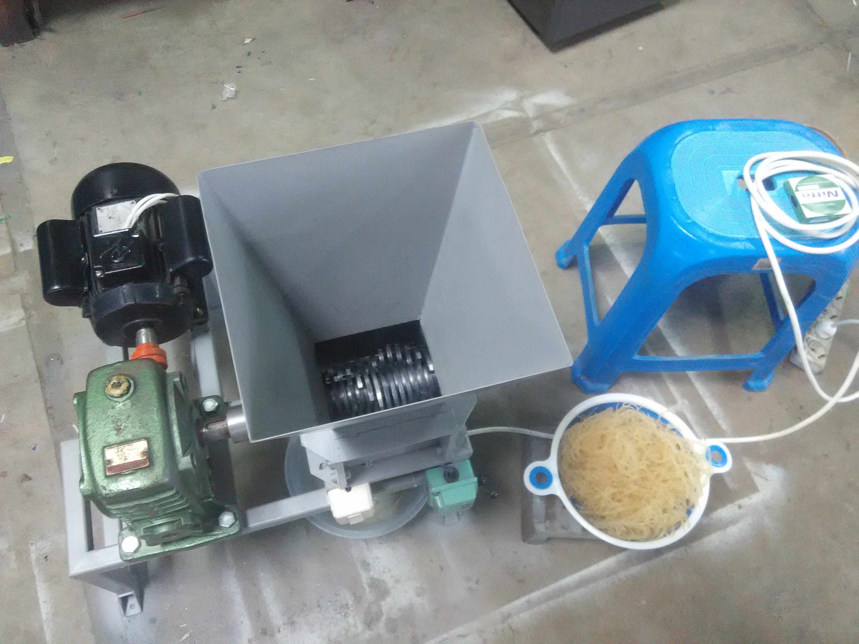

hi everyone,
i already finish shredder machine.
i also test it to shred seaweed. turns out to works well, very good actually. since its soft the production reach around 100kg/hr.
very exciting to know other people around recycling plastic,
and… thank you for the reference, so hard finding stainless steel sheet in my town, maybe i’ll use your customization ;D
