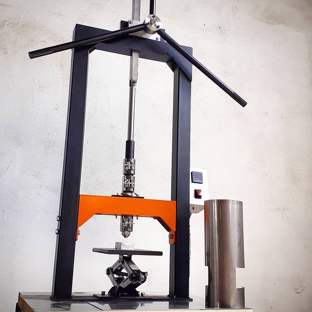

@cgoflyn That is a very clean design. I like how you simplified the drive gear bracket. A couple of additional ideas:
Since these are likely to be used indoors, you might enclose the top section of the frame with sheet metal, add a fan and an exhaust interface for flexible ducting (clothes dryer vent type) to create a fume hood. You might have to experiment a bit but I think if it stops 10 cm above the top of the tube, there should still be enough access to load the injector but still collect the fumes. This should make education applications and indoor demonstrations more likely to get approved.
In using my small unit, I tend to preload the injector piston (with the nozzle blocked off) to apply compression during the heating phase. This seems to compact the plastic, and reduce air/voids. When I see plastic starting to ooze through the piston clearance, I’m generally ready to inject. Maybe a way to maintain preload might be useful for your machine (this would make adding a press feature in the future easier). In my shop I would just use a simple spring or strap but you probably have something more professional.
Since you have lots of torque margin, perhaps you can offer a range of piston diameters for the people that may want high capacity.
You mentioned the band heaters, You probably have it in your wiring diagram, but the drive mechanism and the frame probably should be well grounded in case one of the heaters fails in a bad way.
Great job, this is a very professional design that opens the door for a lot of options and functions.
hey there,
after a dozen hours of testing and producing almost 10 of these:
I swapped the handle against 3 x 25 mm sticks, 70 cm long. This gives so much ease and power, I think it’s still double the power needed to extrude. Some plastic was so easy to extrude by kicking the stick just; at least for simple molds.
Then I removed the 4 6mm thick enforcement plates from the middle and top bar. Those 3mm thick tubings were more than enough.
I still have to fine tune hopper and electronics but I consider this as first real release candidate. It’s the most pleasant injection I’ve ever used.
Some stats :
– build with heavy duty machines: lathe, CNC, pro-welder (unbeatable Fronius 2200) but i think that could be done without if you are really creative
– 60 minutes CNC, 1 hour lathe, 30 minutes welding and lots of time for drilling, grinding, etc…
– it took 2.5 days for 5 machines for 2 people. 5 days full-time to build one alone the first time
– material bill : 250 Euro (we have low priced suppliers) & 30 – 50 Euro for consumables (everything : CNC, lathe, electricity, ink, nuts, bolts …)
– bazaar price currently 610 but I think we increase; it’s just too much work after all. I think doing this even better would justify 800 Euro, considering that similar simple arbor presses are at 1300 Euro +
– 38 Kg shipping, 70 Euro within Europe (if you are part of a network)
– 25 mm by 24 cm volume
– Shipping size: 110 cm 55 cm x 30 cm

@virginiamanzano:
gear here , rack here but be advised that a gear of size ‘module – 2’ is fully sufficient. also you have to machine down the shoulder on the gear, its hardened steel and requires a solid lathe.
If you are running into packaging height limits, I wonder if you could get away with using angle (or channel) for the top cross bar and mount the gear box through the vertical face. I would guess it is hard to put more than a ton of injection force on that top bar.
@lagrenouille, sorry but as almost dozen of other answers got deleted: here again:
yes, building the transmission housing beneath the upper bar is really tempting, unfortunately, things won’t fit well with that, 24 cm by 25 mm was the max cylinder. i already exceed my standard parcel dimensions with the now 96 cm. taller esfrica, no but inspired by, like possibly a few other million on this planet, @s2019 is one of them too
Wow, That looks great. I really like how it maintained the compact, benchtop footprint.
A small note: I think if you add a couple of large washers on top of the yellow cross bar, you may be able to take advantage of thermal contact resistance and reduce the heat lost to the cross bar a little.
