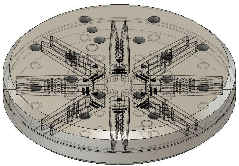

Empower your community to make a sustainable impact with the Precious Plastic Clothes Peg Mould. Designed for injection moulding with recycled polypropylene (PP), this mould produces 8 durable pegs in a single cycle. The mould design is open-source, allowing you to download the 3D files and blueprints, add your own logo and text, and CNC mill it for replication within the Precious Plastic community.
Key Features:
- Recycled Polypropylene: Use PP, a durable and flexible material, ideal for clothes pegs designed to withstand repeated bending.
- Open-Source Design: Access the 3D files and blueprints, customize with your branding, and replicate the mould for wider community use.
- Recycling Code Embossing: One side of the peg features the PP recycling code (), promoting recycling awareness and eco-friendly practices.
- Precious Plastic Branding: The other side of the peg is customized with "Precious Plastic," strengthening the connection to your community's mission.

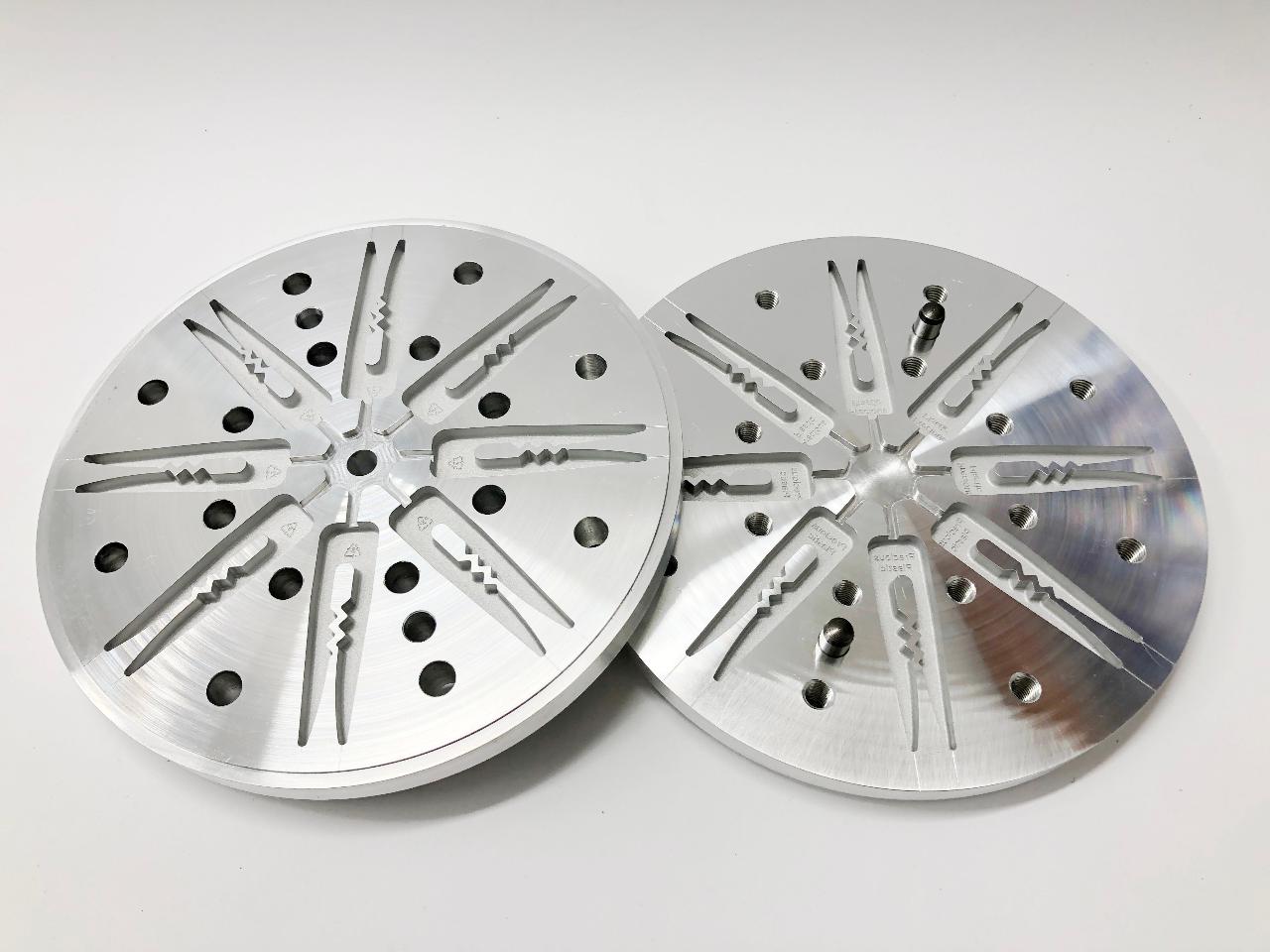

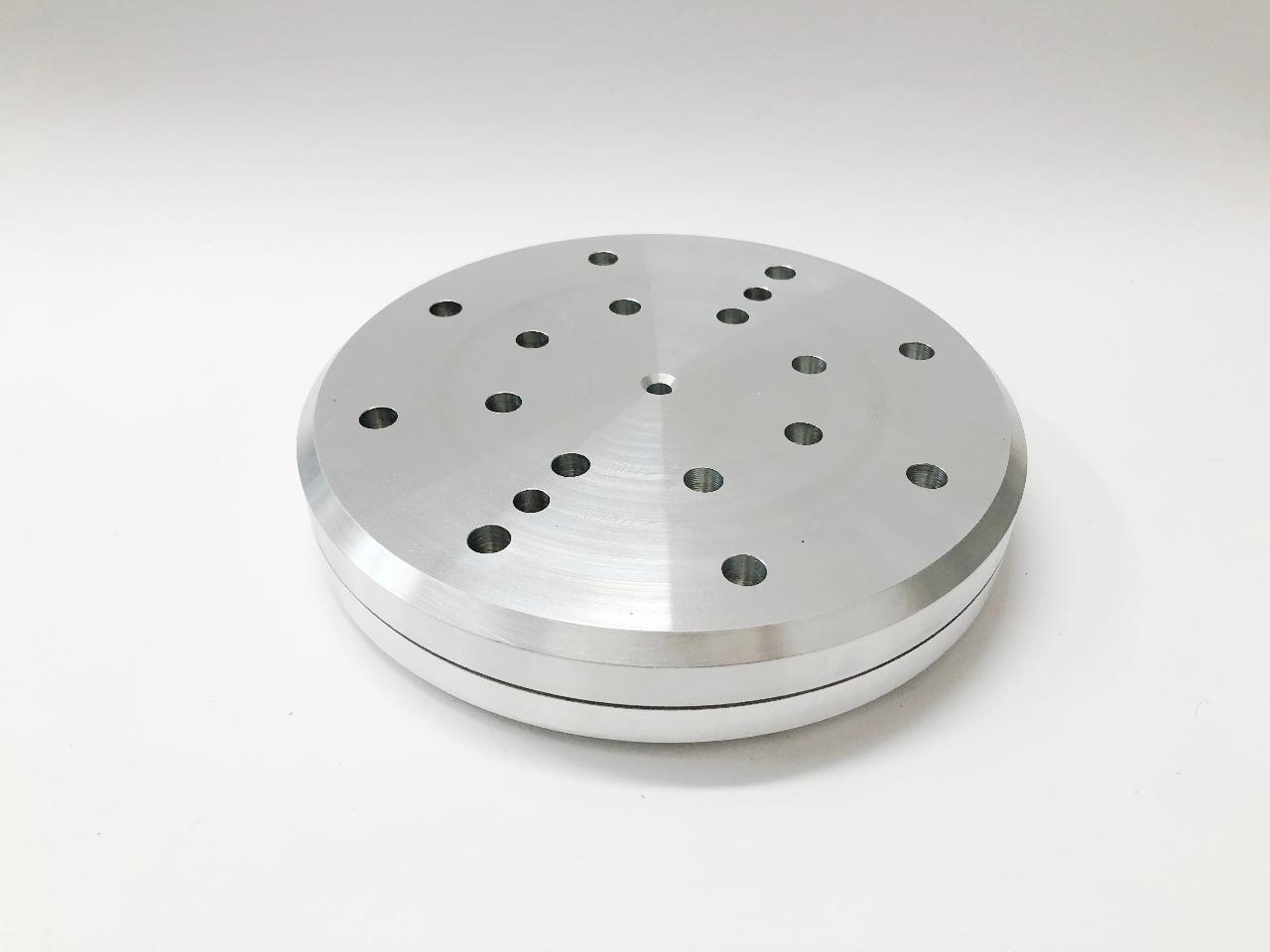

Step 1 - Mill the Mould
In the provided CAD files, you will find the top and bottom part of the mould. Download the files and mill the mould.
If you are using a plastic other than polypropylene, you will have to change the recycling logo accordingly, as this mould was primarily made for PP.

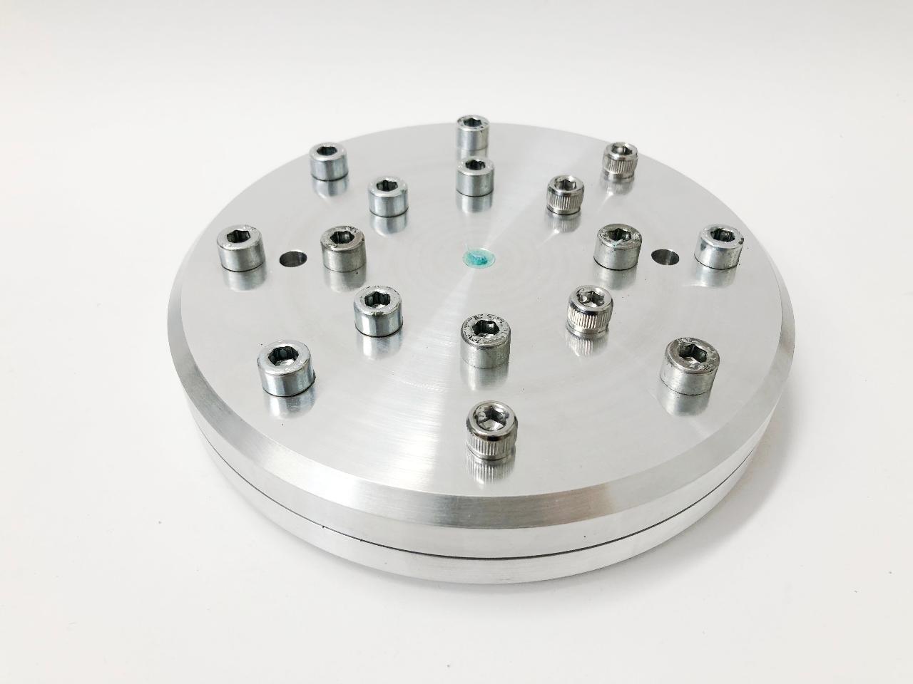

You will also need 16 M8x25 screws.

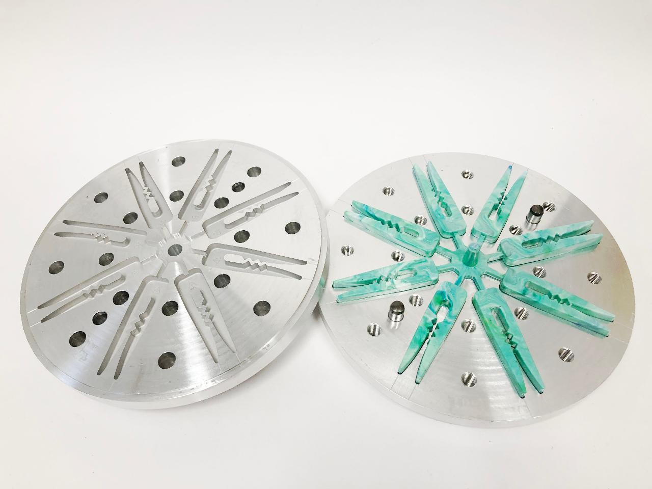

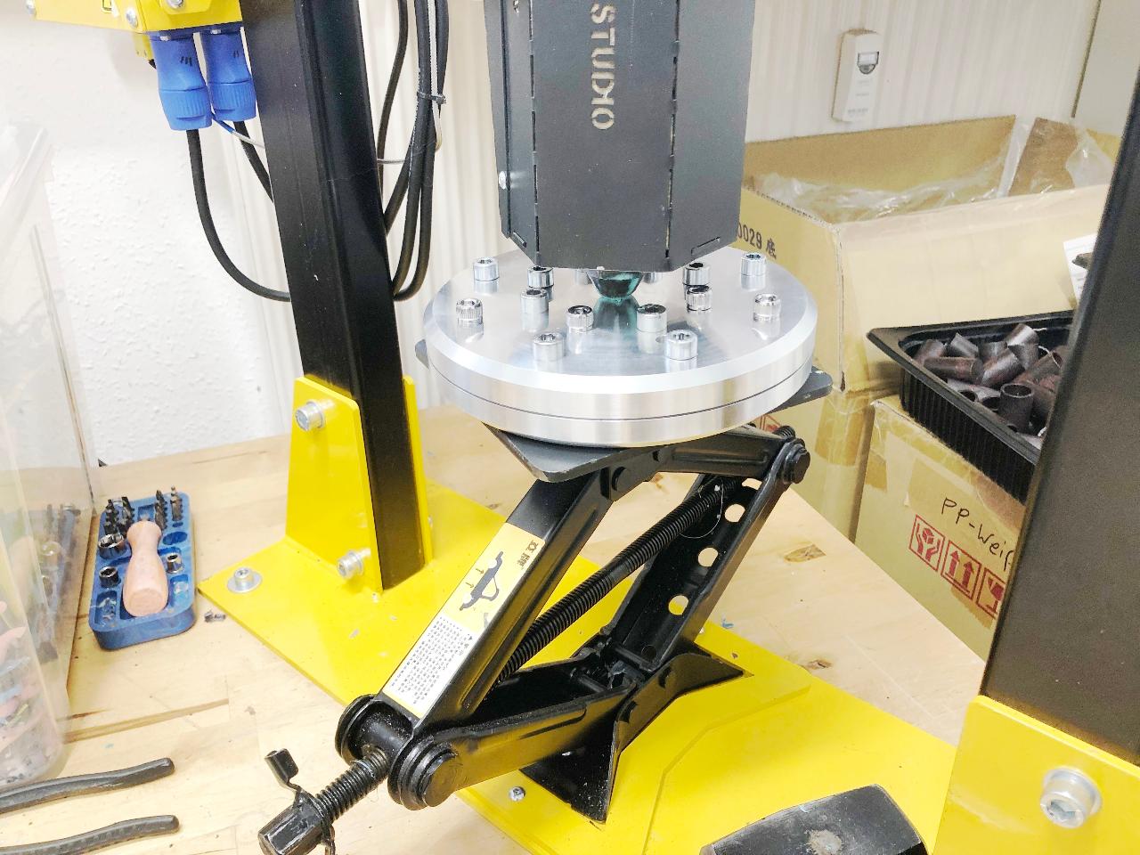

Step 2 - Inject

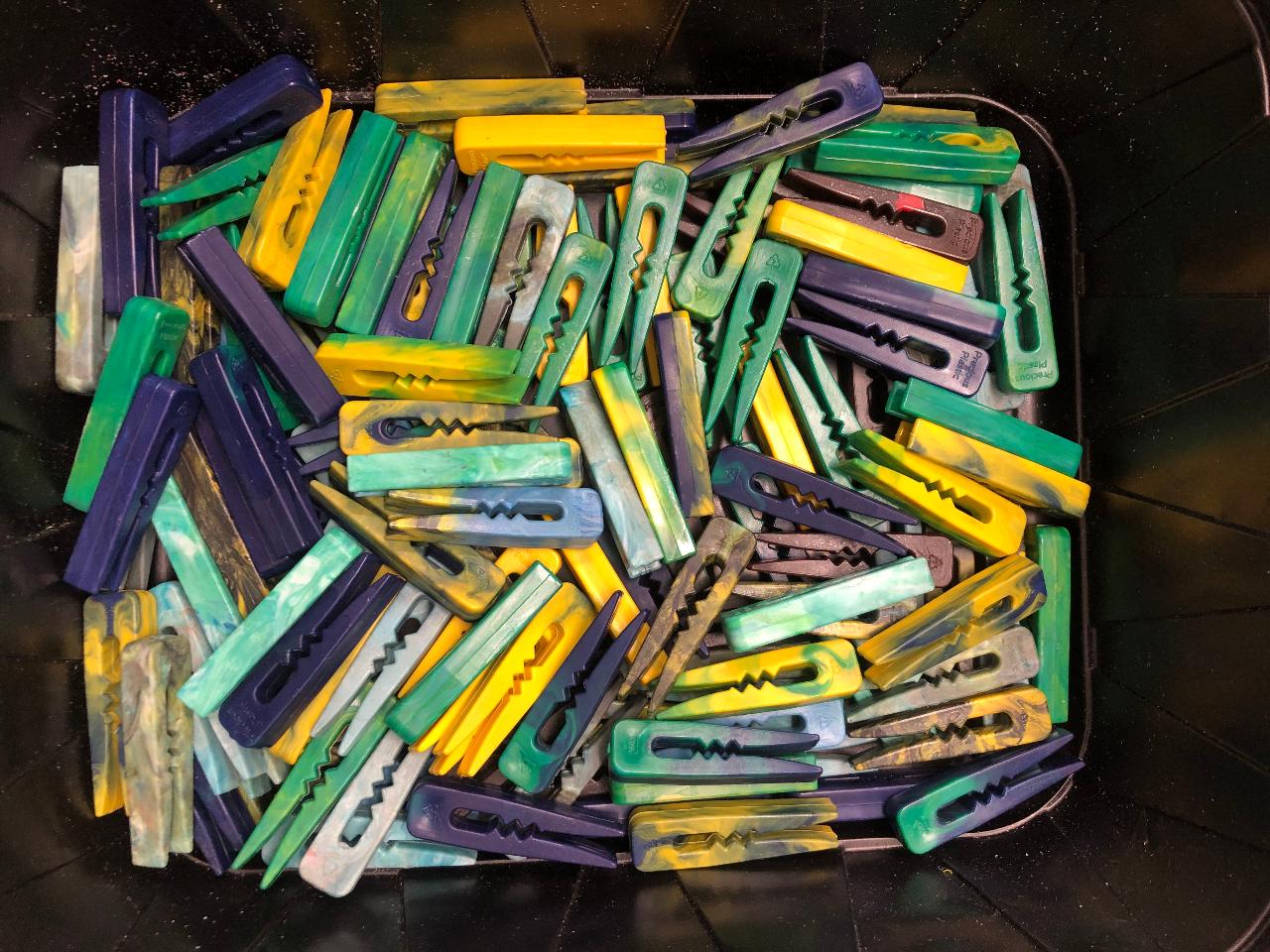

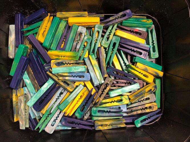

Assemble the mould and inject. Each injection should give you eight pegs.
One peg weighs 5.5g, all pegs plus sprue and runners about 50g.

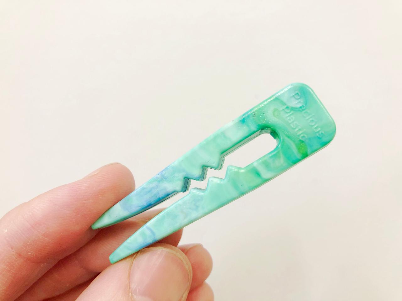

Step 3 - Disassembling and afterwork
Disassemble the mould after injection. If any pegs are stuck in the mould, use a flat tool to carefully lift it out. Trim off any excess plastic and use a blowtorch to soften the edges.
