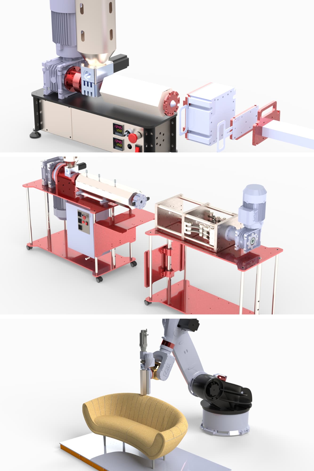

Extruders
We are happy to share with you the latest extruder designs, simple robust and versatile, unlocking new applications for small enterprises and educational settings.
Scaling Up: Lydia-v3 extruders meet industrial robots
Beyond research and development, updates for large-scale 3D printing highlight the adoption of Lydia-v3 extruders for ABB and Kuga robots. Firmware interfaces Omron inverters and Modbus temperature controllers.

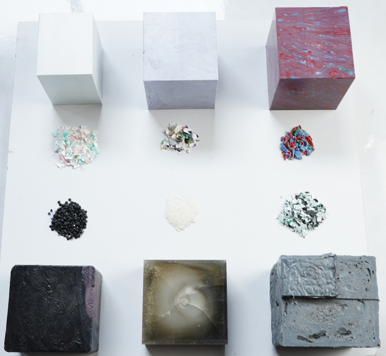

Beams: Enhancing Small Extruders for raw stock blocks
Exploring the limits of small extruders has led to innovations in producing larger blocks providing raw stock. The introduction of a spring-loaded plunger has effectively eliminated air voids.

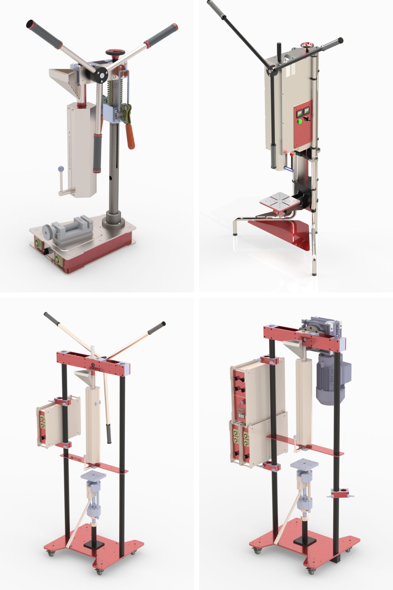

Injectors
New Designs
Katbot - This design reflects the past six years of experience, building injection machines for educational contexts and small enterprises. We are proud to say there’s nothing to add or take away ![]()

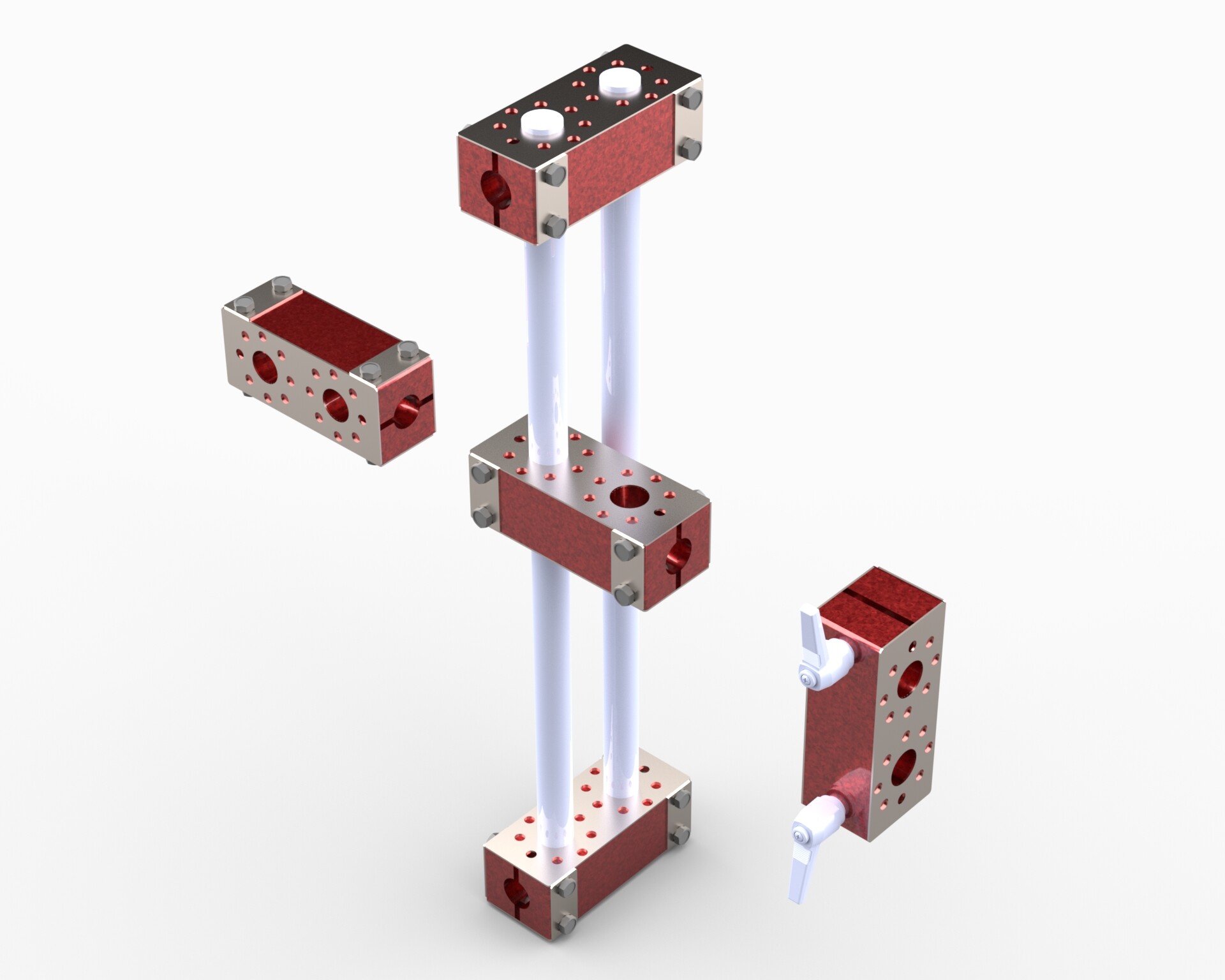

Elena - Elena became now a platform of design building blocks enabling reuse of existing components, such as sheet presses and extruders. Additionally, all known issues have been resolved, introducing a toggle clamp and a shutoff valve, enabling a predictable, repeatable and clean process. The designs made finally their way into the workshops of small enterprises.

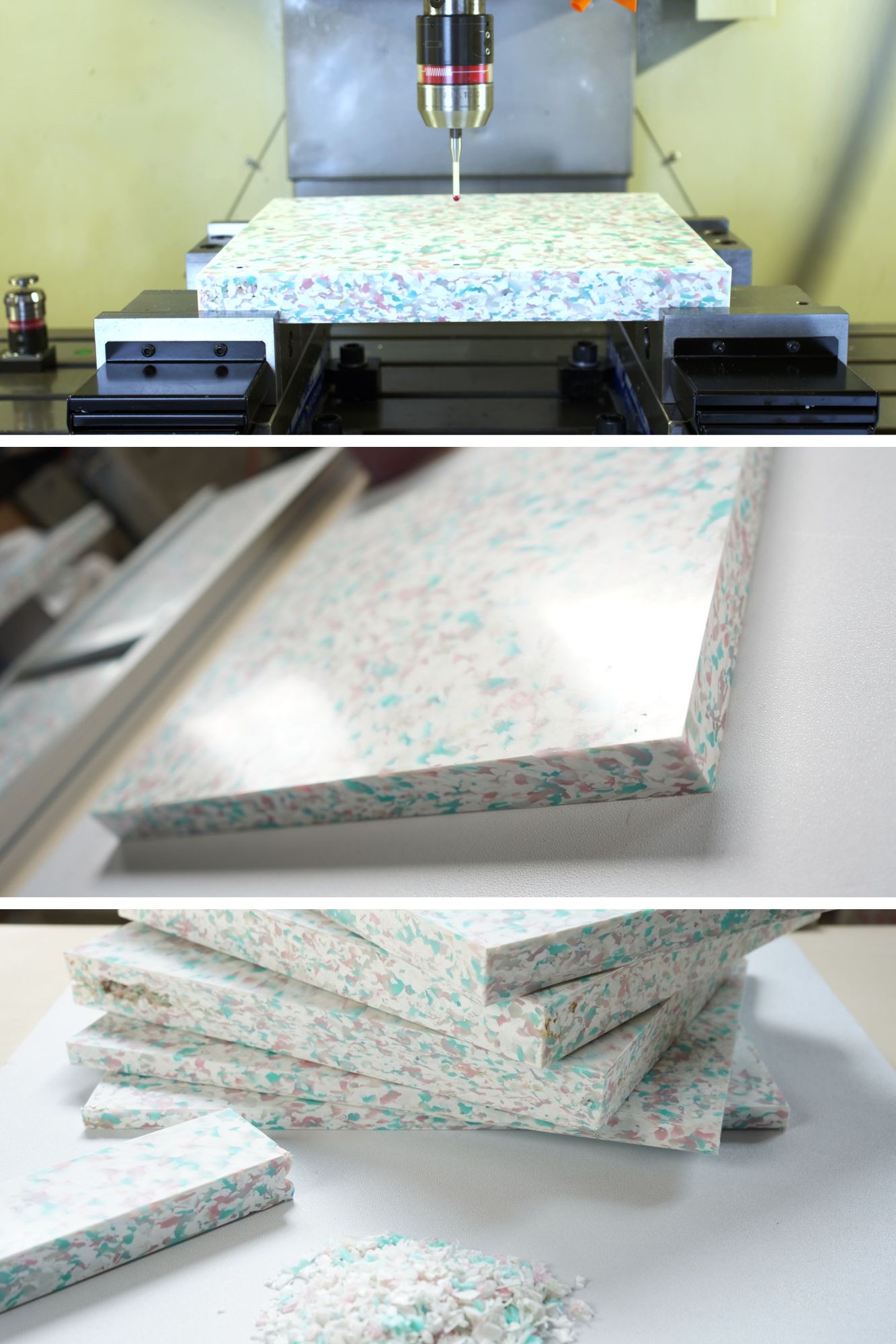

Quality & Performance
We tested post industrial waste (PP, MDPE and clean HDPE) and are very satisfied about the results. We also discovered new techniques, employing a die to overcome artefacts coming with shrinkage.
- flatness : within 1mm tolerances
- surface : impeccable, in particular for clean HDPE
- consistency : literally no air voids when using dies
10mm Sheets
This presents the more productive size. It takes ~45-60 minutes for heating and 3-4 hours cooling, requiring a mould of 15mm and a die of 5mm. Since less plastic needs to be penetrated, a moderate temperature can be used to retain texture properties as speckle like patterns.
20mm Sheets
~90-120 minutes for heating and 4-6 hours cooling, requiring a mould of 30mm and a die of 10mm.
30mm Sheets
~120-140 minutes for heating and 6-8 hours cooling, requiring a mould of 40mm and a die of 10mm. 30mm blocks enable access to wider applications such as mechanical and structural components.
40mm Sheets
Considerably more challanging and care taking neeed, ~140-160 minutes for heating and 6-8 hours cooling, requiring a mould of 55mm and a die of 15mm as well reheating the sheet during the die press stage near the melt point.

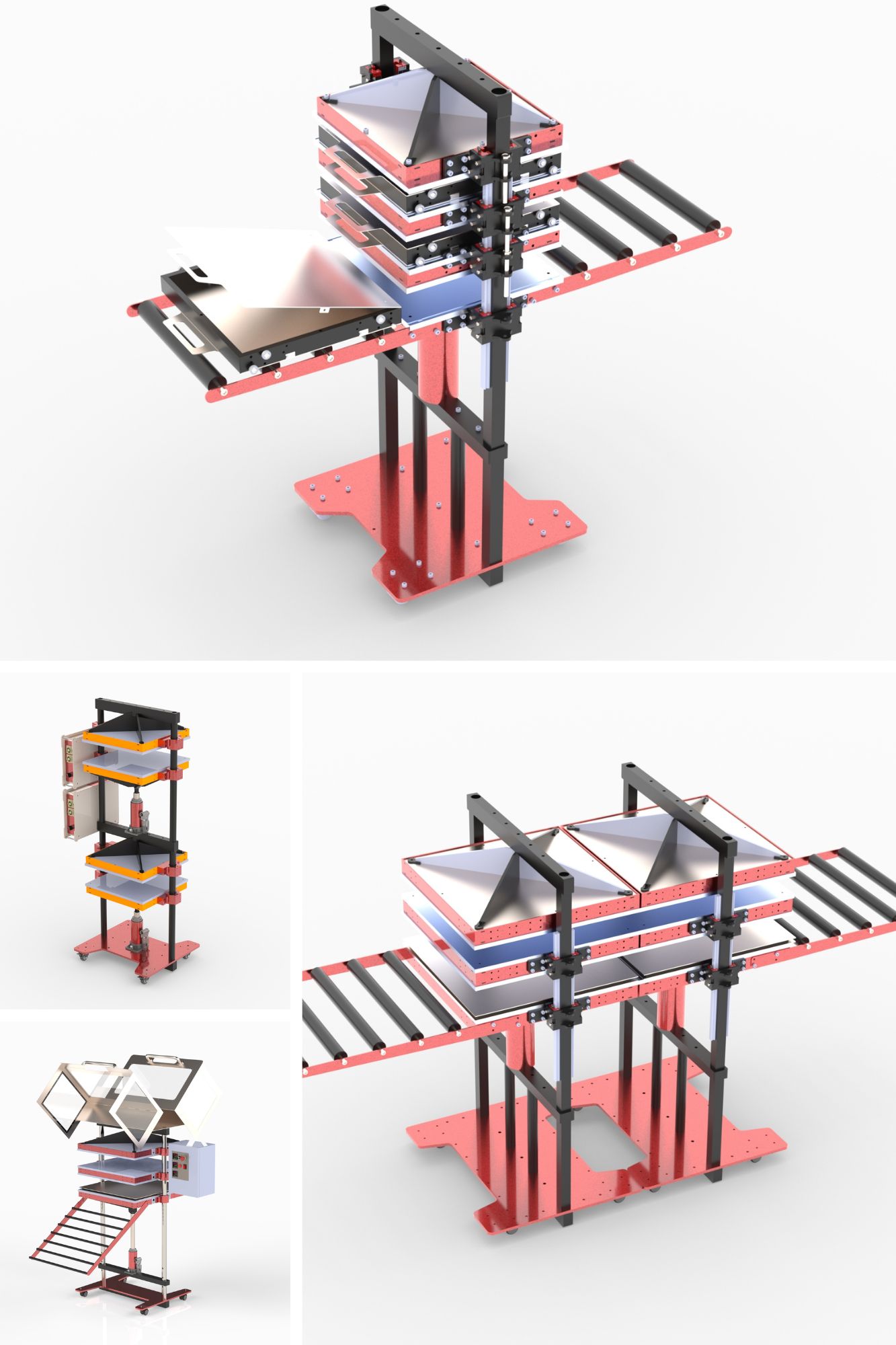

Sheetpress Designs
We are happy to share with you the latest sheetpress designs, addressing structural & quality issues. We’ve enhanced safety, flexibility, compactness, modularity, and accessibility, ensuring a smooth and clean process for small enterprises and educational settings.
Cassandra - 45 cm (3D Preview)
We recommend this version for Fablabs, schools and research institutions for its maximized safety. As all variants, the press can be configured for up to 4 individual heat and/or cooling zones. A fully maxed out mould weights up to 18kg.
Cassandra - 65 cm (3D Preview)
This variant is optimized for production scenarios, enabling an interlocked setup for 1.2m x 60cm sheets.

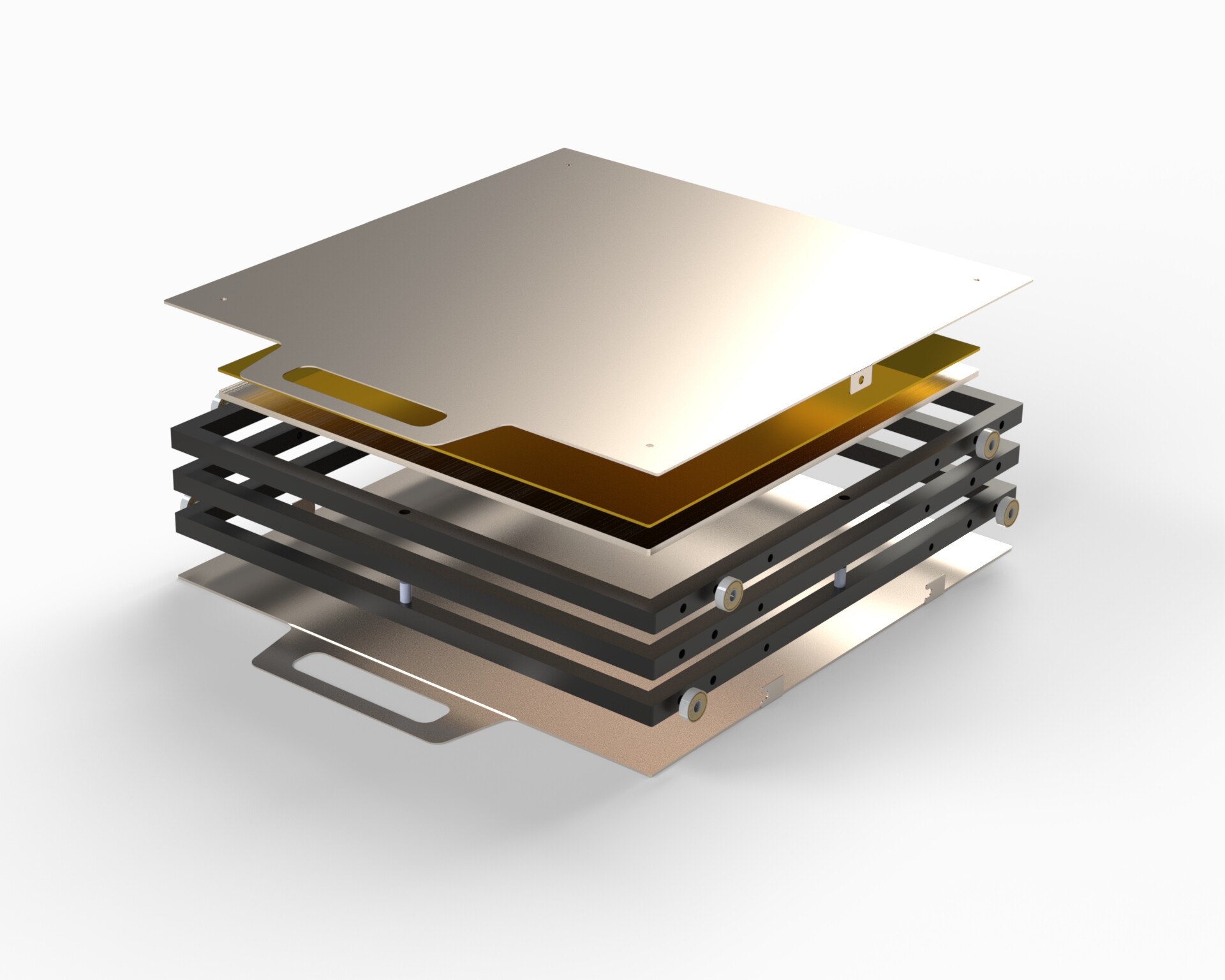

Moulds
We introduced a new mould design that allows for a clean, safe and repeatable process. The mould is height adjustable and rollers prevent damage of the heat press plate but also position the mould inside the sheetpress always at the same place. Outer protection sheets snap onto the mould frame to avoid plastic from falling out.
