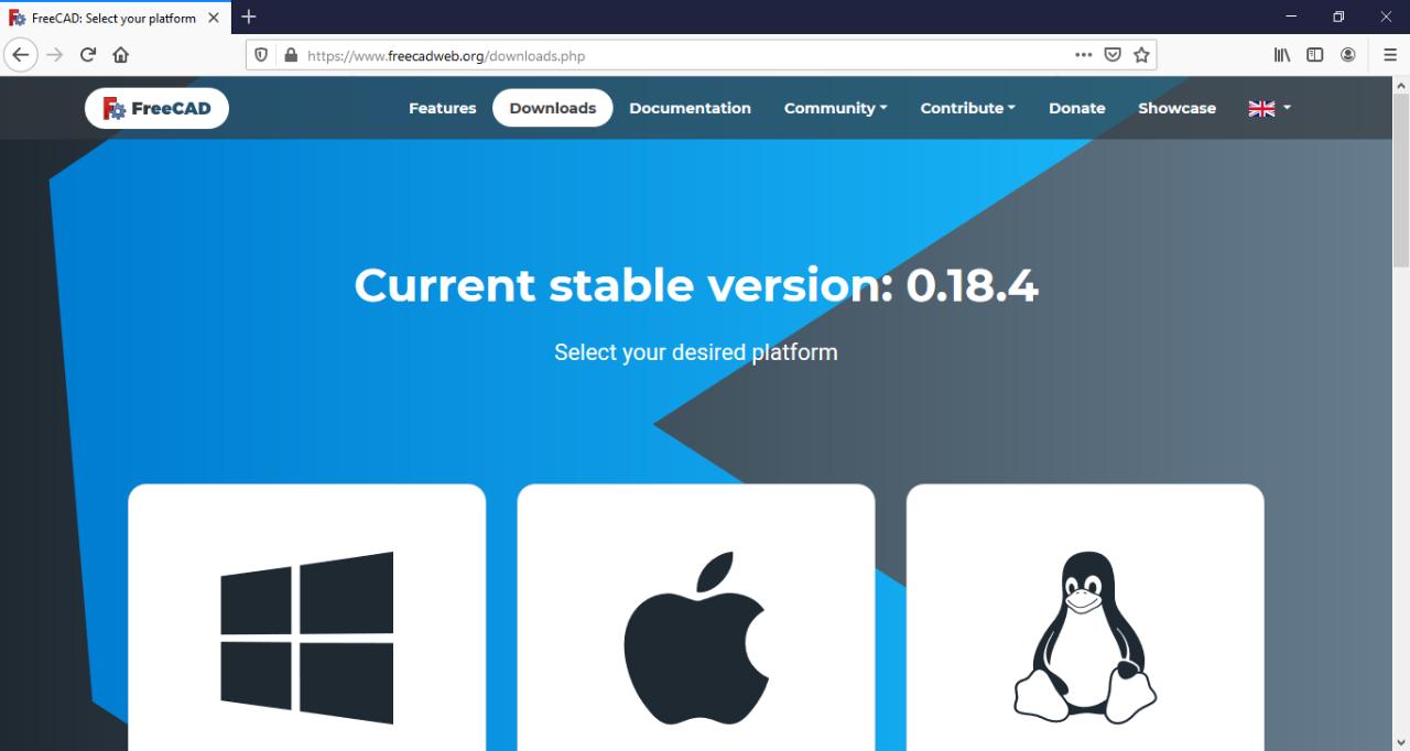

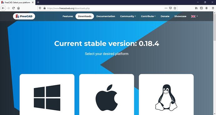

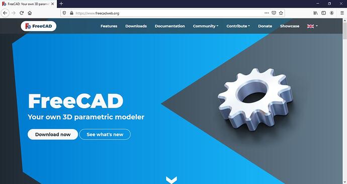

Step 1 - Download FreeCAD
-Go to https://www.freecadweb.org/downloads.php and select the distribution you need for your operating system
-Follow the instructions for the installation guide

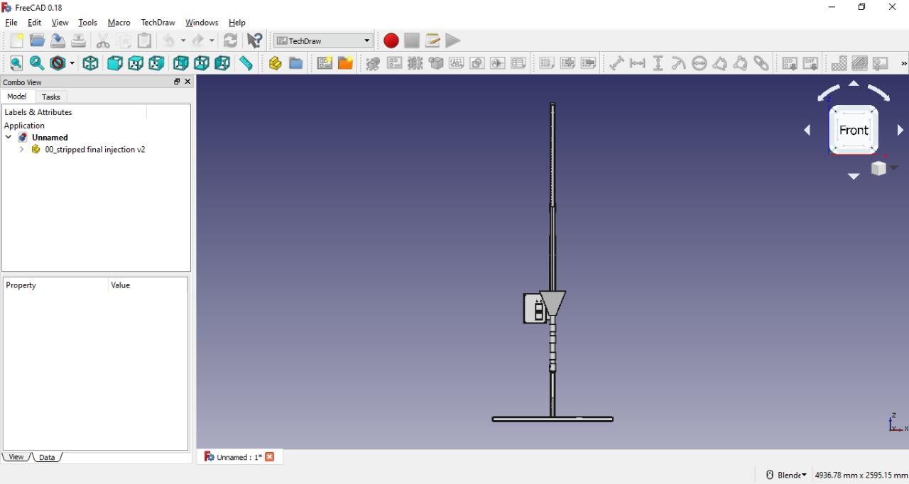

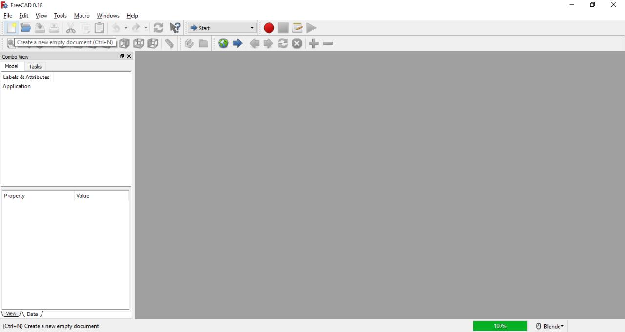

Step 2 - Import 3D Model
-We took this model from the starter kit but you can also use a part that you have designed yourself in FreeCAD

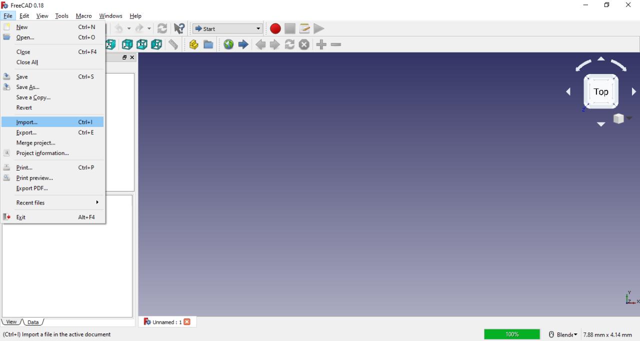

-Create a new empty document by clicking the new document button in the menu
-Click File > Import then select the file you wish to use

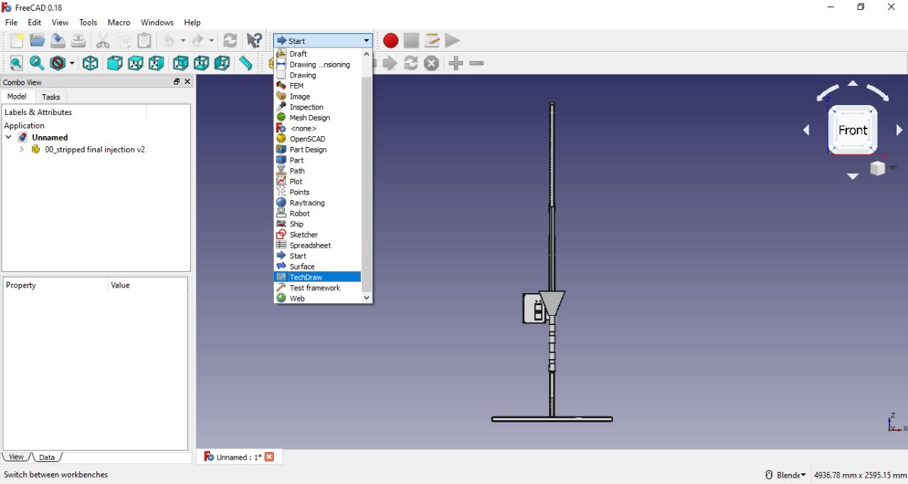

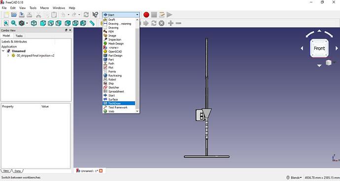

Step 3 - Select the TechDraw Workspace
-FreeCAD has various workspaces which has different buttons and are used for different use cases
-The one we need is the TechDraw workspace as it is used for create
-All you need to to do is select it from the dropdown at the top of the application

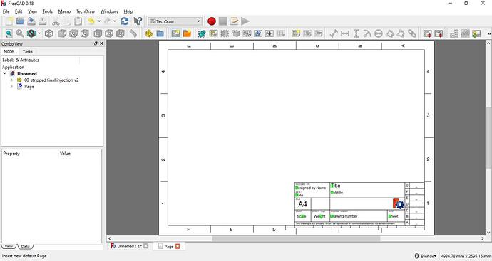

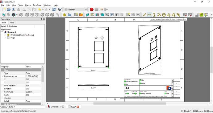

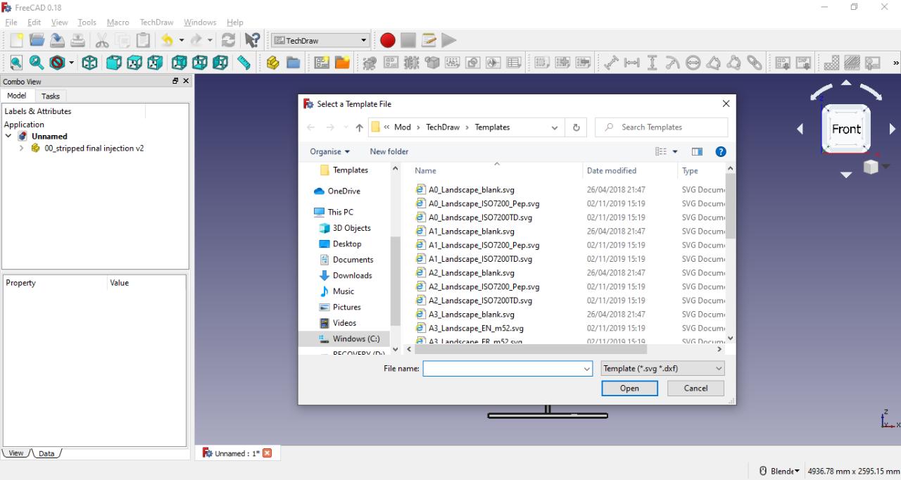

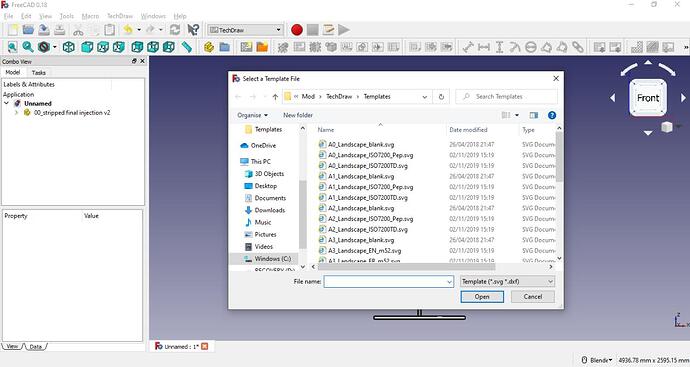

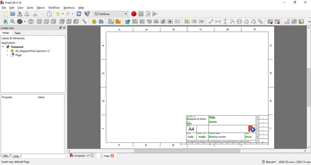

Step 4 - Generate a blank template
-FreeCAD already comes prepared with various Blueprint sizes and standards
-You can select it by clicking the folder icon in the TechDraw workspace and select the type
-Or you can select the default one by clicking the "Insert new default Page" button in the TechDraw workspace
-You can also make your own as it takes an SVG format so you can adapt it to your needs

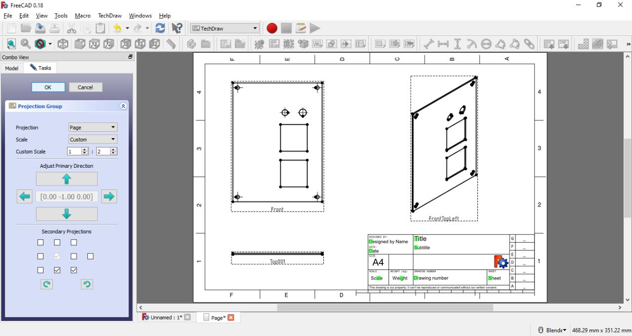

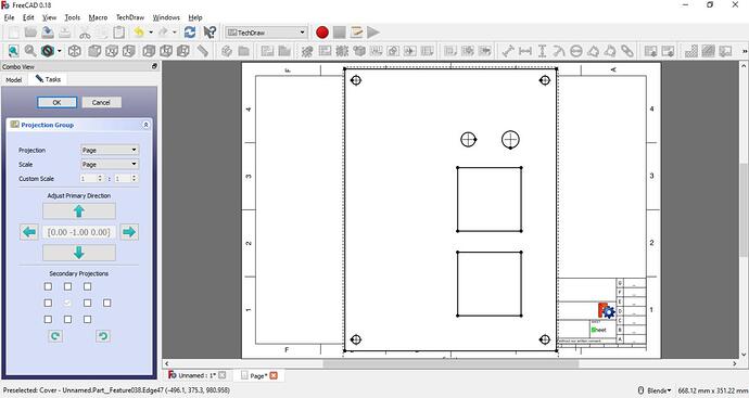

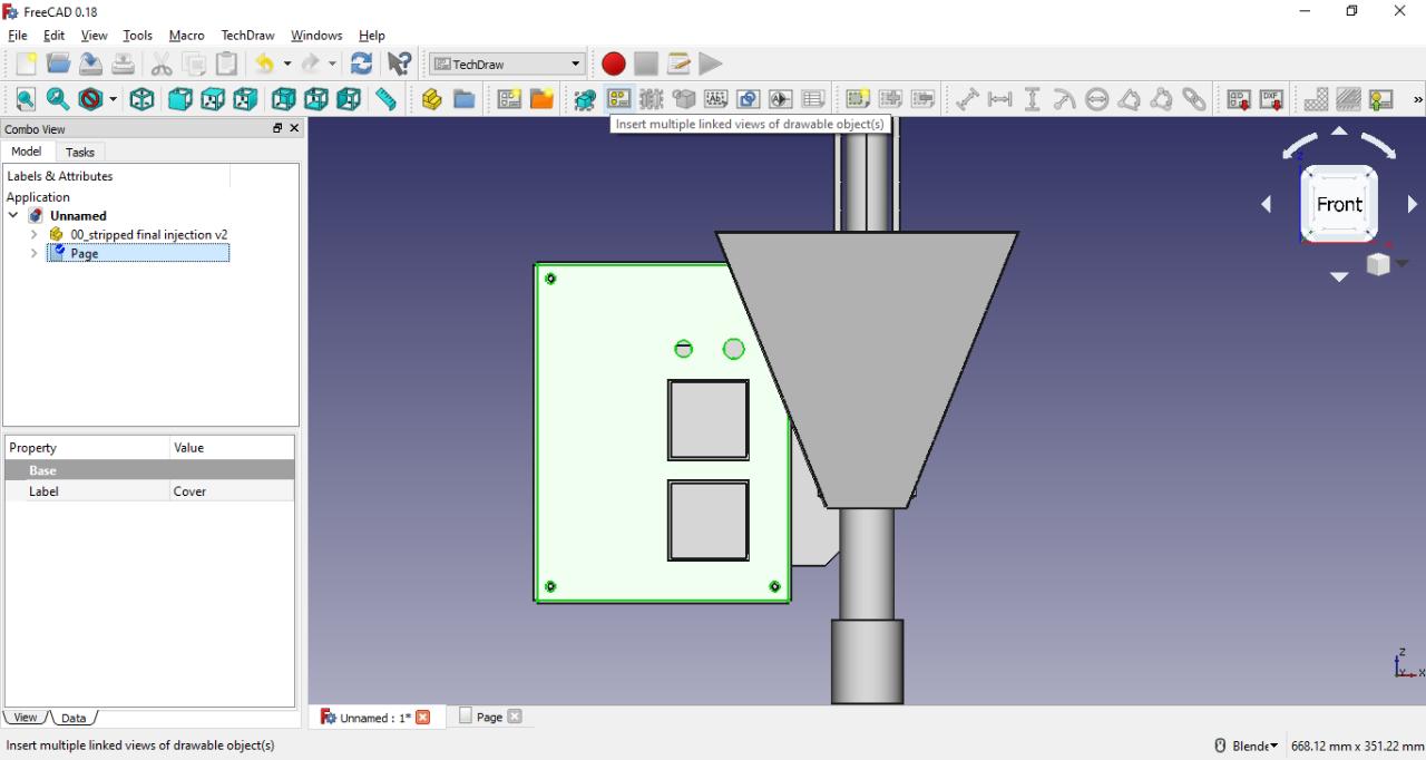

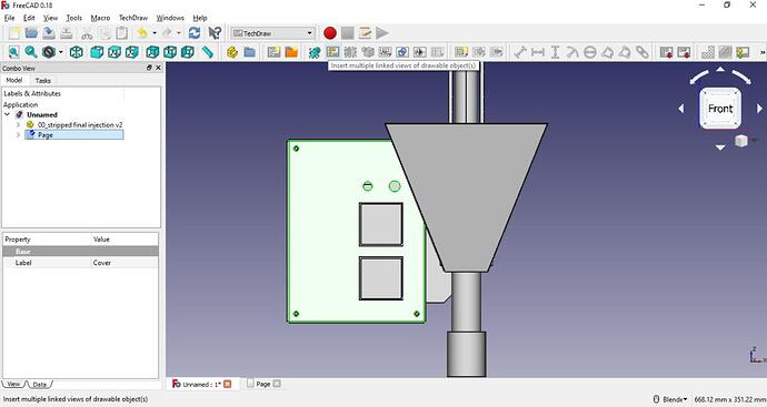

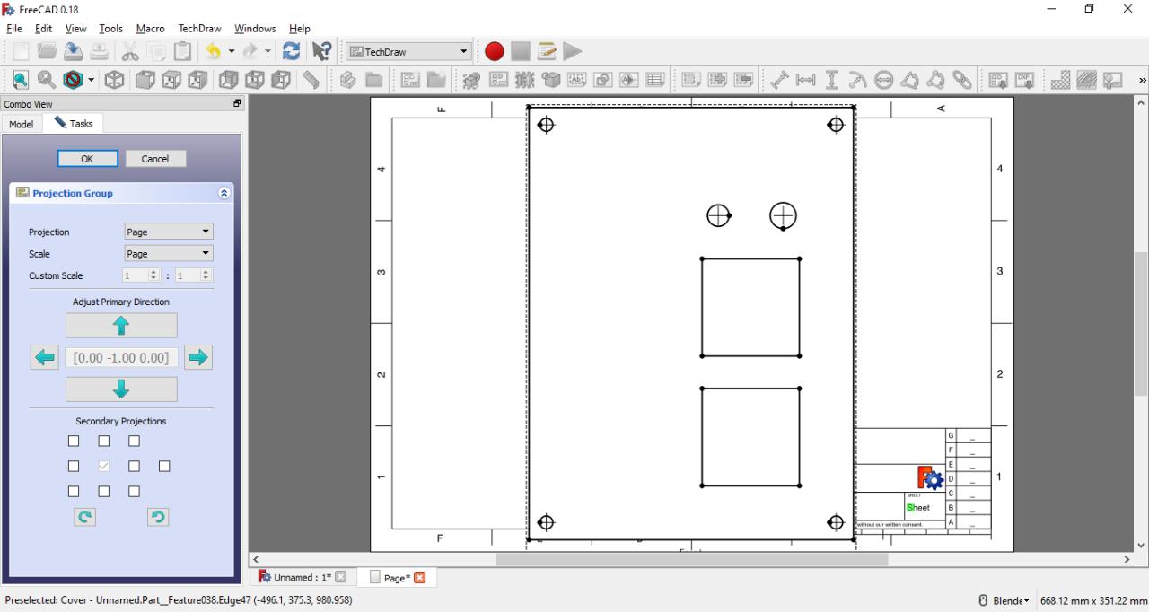

Step 5 - Import perspective view
-Select the item you wish to do a blueprint of in the view by left clicking the item
-Then holding CTRL & clicking on the page in the side menu
-Click on the "Insert Projection View" button
-Open the Page and you will see the drawing in the page by
-You can adjust the rotation, scaling & which views are visible from the side menu
-Click "OK" in the task menu to confirm your choice
-If it's not updating click the refresh button in the top menu
-The good thing about doing it this was is that the blueprint and any dimensions you add should update if you update the base model

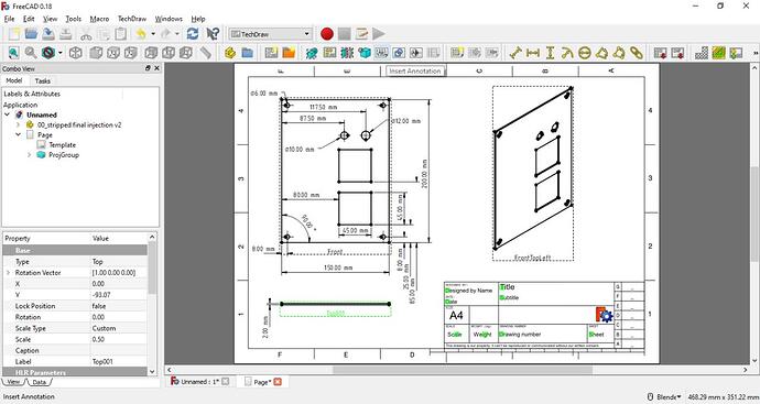

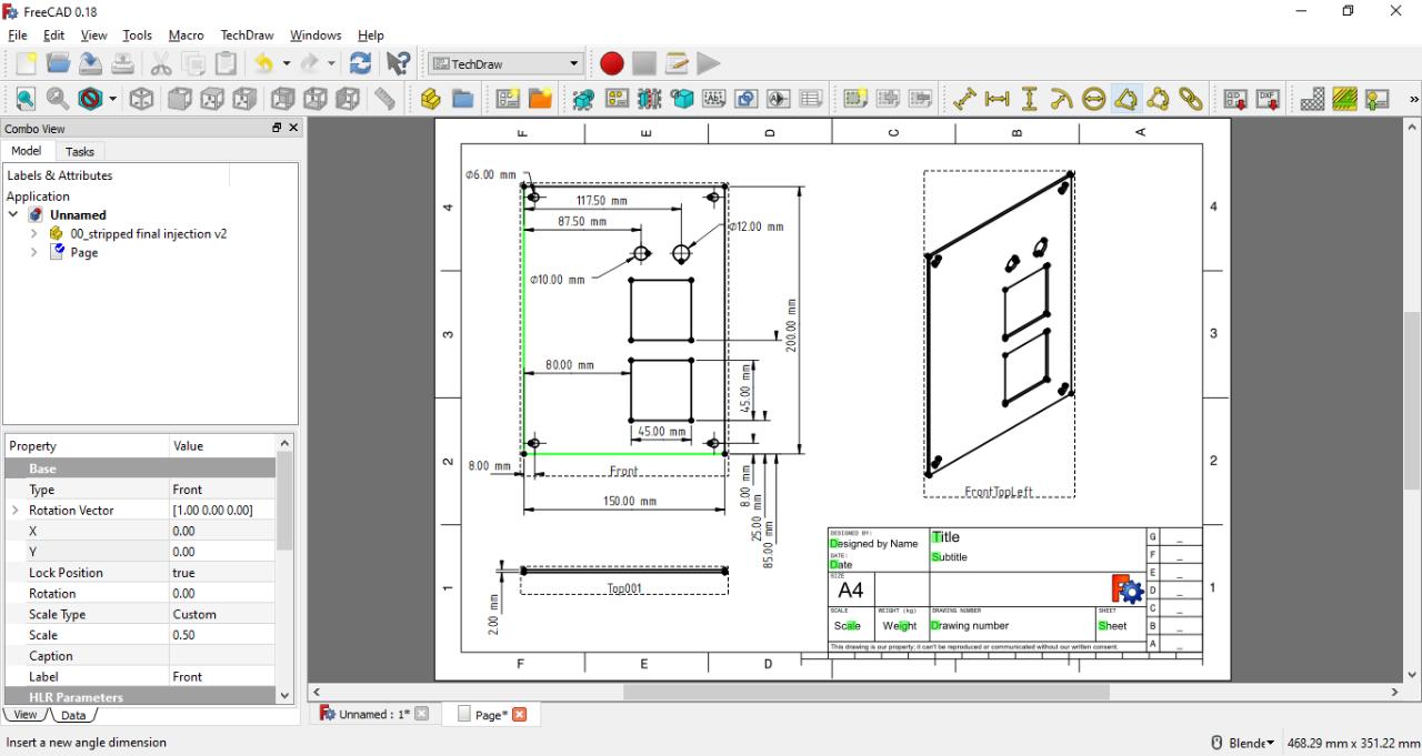

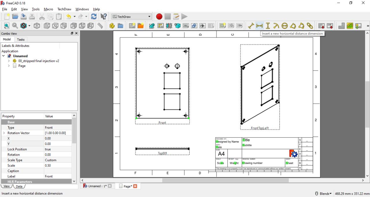

Step 6 - Add Linear Dimensions
-Select two points by holding CTRL and clicking on the two points you need
-Click the horizontal or vertical dimension buttons & adjust location of the dimension to your needs
-Adjust the location so the dimension is legible
-Repeat till all relevant information is present

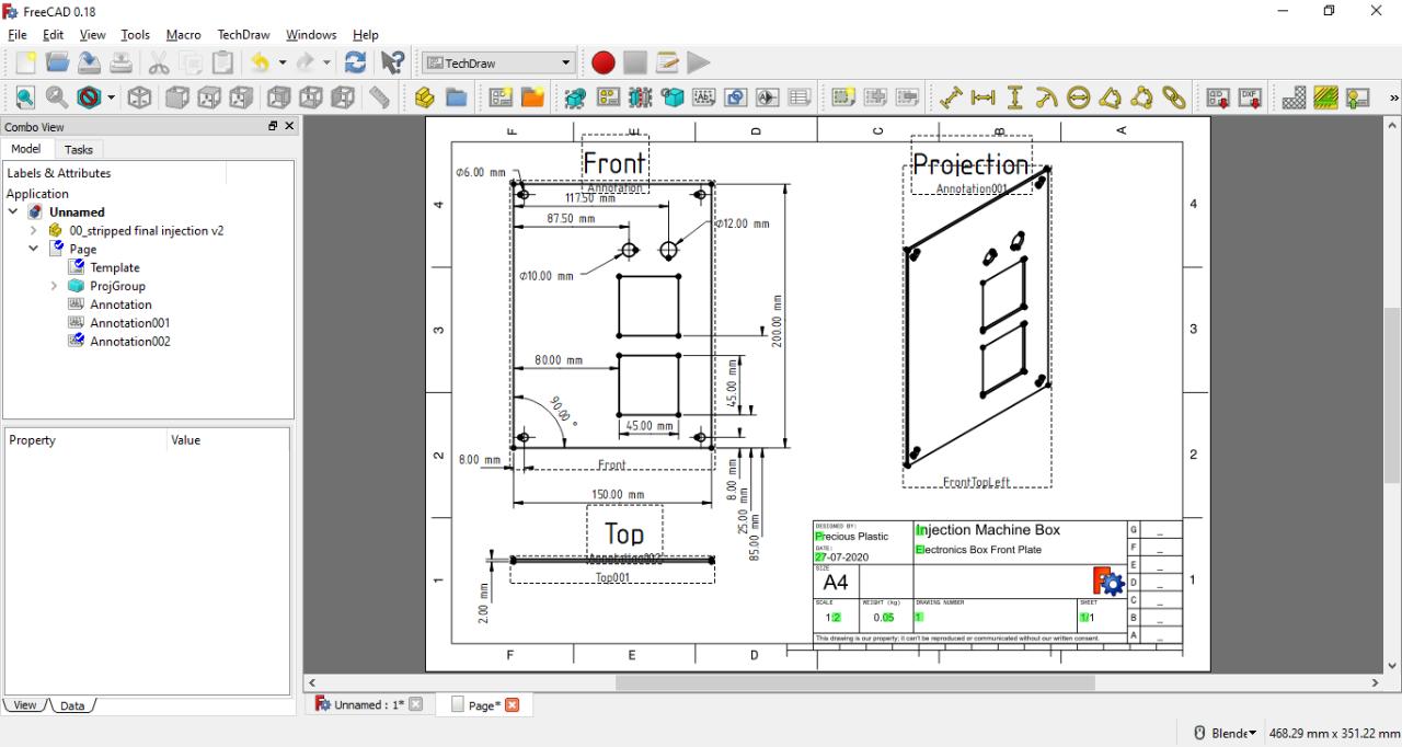

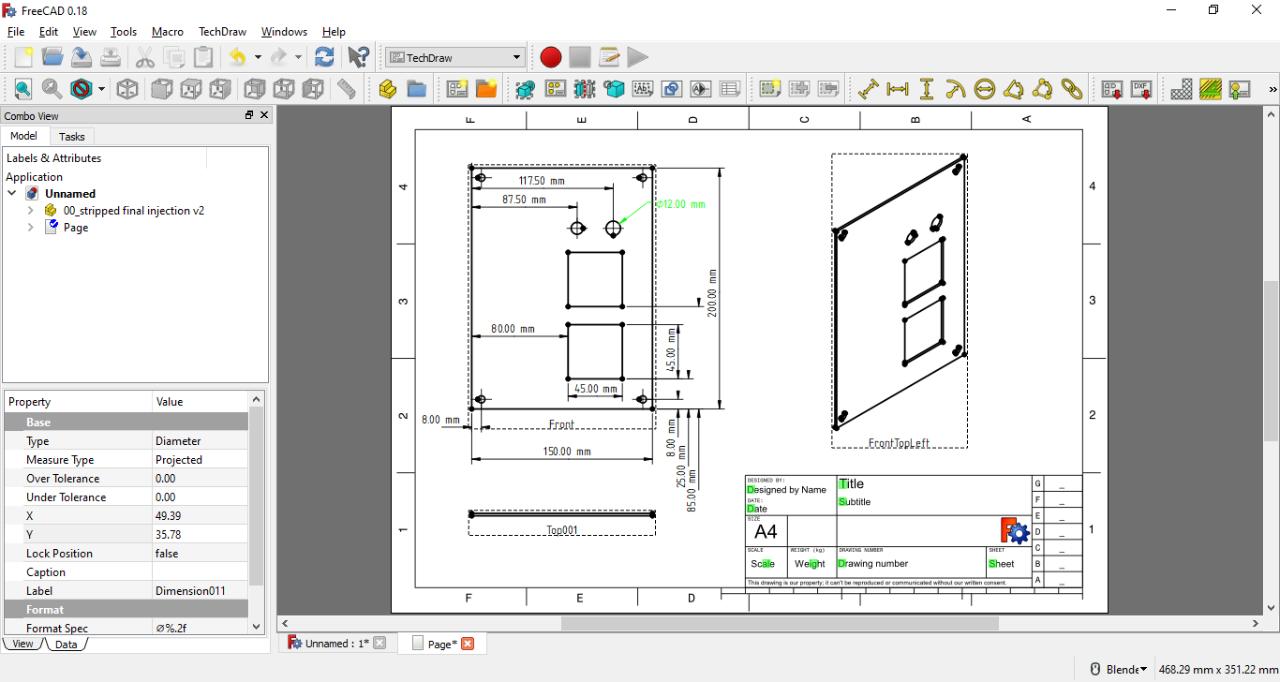

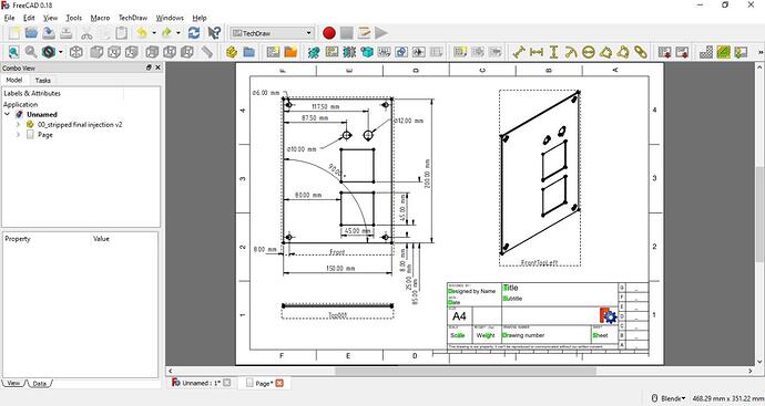

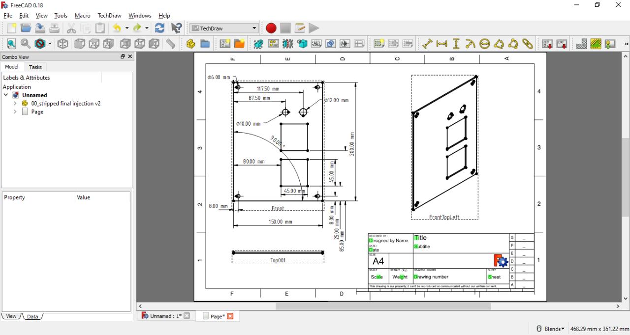

Step 7 - Add Diameter Dimensions
-Select the circle you wish to add a diameter to
-Click on the Diameter dimension button
-Repeat for all circles in your drawing

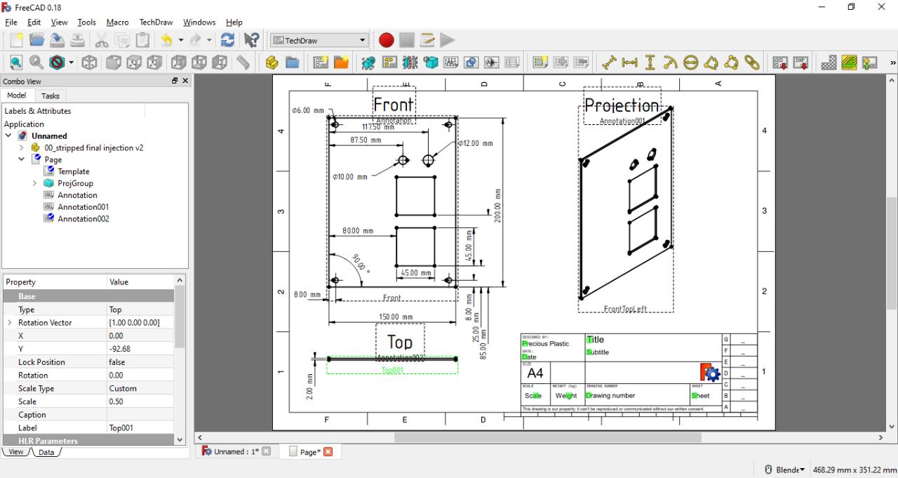

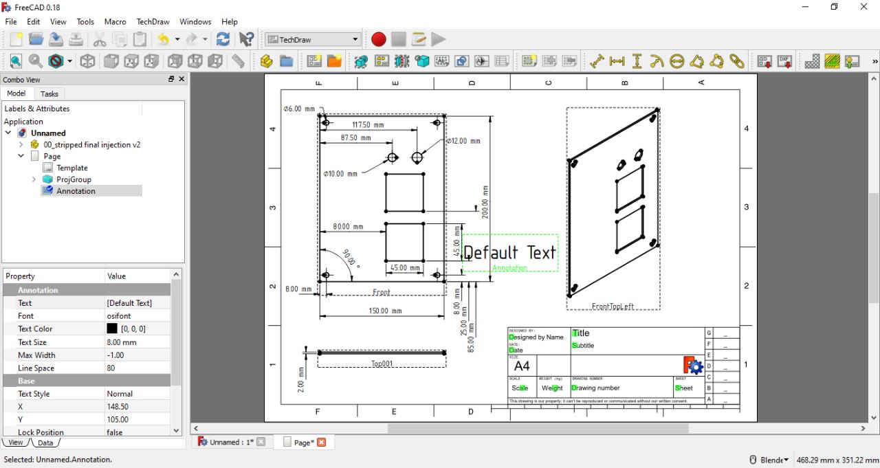

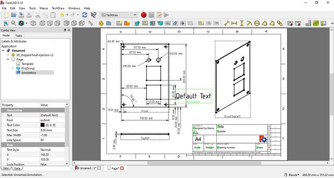

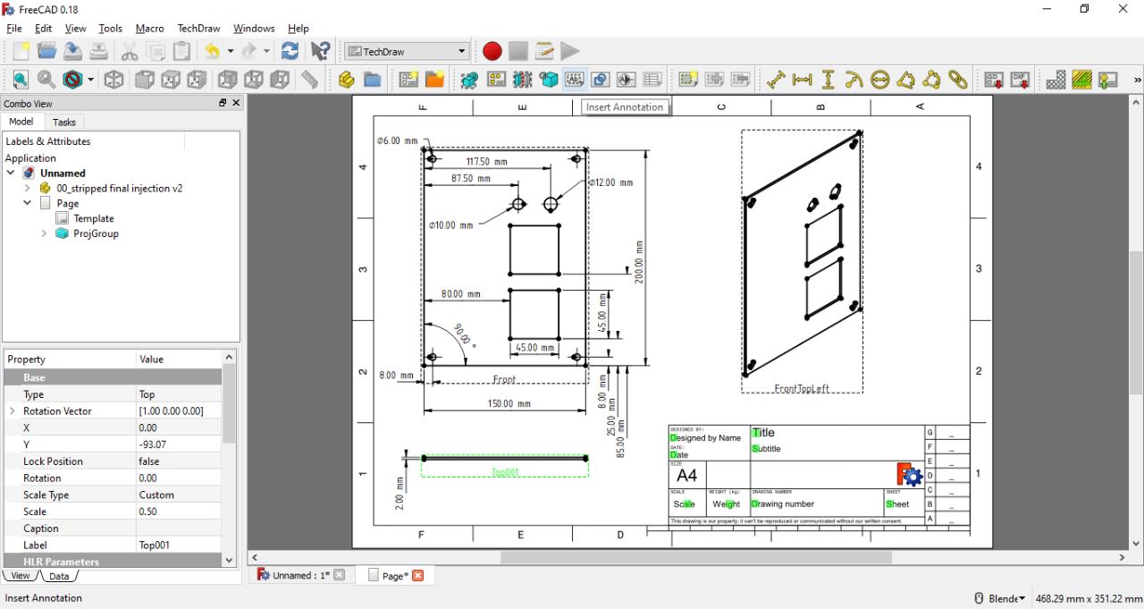

Step 8 - Add Angle Dimensions
-Click the "Insert Annotation" button in the TechDraw workspace
-You can adjust the text & text size in the left hand panel
-We have added the names of each of the views as the frame titles are not visible on export

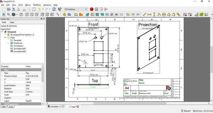

Step 9 - Add Annotations

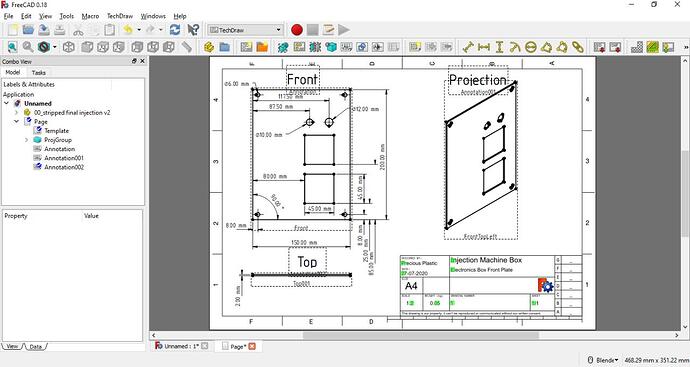

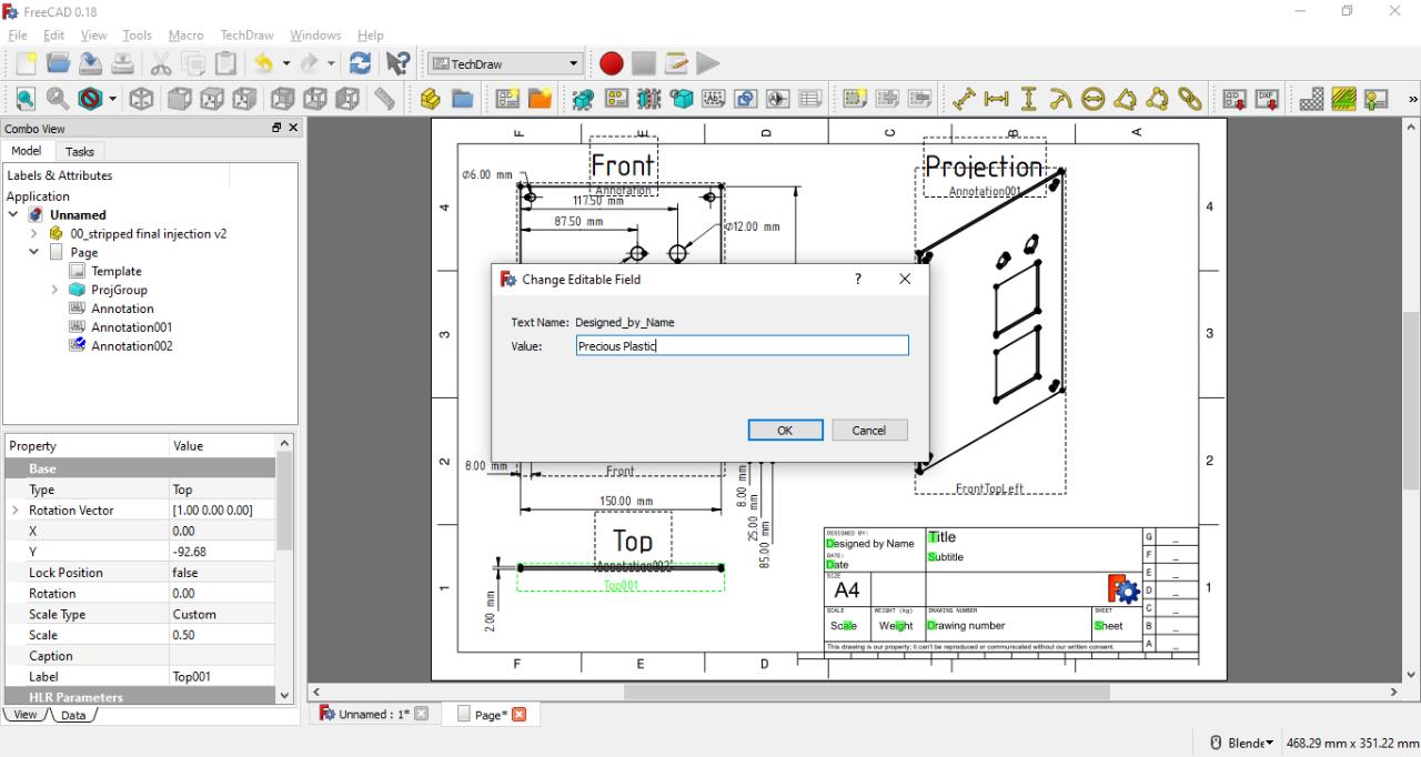

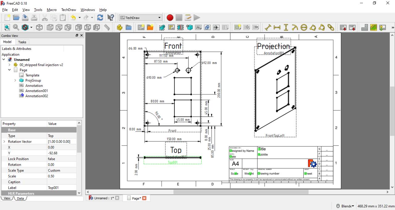

Step 10 - Add Blueprint Details
-There is always a section in blueprints explaining the details of the drawing
-You can see by the green boxes what is editable in the template
-Click the green box within each section and it will open a modal window for you to fill in the text
Don't forget to add
-Who made it
-When it was made
-What the dimensions of the notations are
-What the scale of the view is
-What version number it is
-If there are multiple sheets explaining the file

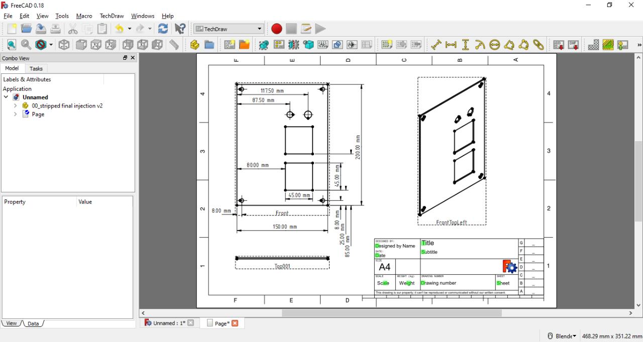

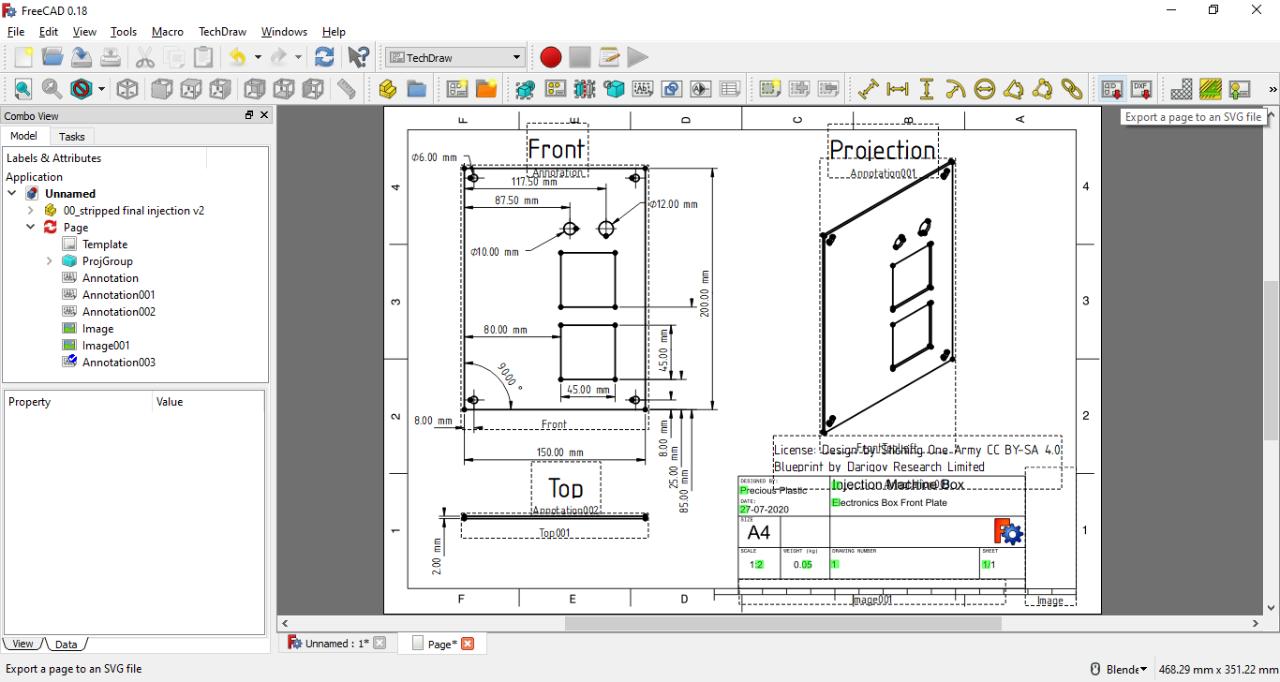

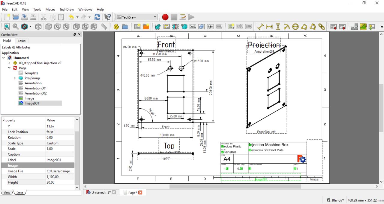

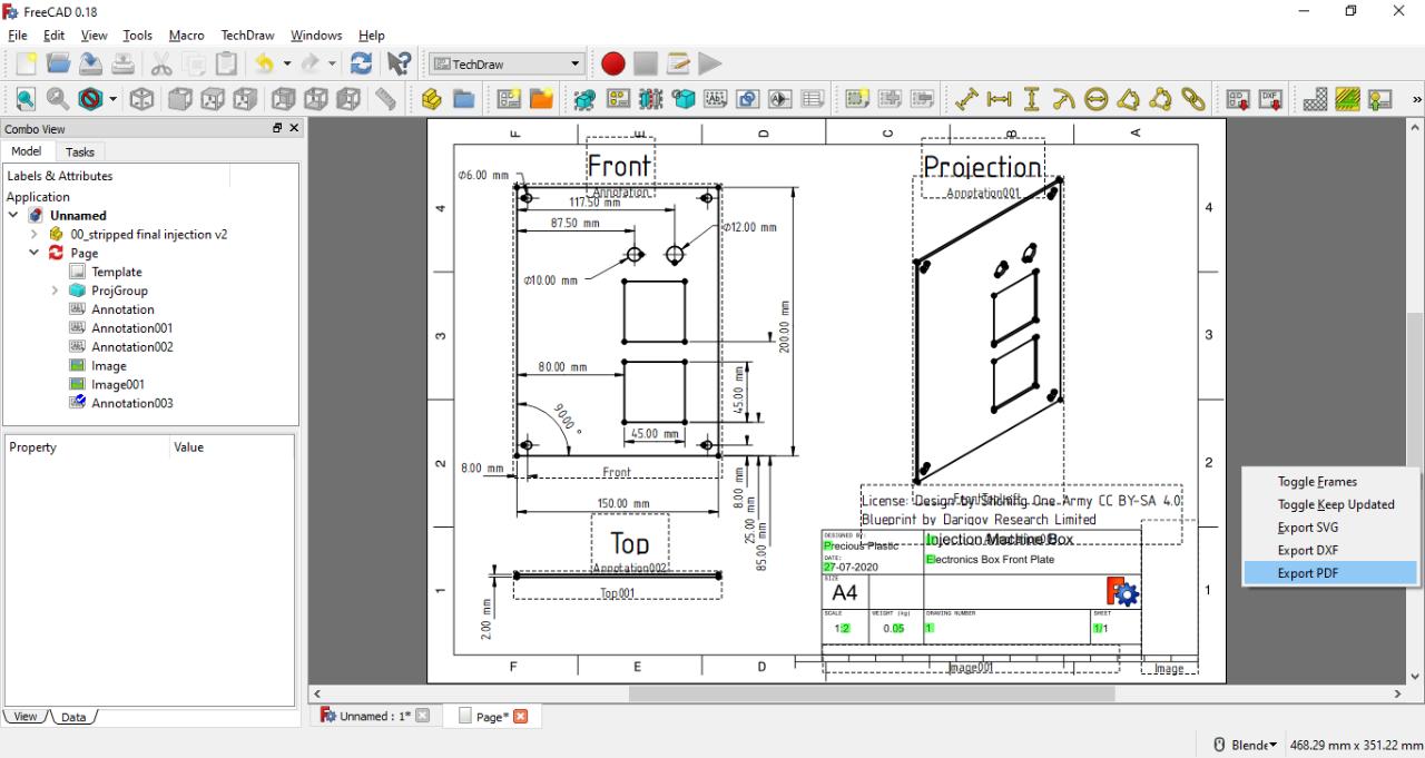

Step 11 - Cleanup

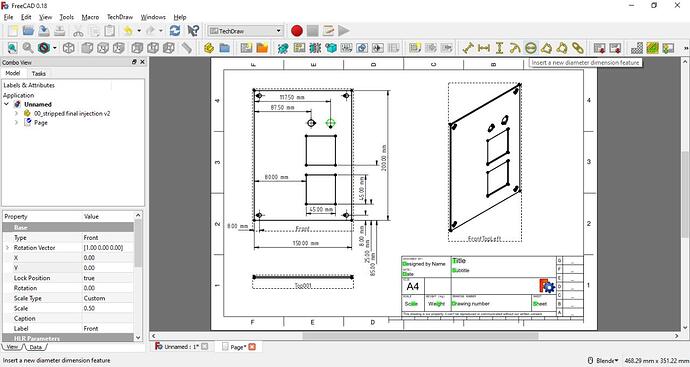

-As this is open source work we will need to remove the default text from the template
-While we're at it we can also remove the details table on the right hand side

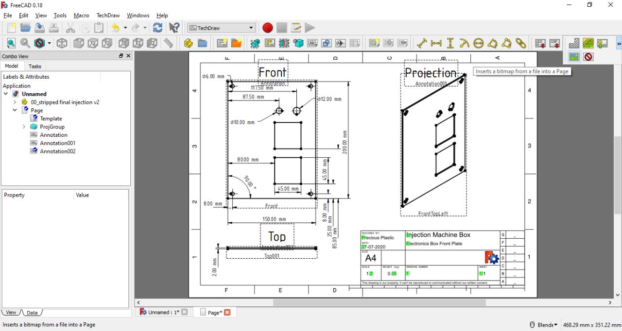

-We done this by using a blank white .png file and using it as a mask
-Select the "Insert Bitmap from file" button and use the masks provided in this tutorial
-You'll need to put it in the right position & adjust for the size
-This is done by adjusting the parameters after clicking it in the left hand panel

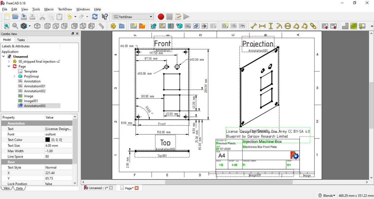

Step 12 - Add the license
-We will fill in the license of the starter kit and we need to note what was done for this blueprint
-We added it by using another annotation as shown before

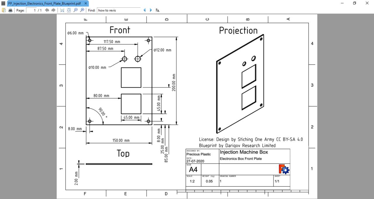

Step 13 - Export
-There are many file formats that you can export to such as SVG, DXF & PDF
-SVG & DXF formats have their own buttons that you can click in the top menu
-If you wish to export to PDF just right click anywhere on the page and click "Export PDF"
-Save it somewhere you will find it later
