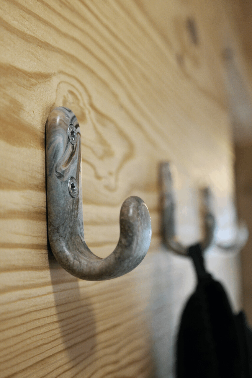

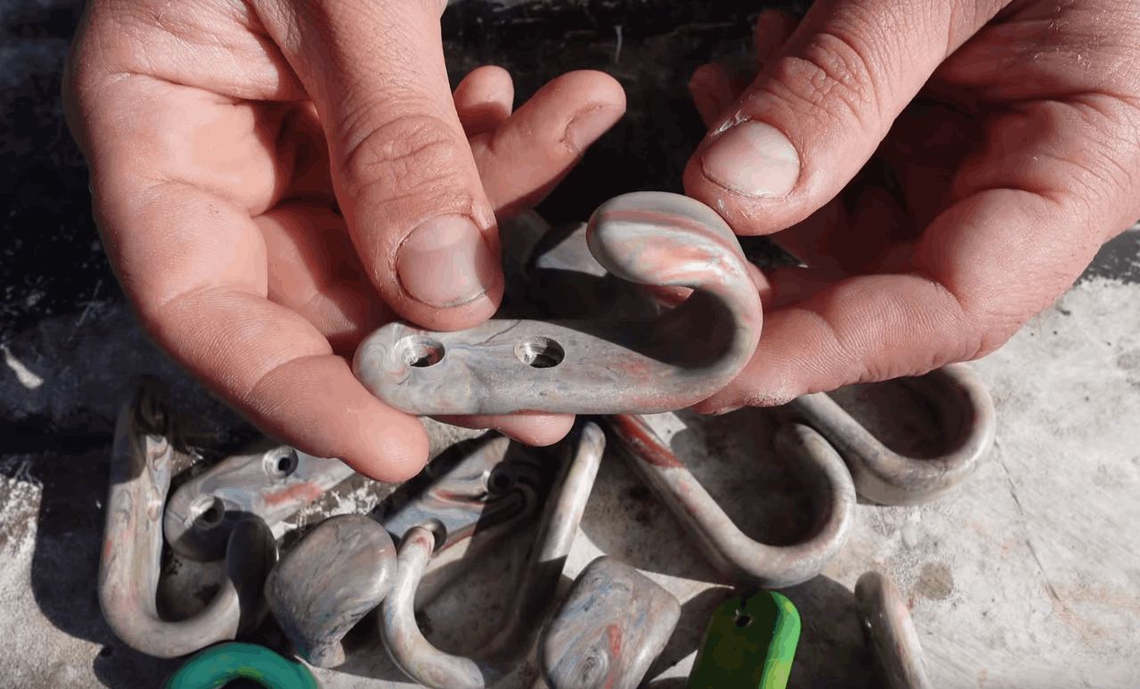

Wall hooks are mainly used to hang clothes. But this design allows you to hang your jackets, kitchen clothes, towel. It has a very versatile and simple design in order to serve as much places and uses as possible.

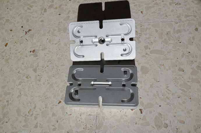

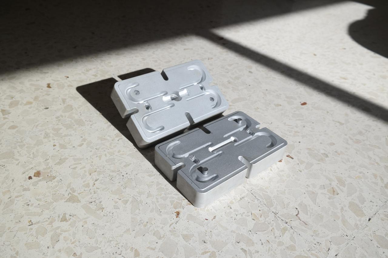

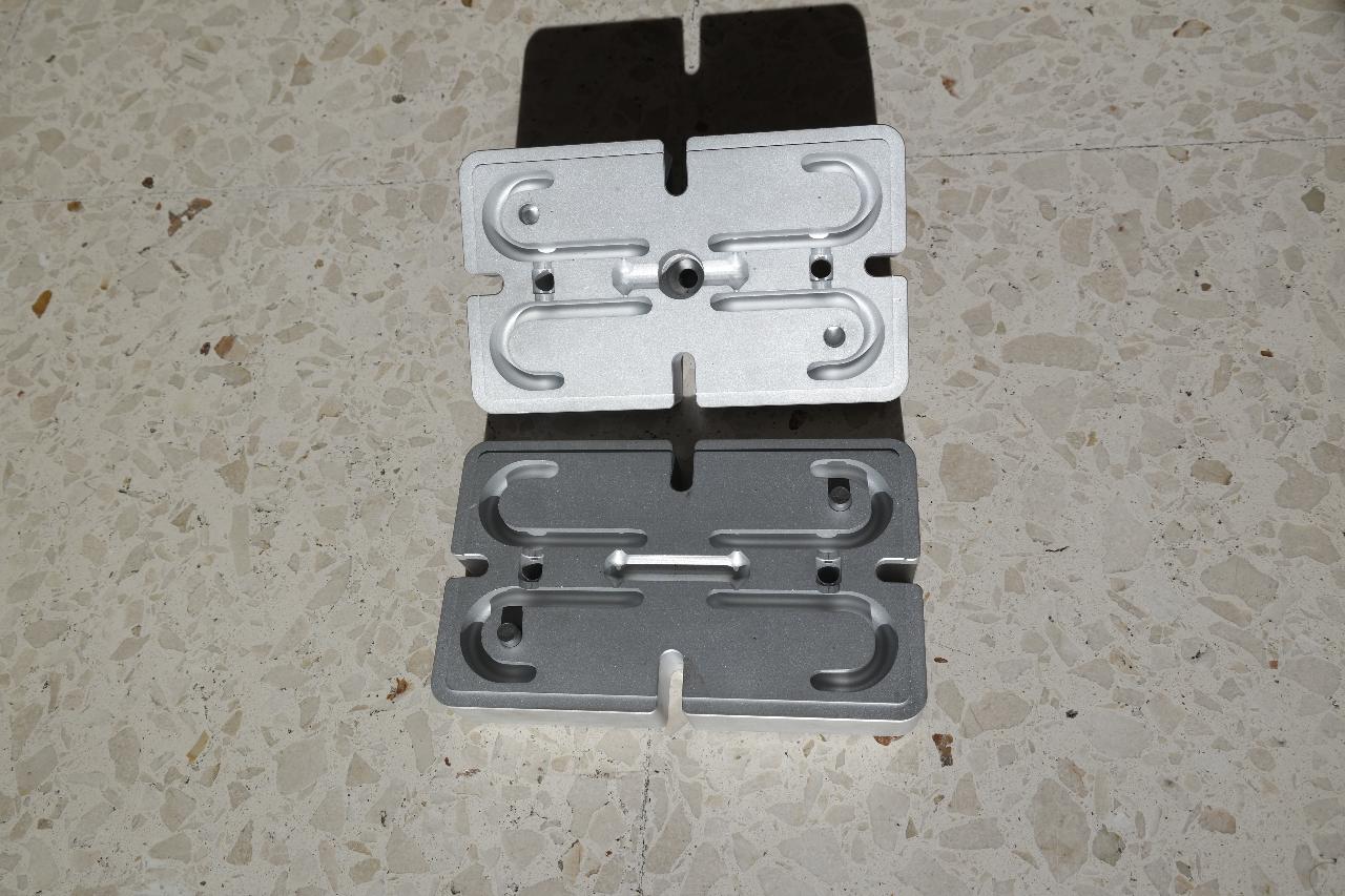

Step 1 - Make your mould
This mould is design to be manufacture with aluminum machined with a CNC machine. You can find the files in this How-To

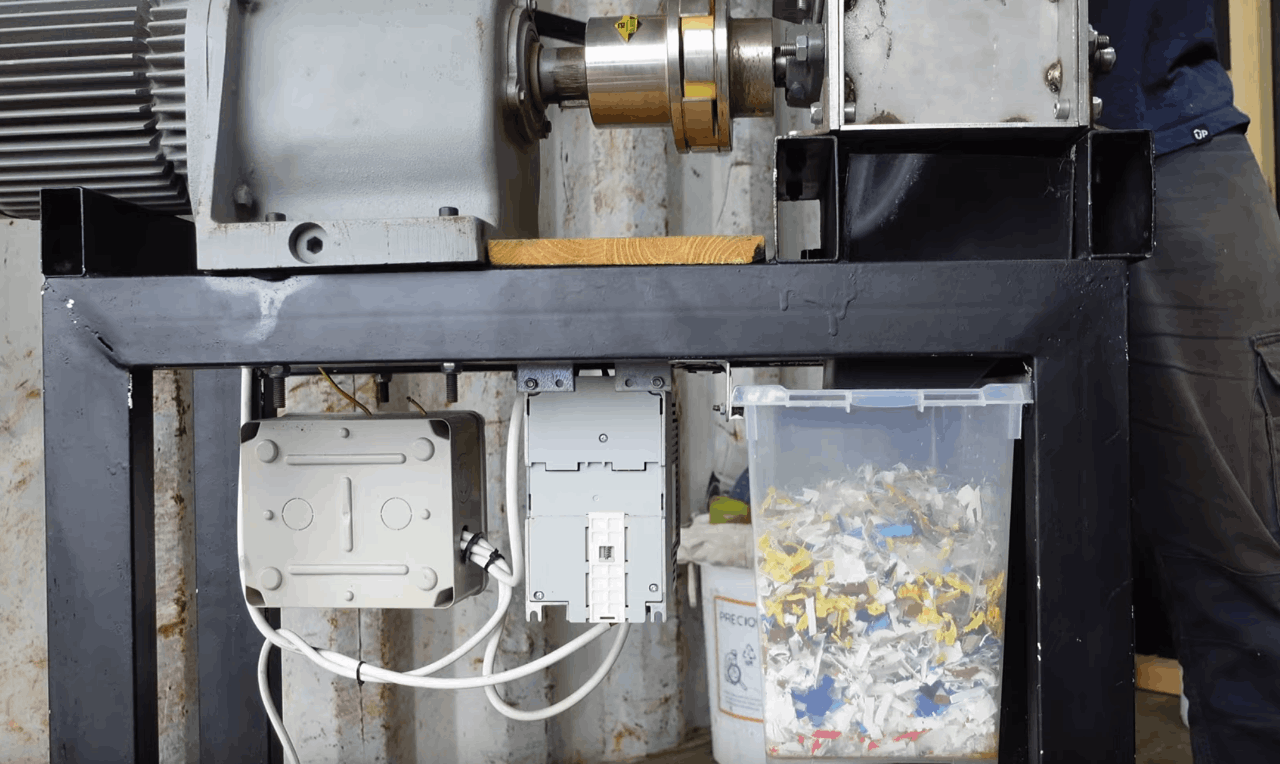

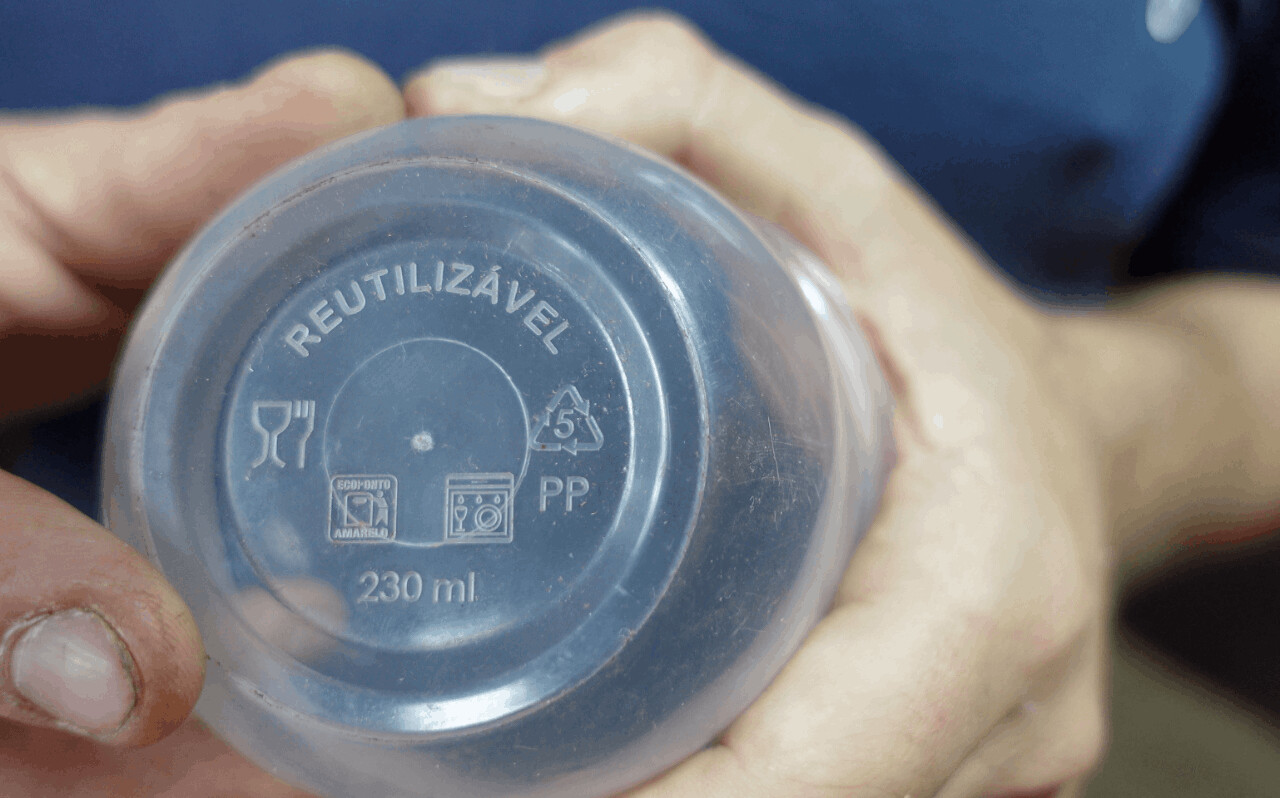

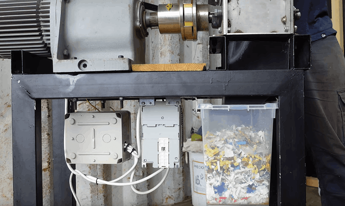

Step 2 - Collect your plastic and shredd it
It is time to collect your plastic! Remember to not mix plastics. In our case we are gonna use PP, but this product can be injected with HDPE too.

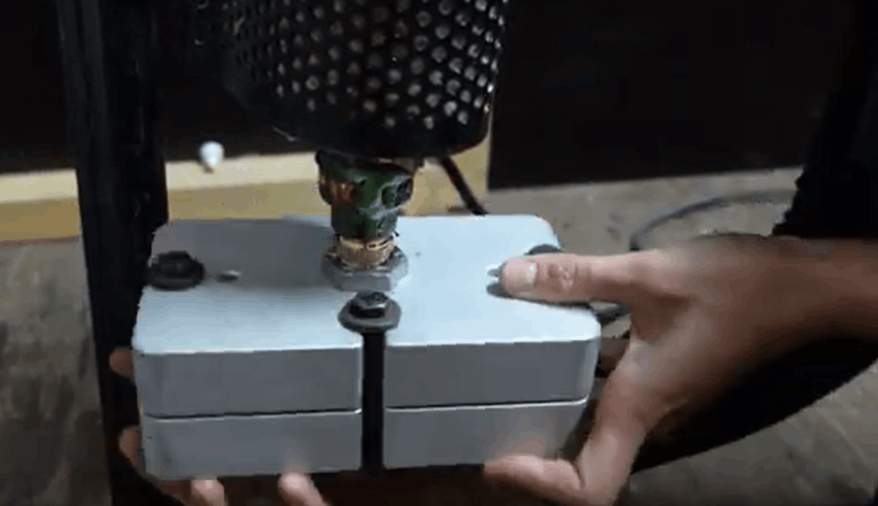

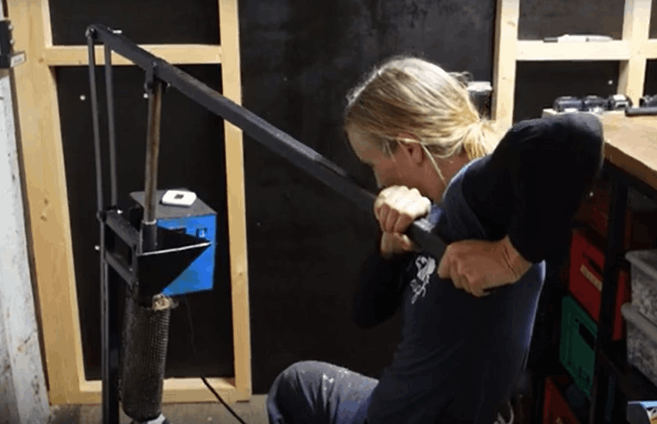

Step 3 - Inject
It is time to inject! In our case we use a classic V3 Injection machine with the 1/2" nozzle. But you can use any other variation of injection machines, the mould is quite flexible to be used with other machines and can handle different pressures.

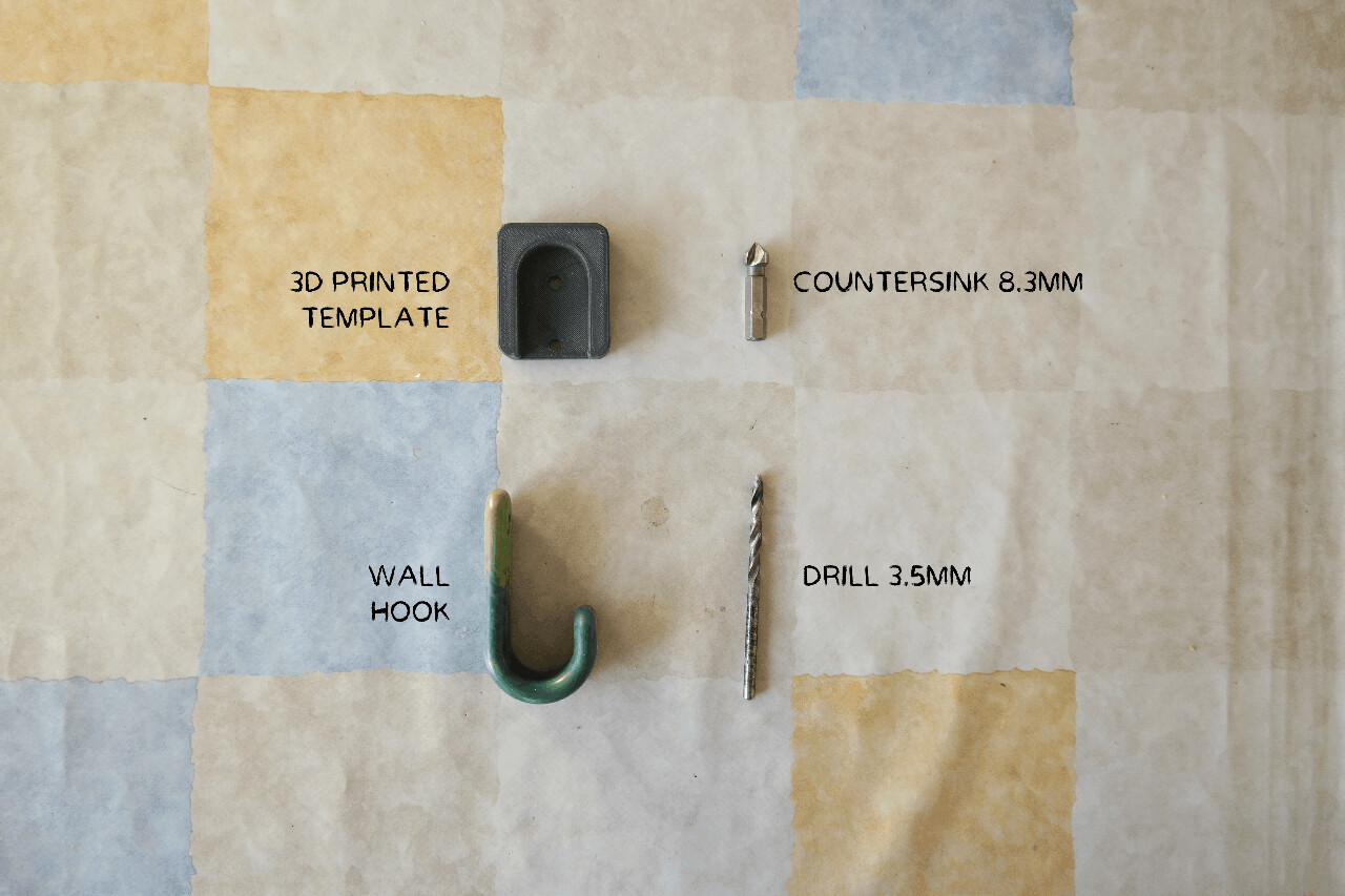

Step 4 - Drill the holes
Once your hooks are injected you have to drill some holes in order to screw your hooks to the wall.
For this we provide you with an .STL file for a template to drill the holes always in the same position.
In our case we have used 4x30 screws for the wall so we use a 3.5mm drill and a 8.3mm countersink
TIP: Make sure you are drilling straight in the hole

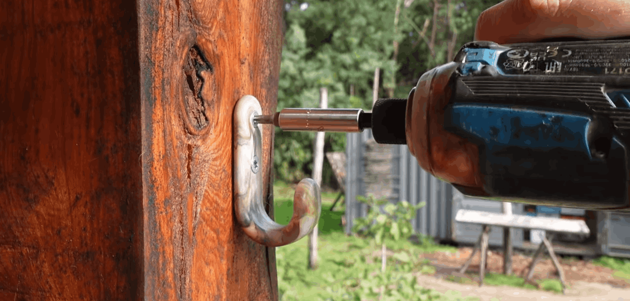

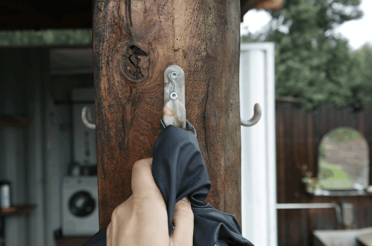

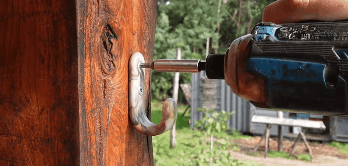

Step 5 - Install your hook
In our case we used 4x30 screws for wood, but you can adapt this dimension to your needs. For adjusting screw size you should also adjust your drill/countersink sizes.

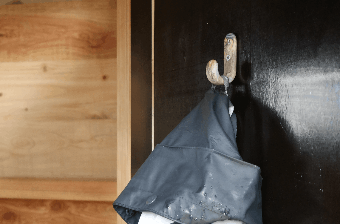

We are installing our hook on thick wood surfaces but you can choose to install it wherever you want!
