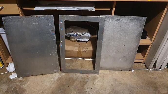

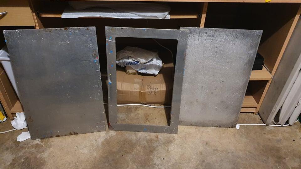

You need 2 base plates and one aluminum frame (we highly recommend having a thick border, the frame will bend less easily)

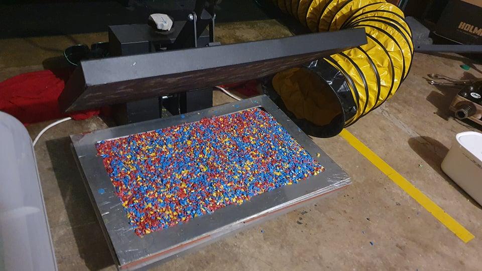

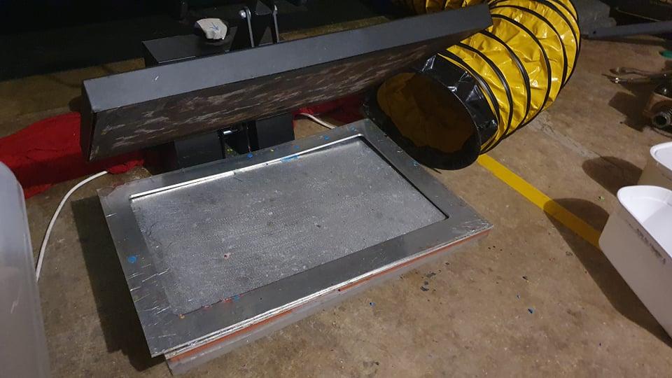

Lay 1 base plate and the aluminum frame down, fill evenly with the plastic granules, then lay the second base plate on top, like a sandwich before closing.
Step 2 - Preparing the machine

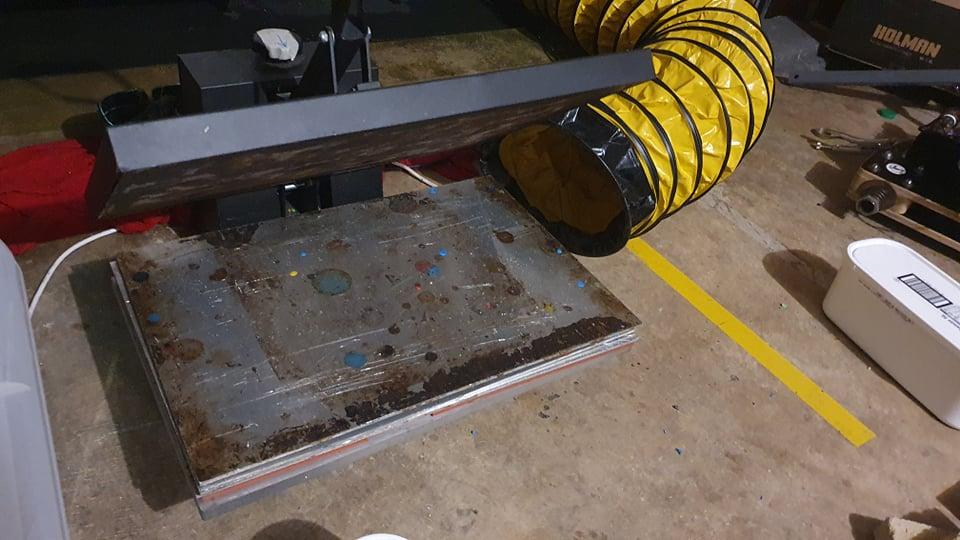

Turn your machine on. Temperature depends on plastic used, however we use HDPE.
Once temperature reaches 200 degrees, close the machine as tightly as you can, until you hear a click. This might take some fiddling with the knob at the top.
Step 3 - Melting the plastic

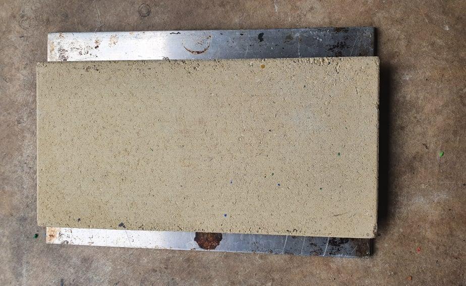

Melting takes 20-30 minutes. Once completed, pull the aluminum plates out and set aside on the concrete, we lay another slab of concrete on top for compression. (extra weight doesn't hurt) Let it sit for 30 minutes to cool. Be patient with this, because doing it sooner can cause issues.

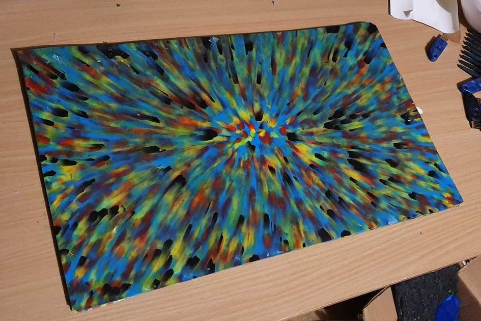

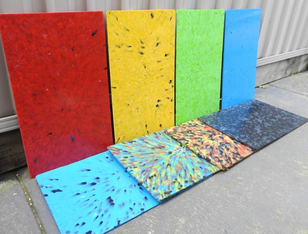

Step 5 - Experiment with colours

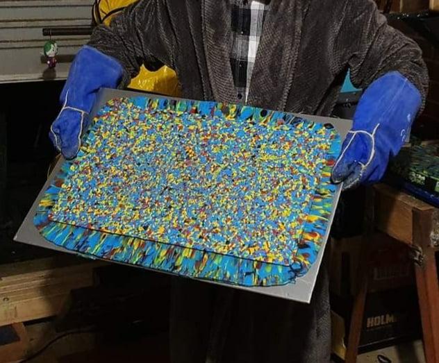

Now that your done, experiment with colours and patterns.
