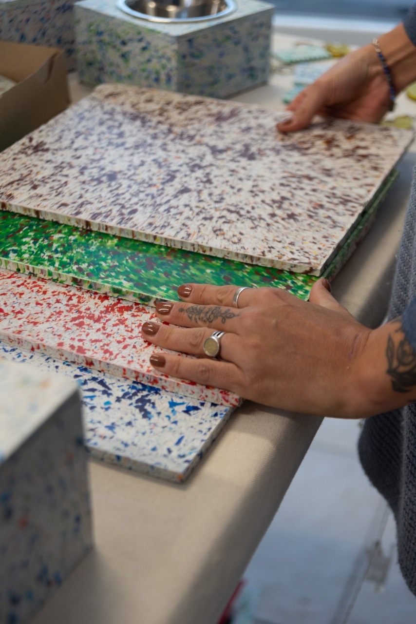

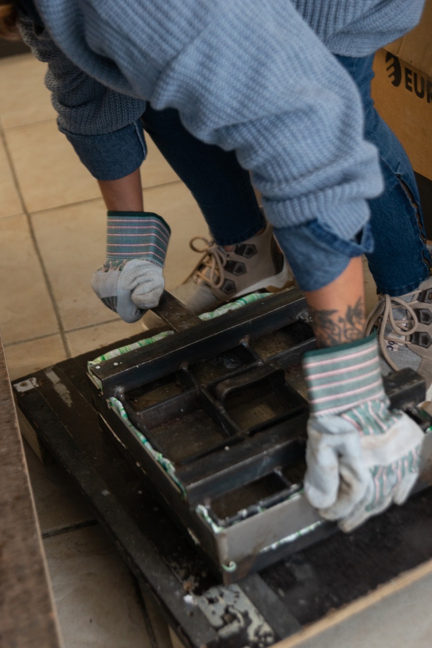

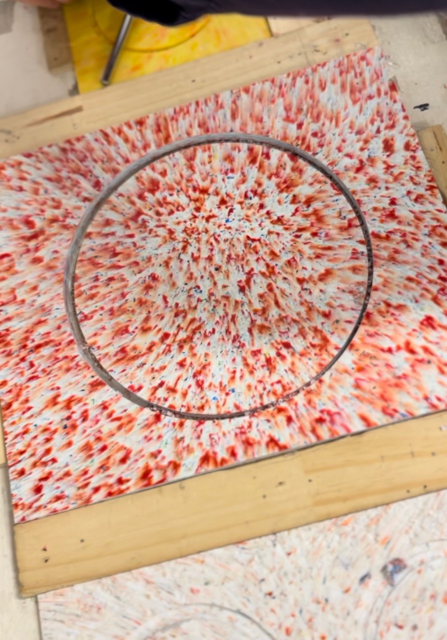

Step 1 - Make a plastic sheets
We need 3 sheets
Top: 27 x27 cm
Front base: 27x17 cm
Lateral base 25x17 cm
Thickness sheet: 1 cm
Poliestirene

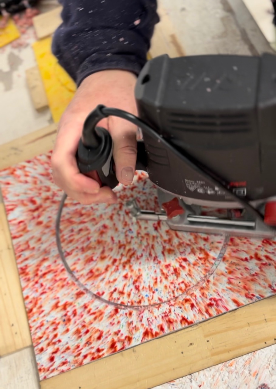

Step 2 - Plastic sheet cuts
We have to cut three circles, one for the plate base, and two for the legs base.
23 cm Circles
In this case, We use a milling machine

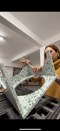

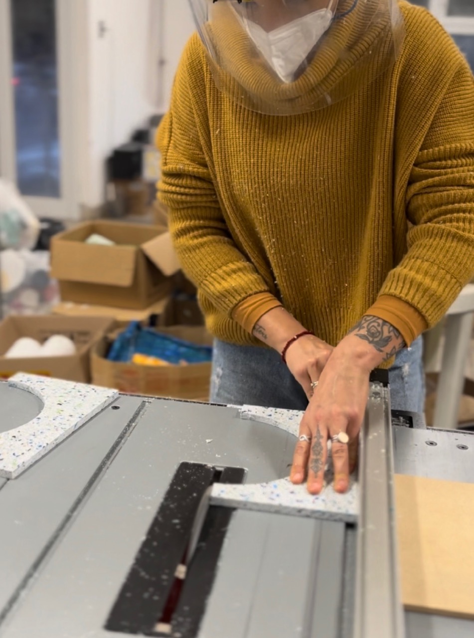

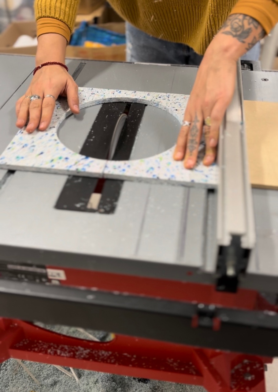

Step 3 - Cut the sheets in half
We have to cut the shets.
Here we use a bench saw machine
Is importantly to use all a personal protection elements to work safely

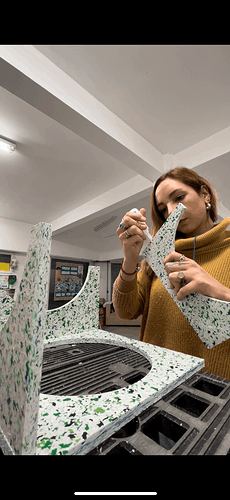

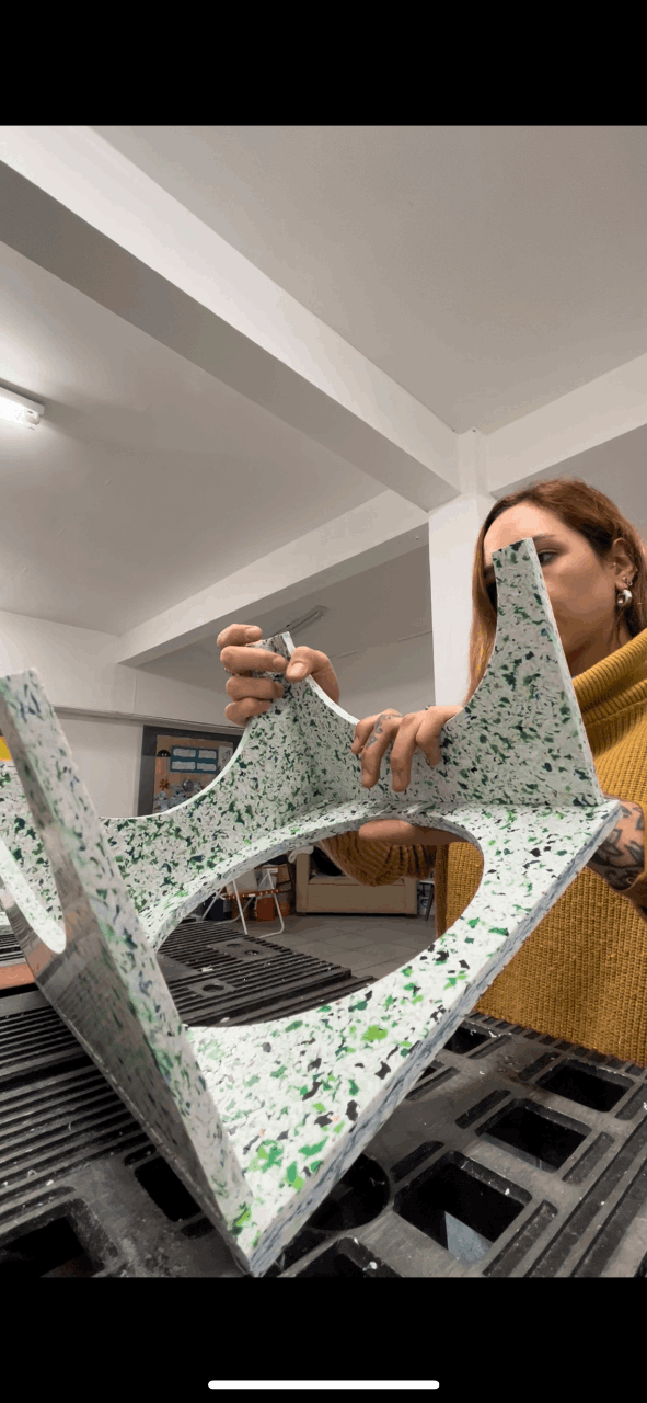

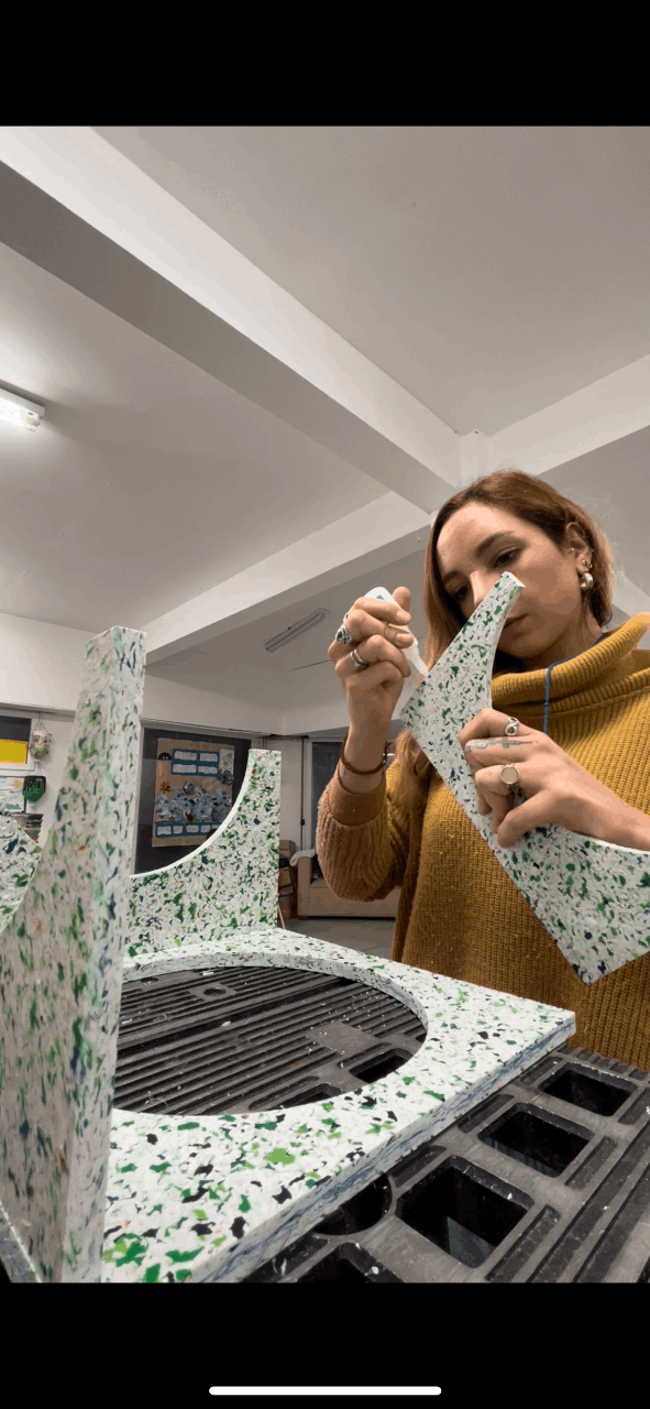

Step 4 - Assembled,glued and screwed
Is time to assemble the dog feeder. It is advisable glue and screw to avoid breakage
