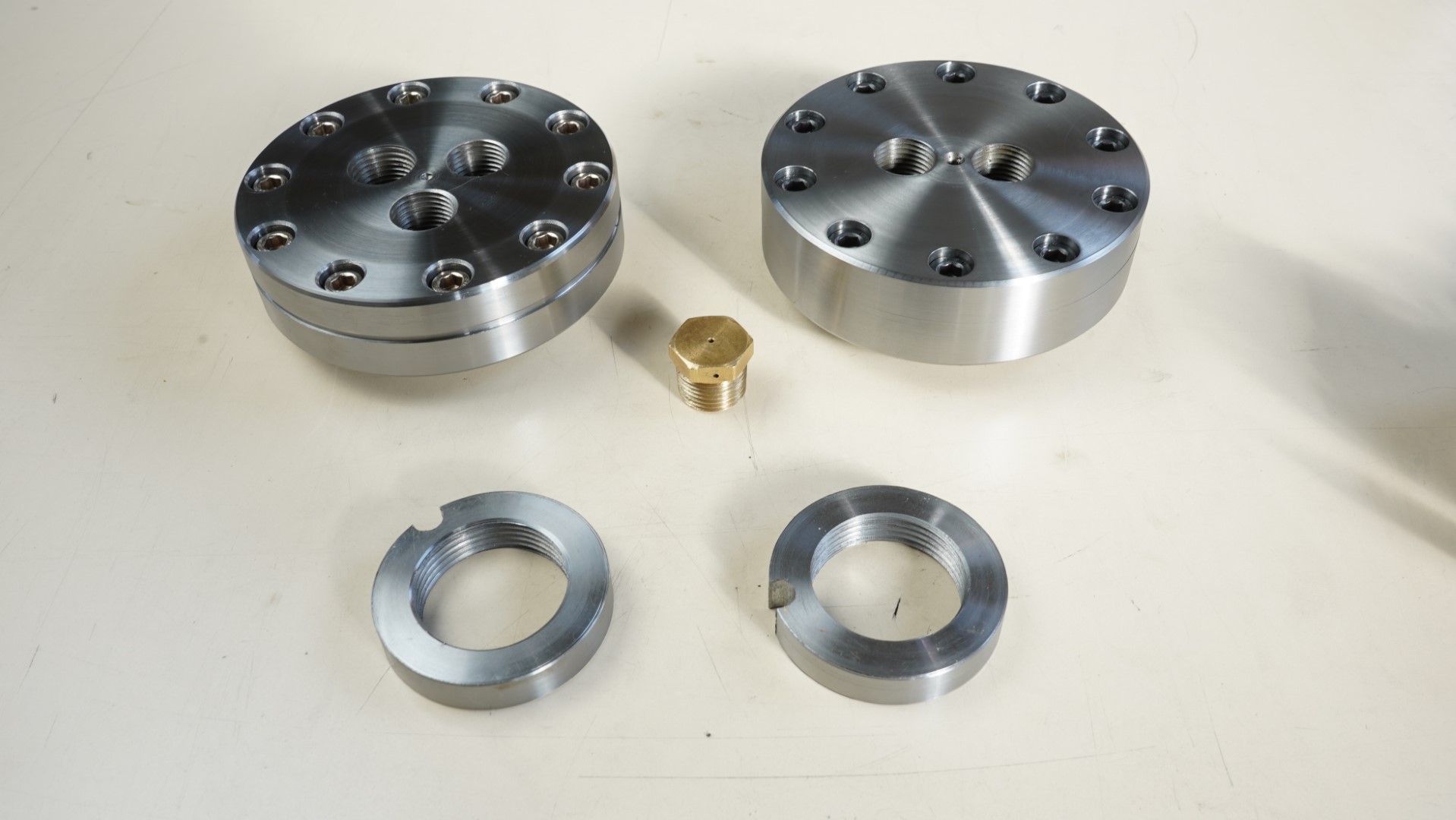

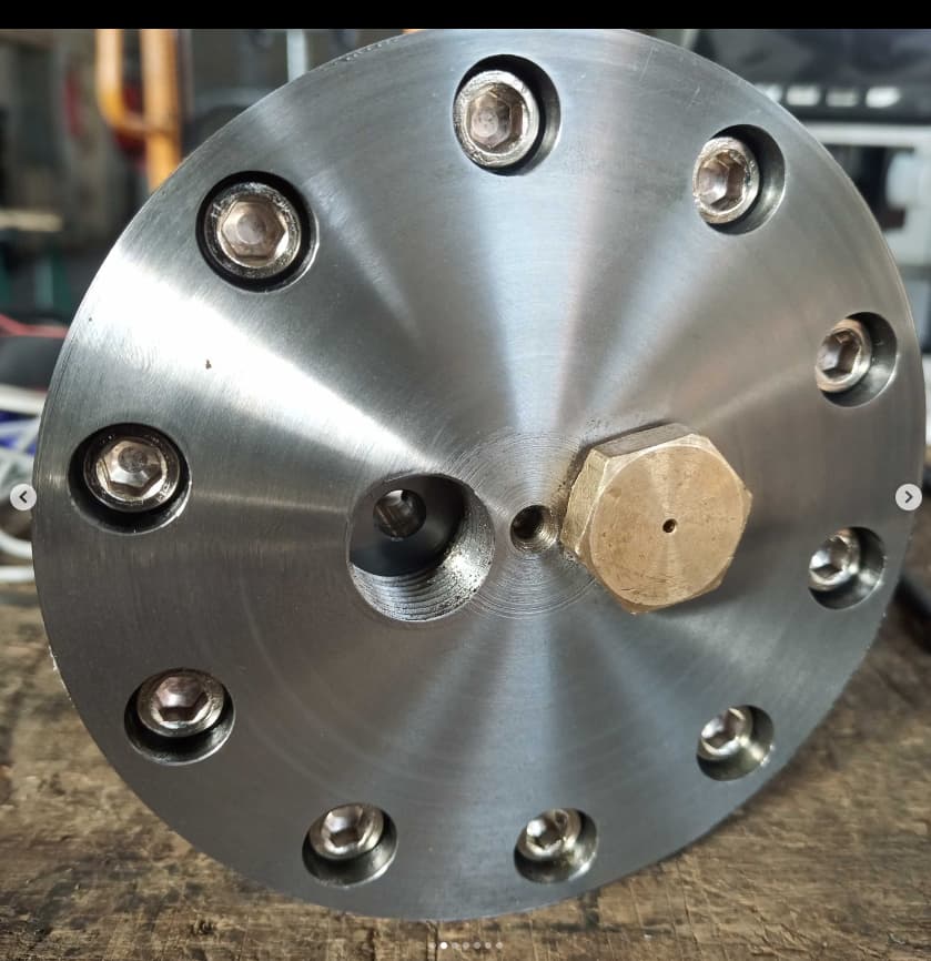

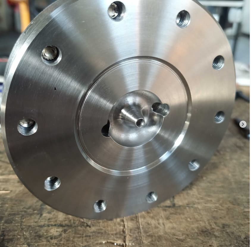

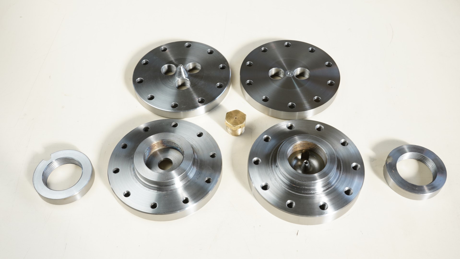

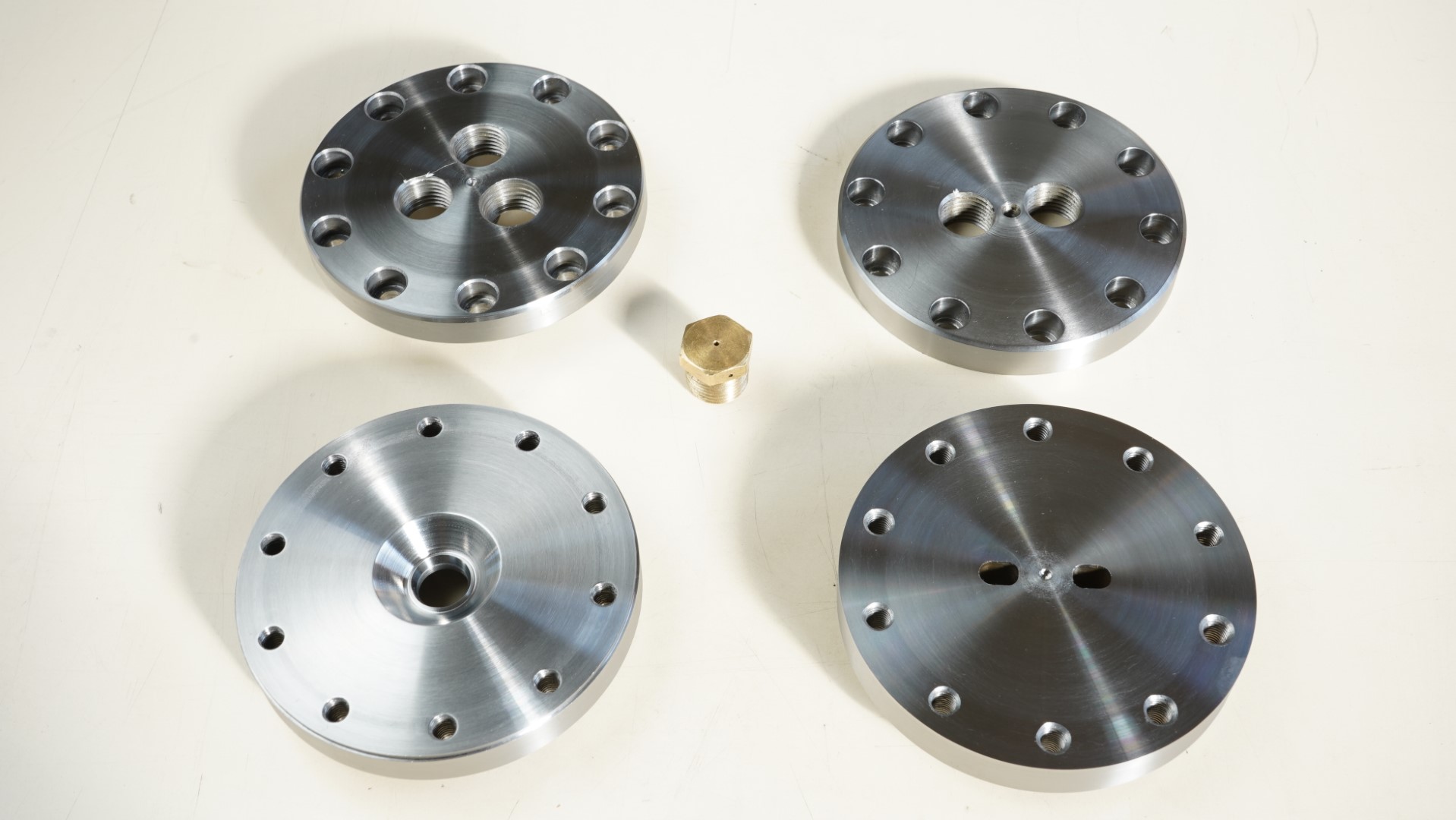

Brief
Filament die(s), for 30mm extrusion
Status
: not tested
Remarks / details
uses Filastruder filter nozzle - NPT taper thread
60 mm connector with BSPT 1 1/4 thread
60 mm heatband
Dual - Die

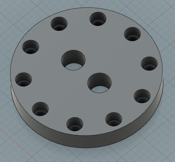

Dual - Dia - Mount
CAD/CAM
Completed
back
1918×1080 193 KB
perspective
1918×1080 184 KB
top
1918×1080 194 KB
